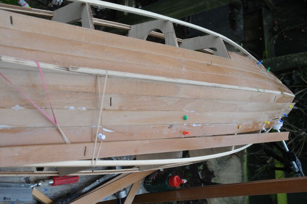

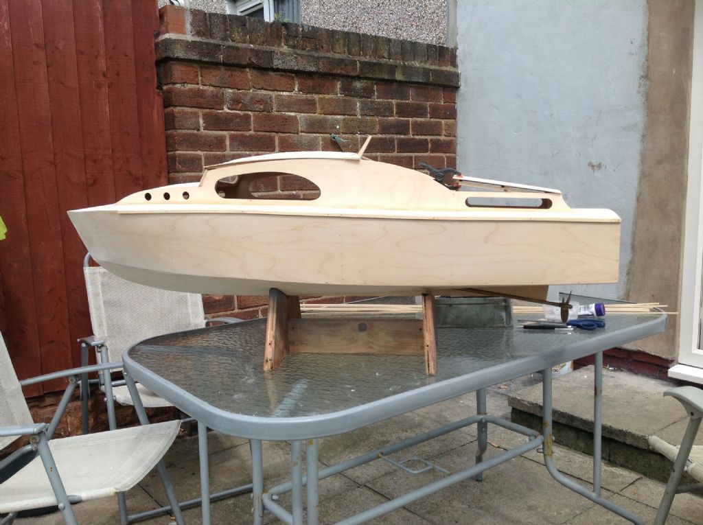

                                                  #39616
                                                  Alun
                                                    @alun
                                                    Hello all have been busy with work and family duties so have not been able to get on here for a while, any way the new sea queen is coming along nicely know ,I have had a few small problems fitting the first two hull skins but after a bit of sanding and fettling have got them into position and am just in the process of fitting the upper two skins of the hull which look straight forward (hope I have not jinxed myself ) . When I workout how to put pics up with the post I will be able to show you all my hard work lol ,we'll back to school runs and work happy sailing / motoring .
                                                    alun
