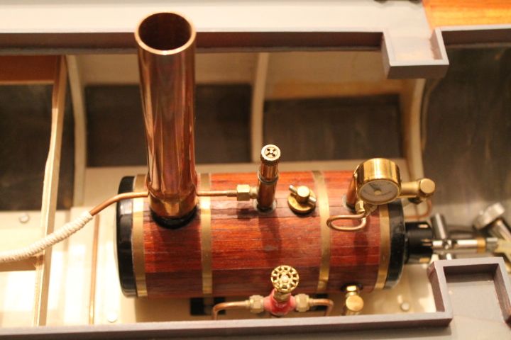

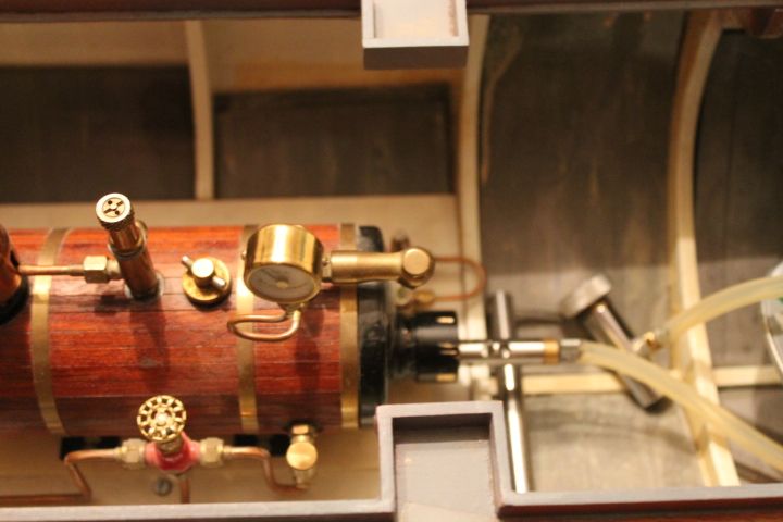

      I have inherited a steam tug but don't know how to fire up the boiler. The model and engine is about 10 years old and as far as i know has not been on the water. I have attache a couple of photo's and hope somebody can help.

          Hello Alan
          Your first requirement is to get the boiler pressure tested
          Don't even think of firing up!

            Hello Alan
            I wholeheartedly endorse Bob's remark. If you try to find a model club, or better still, a model engineering society there is bound to be steam enthusiasts who can supply you with a great deal of knowhow and safety proceedures.
            Safety Valves, Blowdown valves and sight glasses are only the first of things to be checked, after being layed up unused for a long time.
            Looks like a nice boiler by the way
