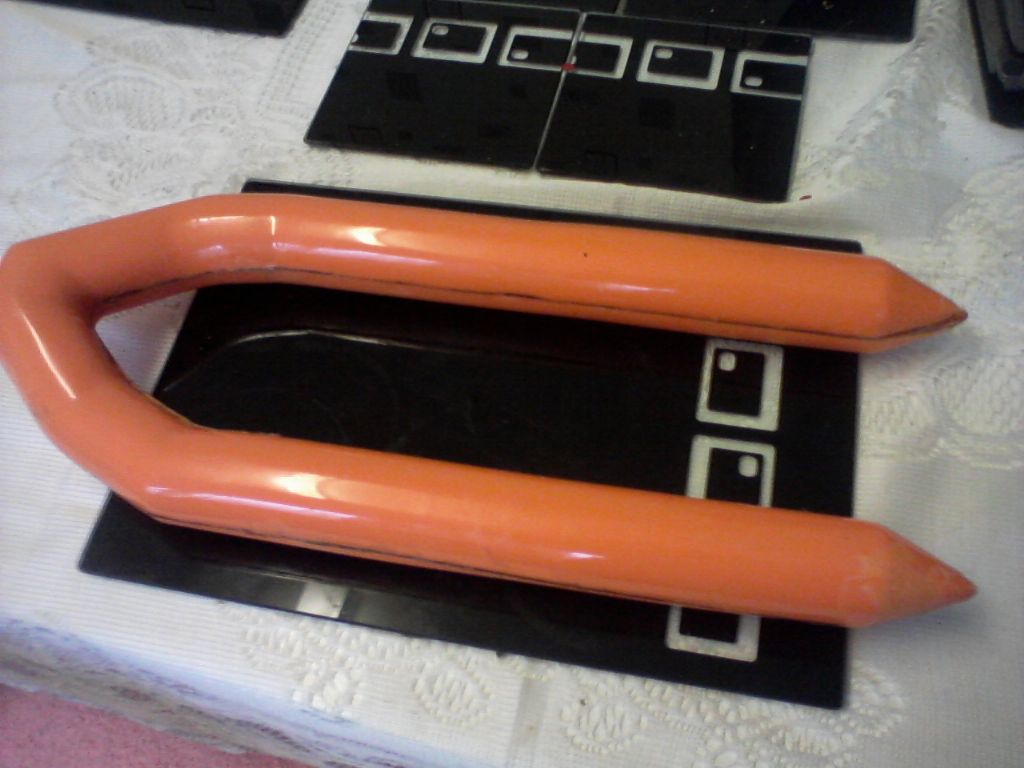

      1st the sponsons cut out and glued

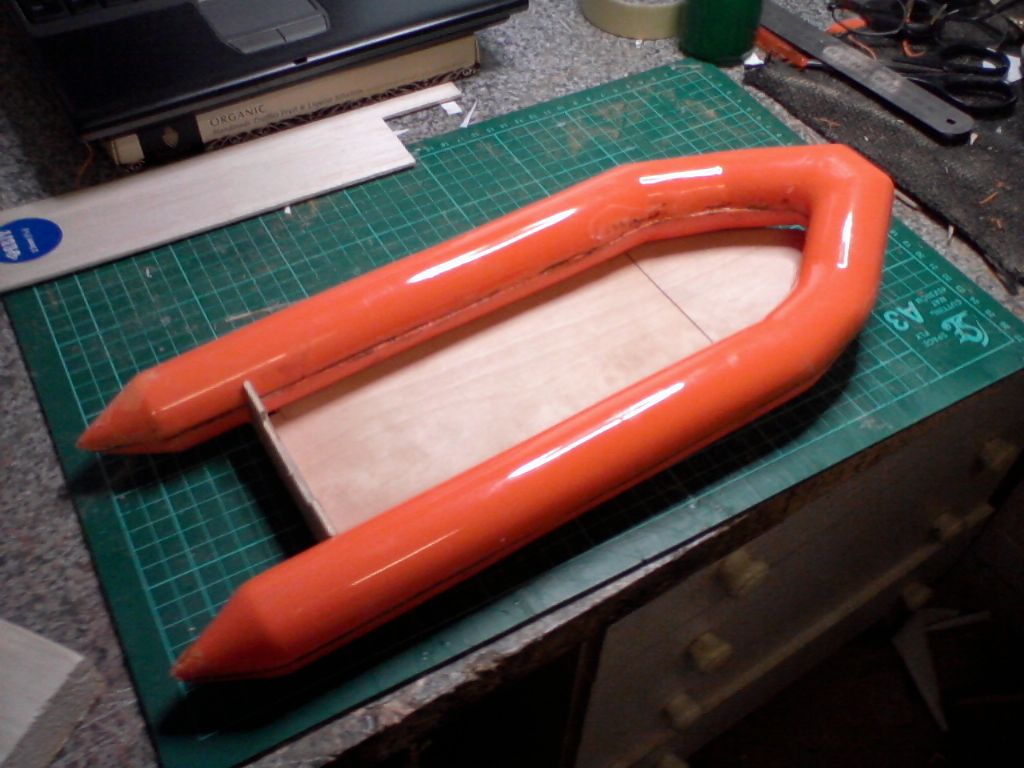

      then the hull bottom and inner sub deck fitted

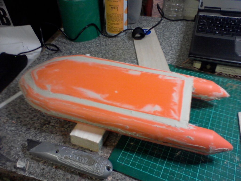

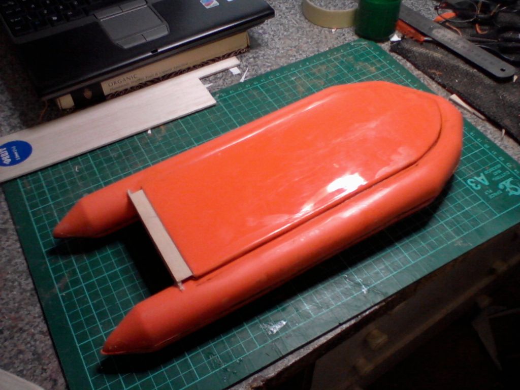

      and then the filler to smooth the joints out

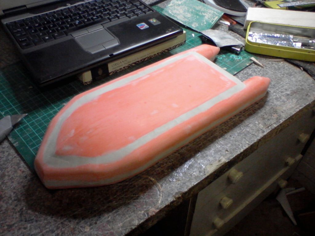

      and all rubbed down
      Now she needs a little more filler (fine grade) and then its all the belting and patches etc and the f’rwd locker and spray sheet before a coat of paint.

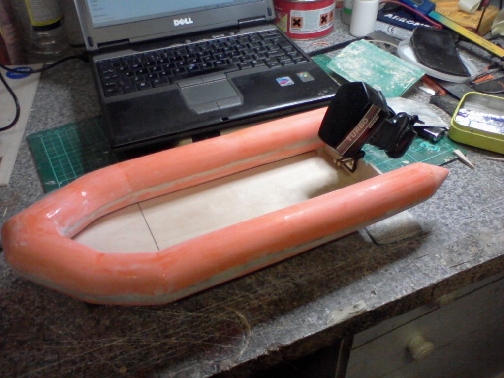

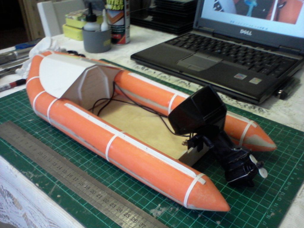

                                just a little more progress so far today the pic says it all really apart from the fact that the prop has been changed as the original was overloading the motor. this mod has increased thrust and reduced current draw
                                Phil

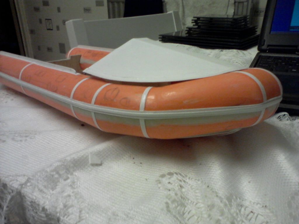

                                      another bit done this afternoon the longitudinal side belting this is from the pictures I’ve got a very prominent feature and hopefully once its painted it will look reasonably realistic

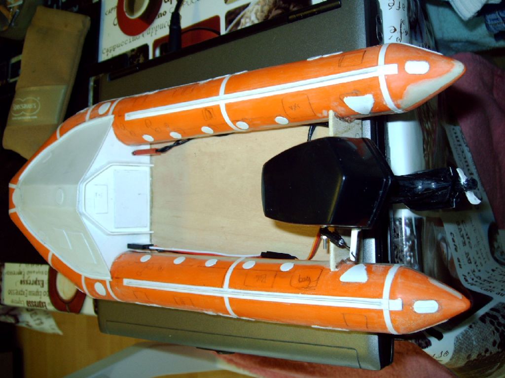

                                        It’s taken me nearly 3 weeks but finally she’s close to being painted. just the rings for the grab lines to fit and its of to halfords for some VW brilliant orange.
                                        The steering is affected by a servo hidden in the top of the outboard and all the control electronics (including an esc thats not as big as a pound coin) are hidden with a diminutive 2s1p 800mah lipo in the stowage locker.

                                            Thanks Bob the orange is indeed about right but the horizontal rubbing strip, the internal floor, the patches that secure the grab lines and internal fuel tanks, and the lifting handles, should be black.
                                            the stripes around the sponsons are supposed to be orange the same as the main part of the boat and have been added prior to painting to give the relief affect that is present on the real thing.
                                            The spray sheet over the stowage locker should be orange and the door of said locker black. the oblong above that door is the radio. there is a pic of the real thing in my album of this build but the site won’t let me show it in the posts for some reason.
