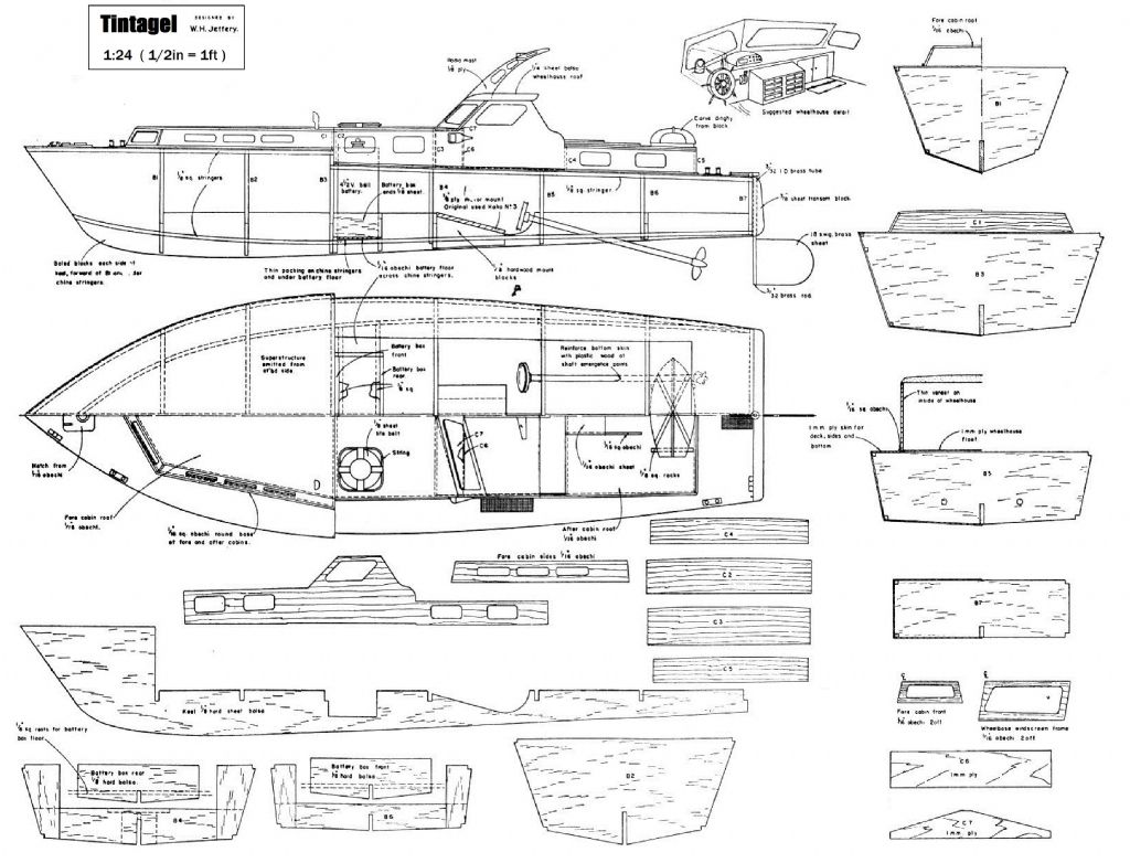

                                AN, There is no firm plan as yet other than the model will be a scratch built ( or hack built in my case ! ) and based on MV Tintagel. As yet I haved not settled on overall size for the model but it is looking like it will be around 34" long with a beam of 11.25". As far as displacement, is concerned, I won't have a clue until it's built unless there is a way I can work it out.$(kgrhqjhjfuff-hvsrfobrhmdezjt!~~60_57.jpg$t2ec16fhjike9qu3imotbrhmdeojiq~~60_57.jpgmain plan.jpg
