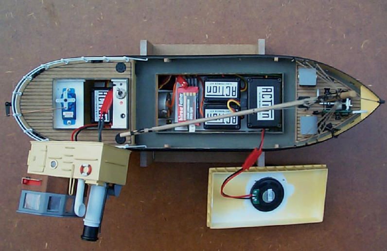

                        I would not use 6 cells in this model. That's 7.2v nominal (or as much as 9v fully charged) and will almost certainly blow up your receiver, speed controller, servo, main drive motor and pretty much anything else connected to it. You need just four AA cells (4.8v) mounted 2 x 2 along the bottom of the hull under the hatch. The prototype Puffer was fitted with all ACTion gear, because I designed it for the late Craig Talbot to show off his (then) new micro-sized speed controller, engine sound unit and dual switcher.
                        The picture shows my prototype fitted with P68A ESC, P64A Puffer Steam Engine Sound with 35mm flat speaker, 2 x P69 Switchers (smoke, whistle and lights) and Hitec HS55 servo for steering. A Hitec 40MHz "Feather" Rx was used and the whole lot powered by four 1600 mAh AA NiMH cells. The electronics fitted onto a styrene platform with the battery pack directly underneath. No extra ballast was required.
