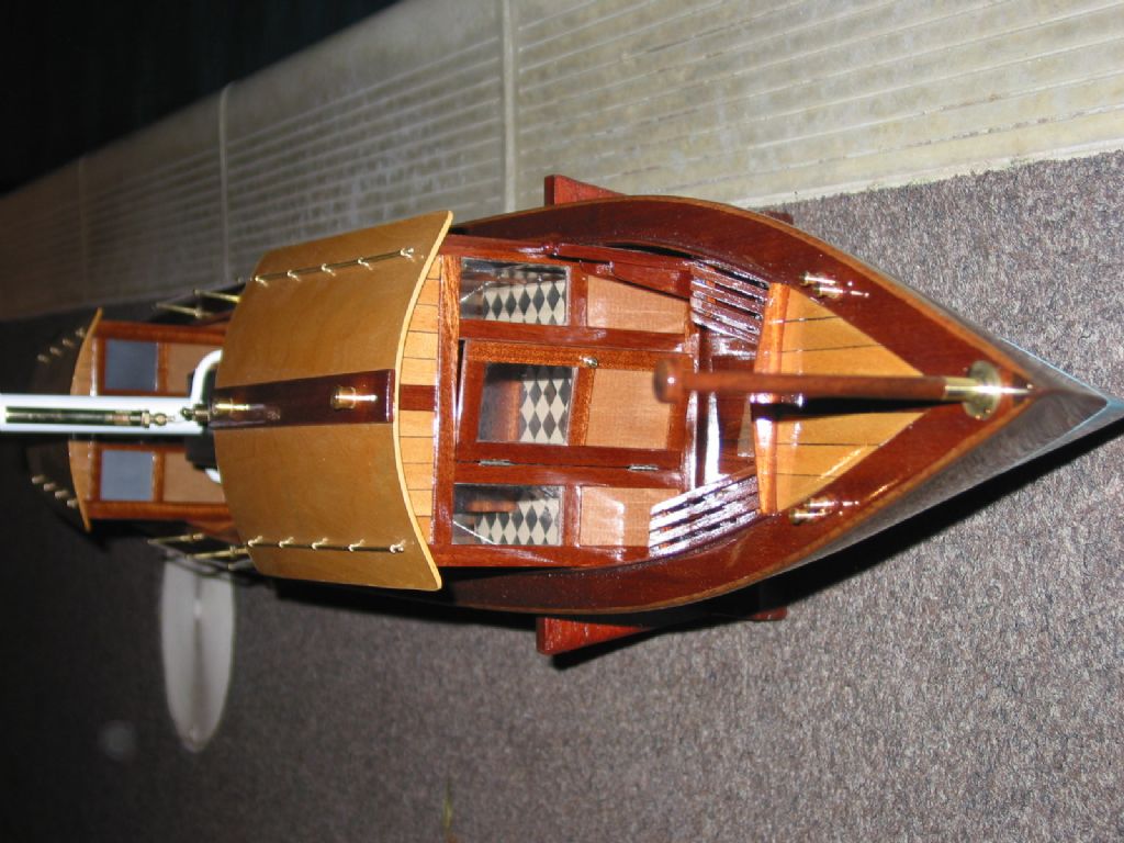

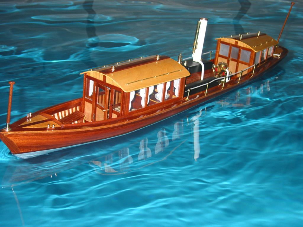

      Hi,
      Just thought you might like to see the steam launch i have just completed.She is an Edwardian Thames launch “Miranda” drawn by Basil Harley.
      I have installed an Anton Cristal steam engine and boiler. Only this morning ran it in a test tank on the Patio,ran perfectly straight away.
      Alan Nash.

          Hi Alan,
          The boat looks great.
          Can you show or send details of the remaining parts of the installation, radio, valves etc.
          What throttle valve did you use?
          Brian

            Come on Alan, more information and pictures wanted…..

              Dang, I have to dry off another keyboard. That looks fantastic. More photos please.
              Regards,
              Gerald

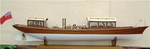

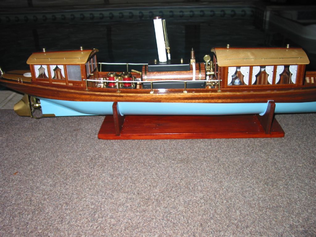

                          Hi Adrian
                          Forgot to add some Pics
