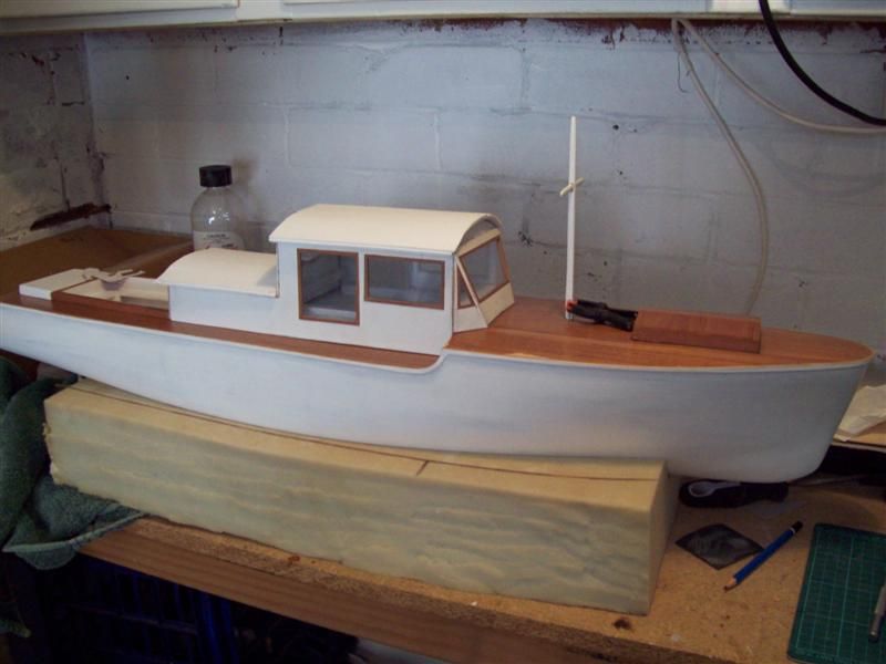

      Matilda is still in the building stage.
      The rudder controls are sorted out, the prop shafts and motors are sorted out, the battery tray is sorted out, the electronic  (semi)  waterproof container is just about sorted out, the cabin and aft cockpit are almost sorted out, and  I’ve put 2 coats of finish enamel onto the hull.
       I’m sorry that the people in the UK are freezing tour b***s off, but today it was about 29degC and about 90% humidity. Not a good time to spray paint!!

        #24960
          Great shape to that hull. Are you having the boat populated with sailors of one description or another??

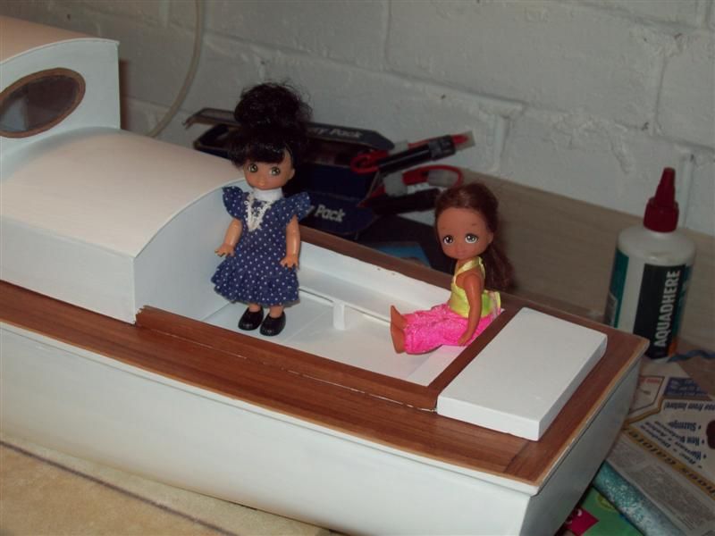

            I intend to.
            It’s just that I get funny looks when I’m in a toy shop, looking at the dolls,

              I recruited the crew today, press-ganged from the Salvation Army shop. I think the dark haired one could undergo a sex change operation and be promoted to Captain.

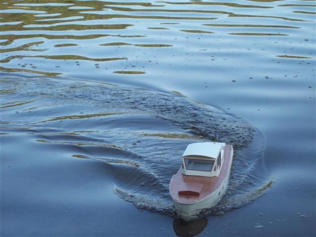

                At last Matilda has hit the water!
                Unfortunatly the a fuse kept blowing, I,ve ordered smaller props from George Saitek, they are due anyday now.
                Still things to be done, (that nasty 4 letter word …..work…… gets in the way!)
                This photo is about half power, 1 motor going.

                  Well done Michael- she looks great. Would be nice to know a little more about the design (where you got it!) and more pics when you have things sorted out to your satisfaction.

                        I took her out for another run this morning, with smaller props, and she sails just as a gentlemans motor-cruiser should!!!
                          A few issues with the batteries, etc, nothing that can, be cured.
                        I’m HAPPY!!!!!
                        Takes a bit of water over the foredeck, and aft cockpit area,  when she hits her own wake though, might upset the blondie sitting with her G&T down near the stern

                            Nol, I re-scaled it to 820mm, so that it fits into the boot of the car.
                            Sailing weight is 4.5kg,
                            Two 540 type motors, 25mm props, gives it a top speed of a bit over scale speed by the look of it.
