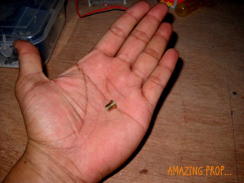

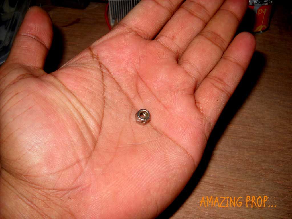

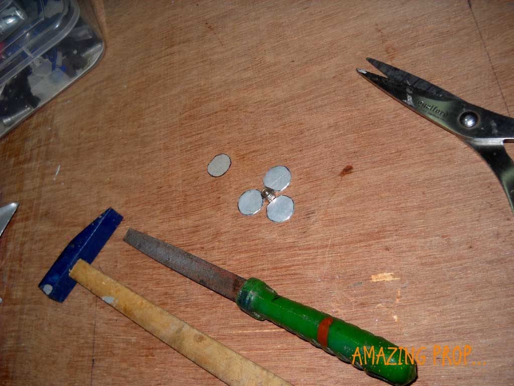

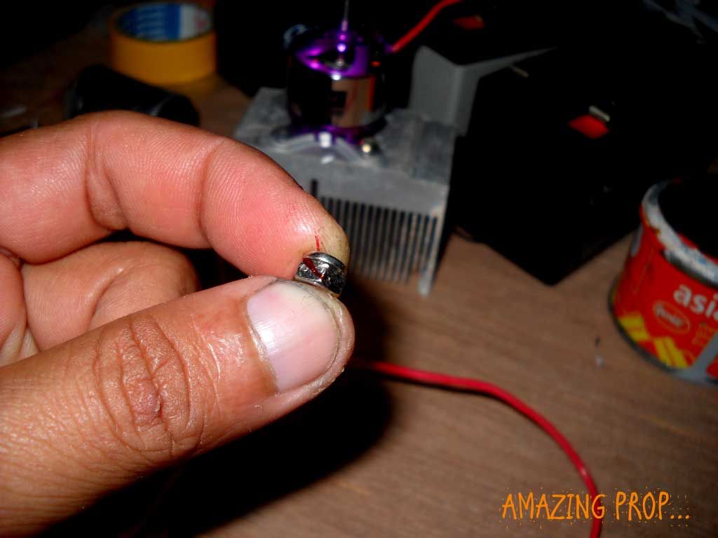

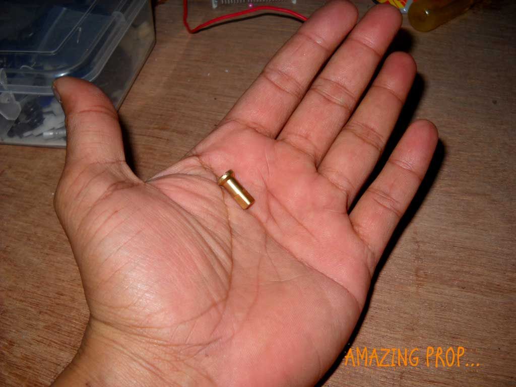

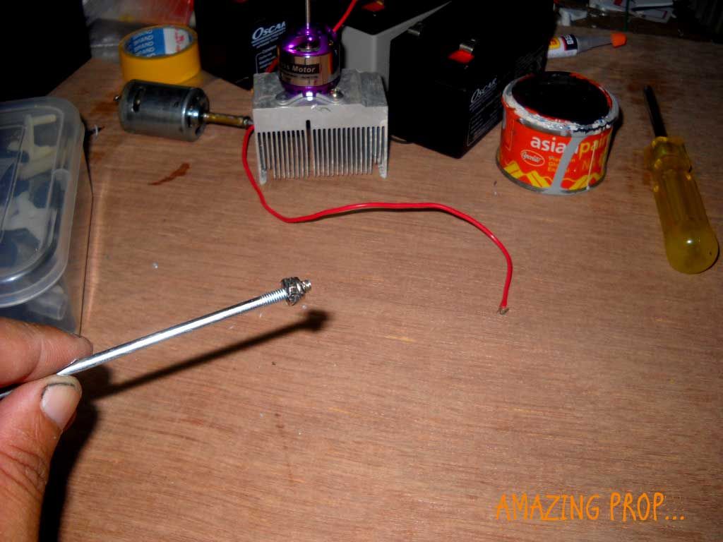

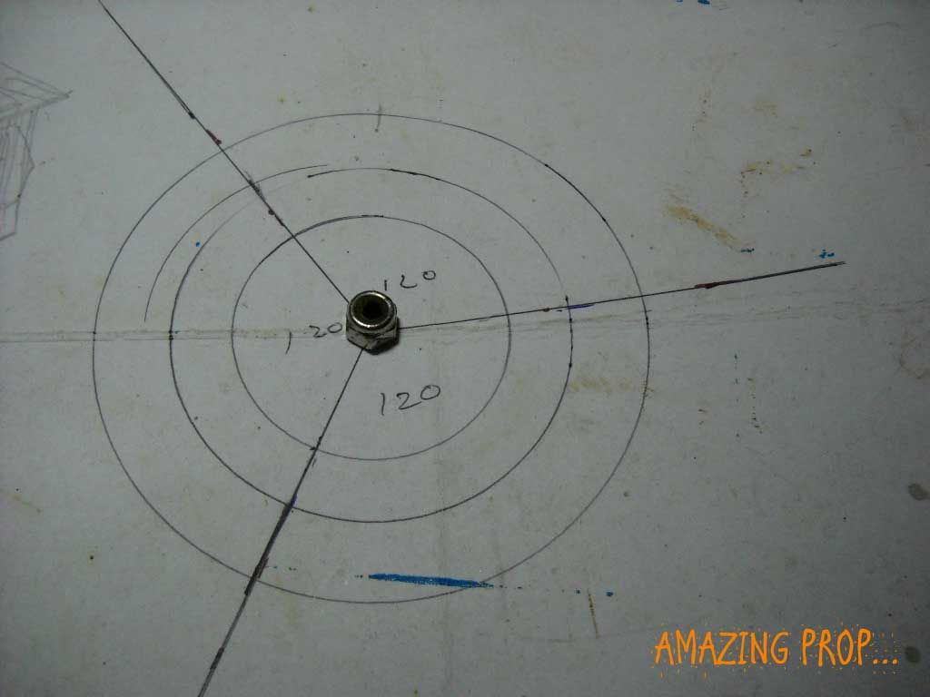

      Friends..i was purchasing scaled props for my crafts, and most of the time, it became unsuitable for my crafts..adjusting the motor and performance of a craft, to a ready made prop was just like shaping my feet to a newly purchased shoes..and as a remedy, i was making props from aluminum vessel lids, in to three blades..and one day after some of my hard modeling works, i was spending some time in free in my work room..so, suddenly i noticed one thing about a tiny nut..the nut was 6 sided, and each sides were in perfectly at 120 degree..cool..its the time to make a prop with it…
      you can see the tiny nut..this nut is actually a spare nut of an IC engine muffler..
      and can examine each poles..all 120 degree perfect…

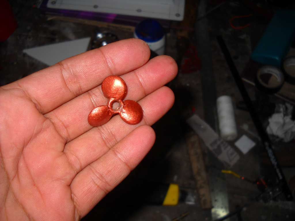

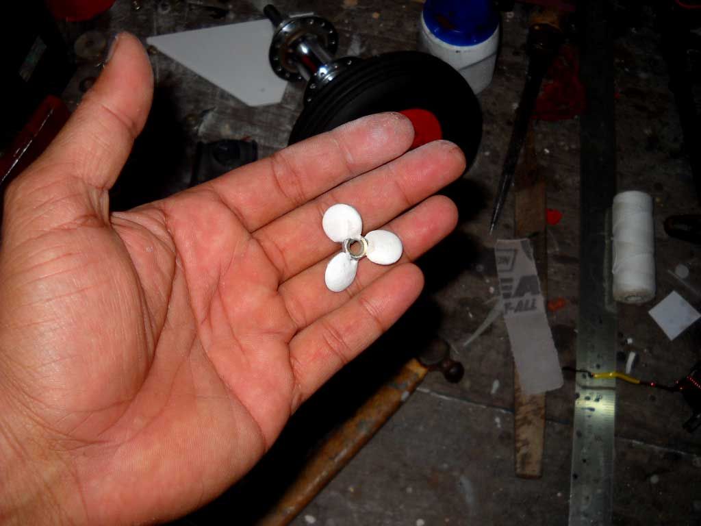

        scratch built propellers..

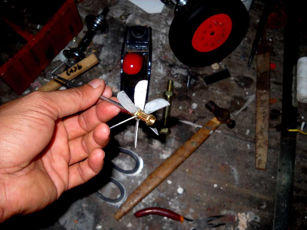

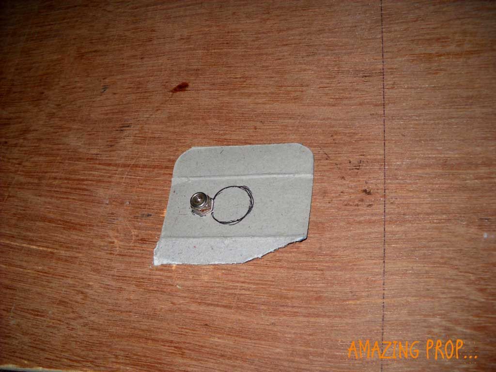

          so i made three grooves on the sides of the nut, and made three blades..this was a test…
          #32946
          aquaplaner
            @aquaplaner

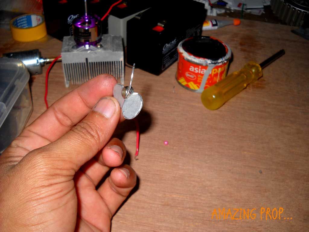

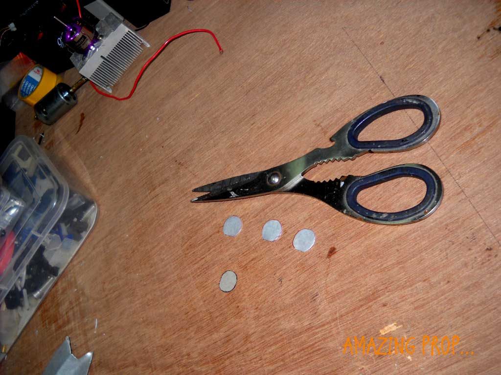

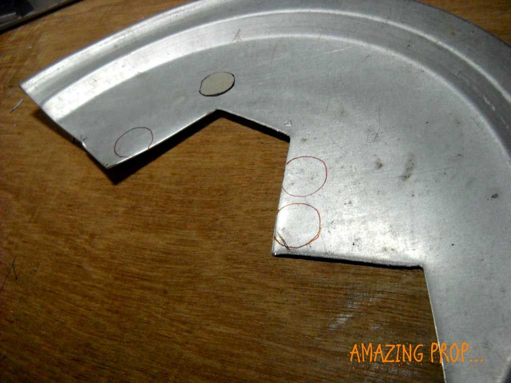

            the leaves were sliced from an aluminum lid..
            with meat cutting scissors..

              after making three leaves..checkouts..
              #32948

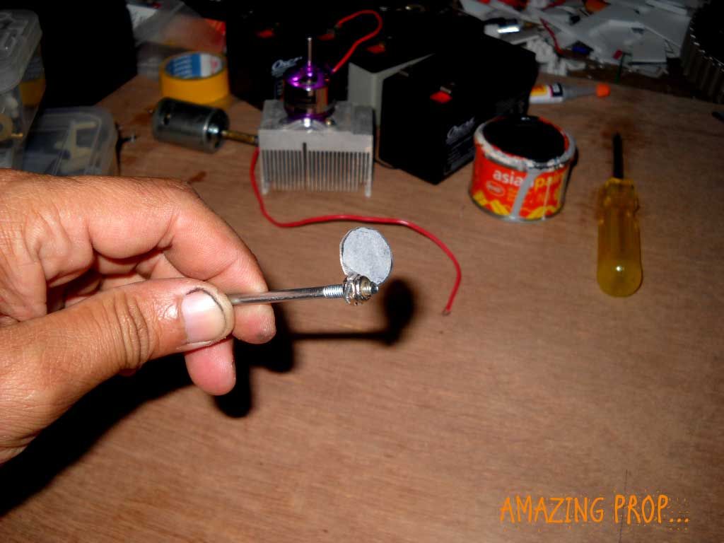

                so now time to realize..took a thick bicycle spoke..
                and sliced one of the nipple at half..and threaded in…
                #32949
                aquaplaner
                  @aquaplaner
                  and tighted the nut on to it…

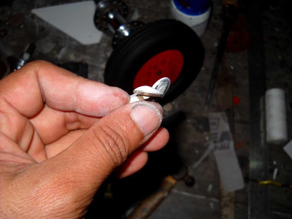

                  and started to fix the blades..all with industrial cyano glue..remember..an ordinary domestic glue not be good one..
                  #32950
                  aquaplaner
                    @aquaplaner
                    make suring all blades are in perfect angle..wait untill dry…

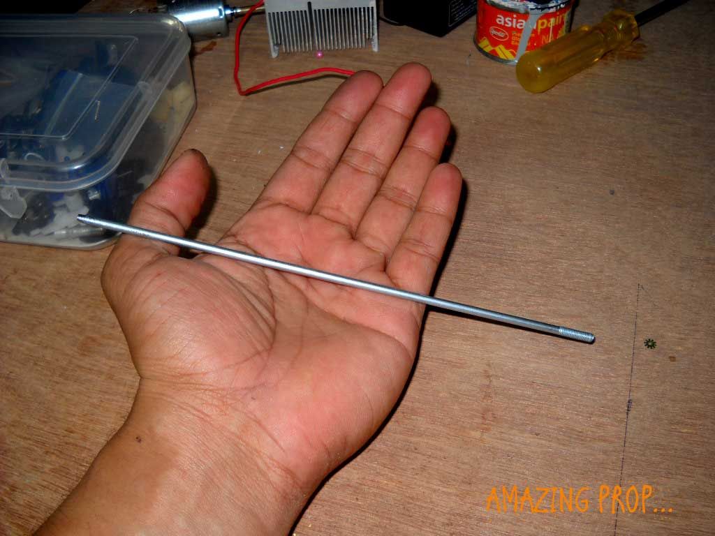

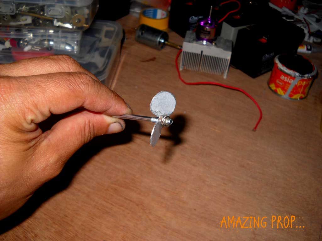

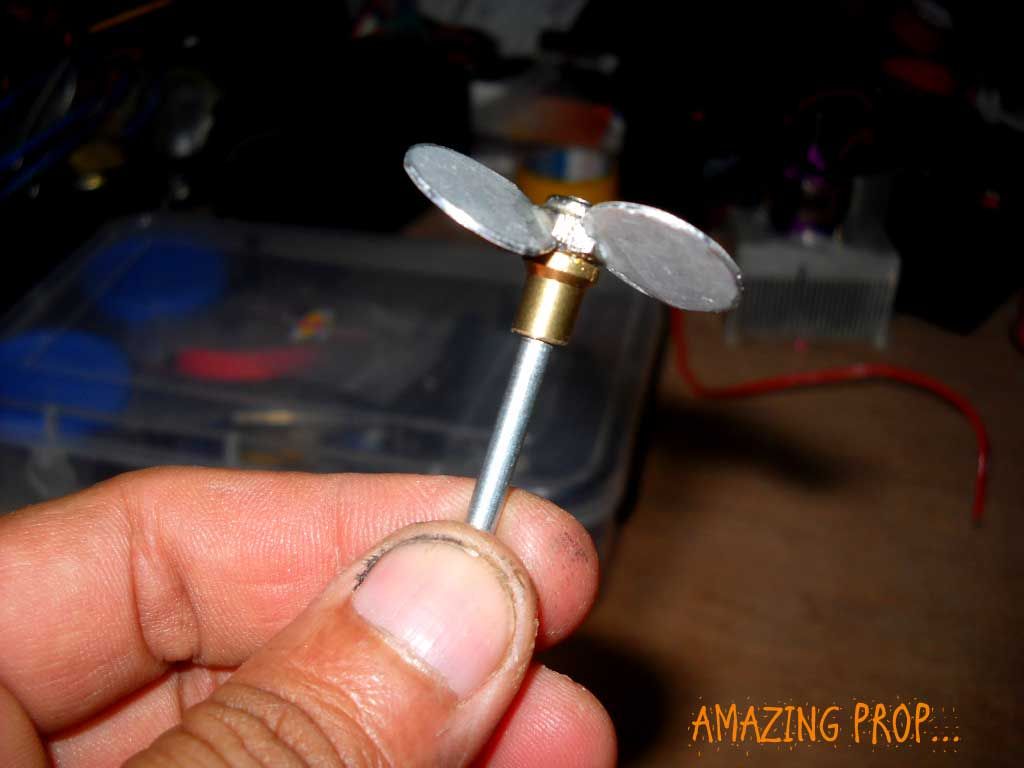

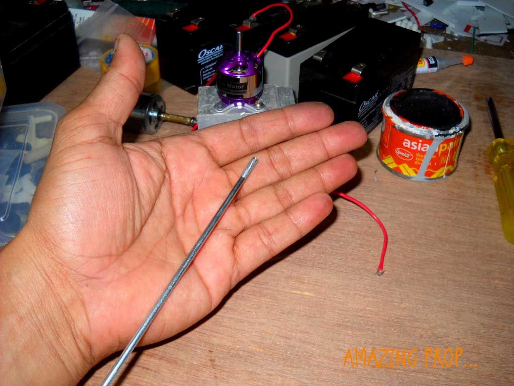

                      now prop set aside for setting the glue..now time to make a prop shaft..
                      cut the same bicycle spoke in needed length, leaving the thread side intact..
                      take two nipples and slice one at half…

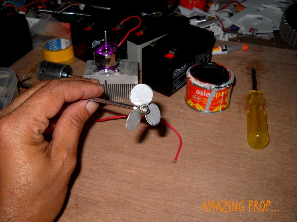

                      #32952
                      aquaplaner
                        @aquaplaner
                        now thread it tight..on shaft…

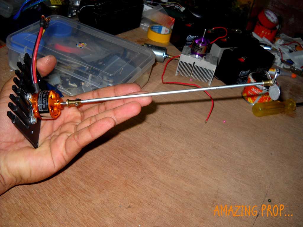

                        and fix it on motor shaft..
                        #32953
                        aquaplaner
                          @aquaplaner
                          so after checking..paint it..

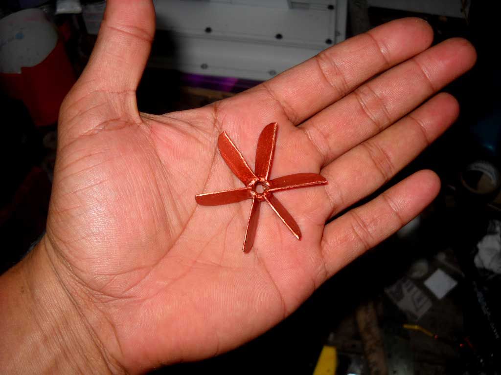

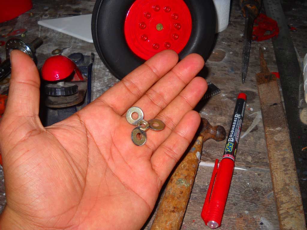

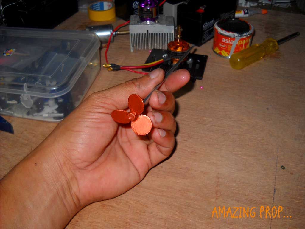

                            Friends..i was shocked with the performance of this prop..so it was only a begining..for more research..so later i added some more good features on this same task…
                            so next i tried with even more big nuts and plated washers…

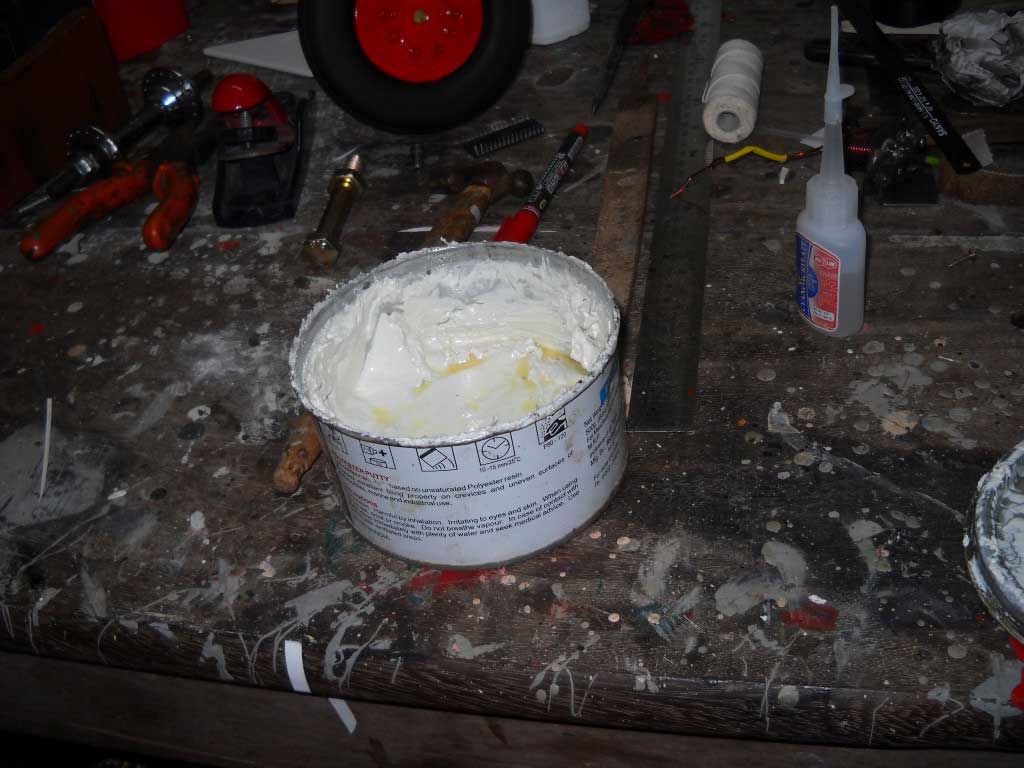

                            after fixing the blades..i used to build the aerofoil like section on blades, by PU putty…

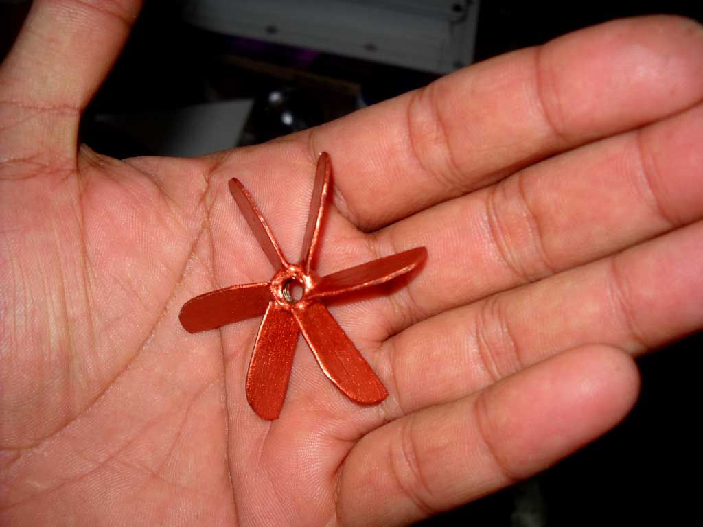

                            #32955
                            aquaplaner
                              @aquaplaner
                              can see the putty shaped..
                              and can see the aerofoil shape..it gives us even more thrust even at low revs..with less motor power…

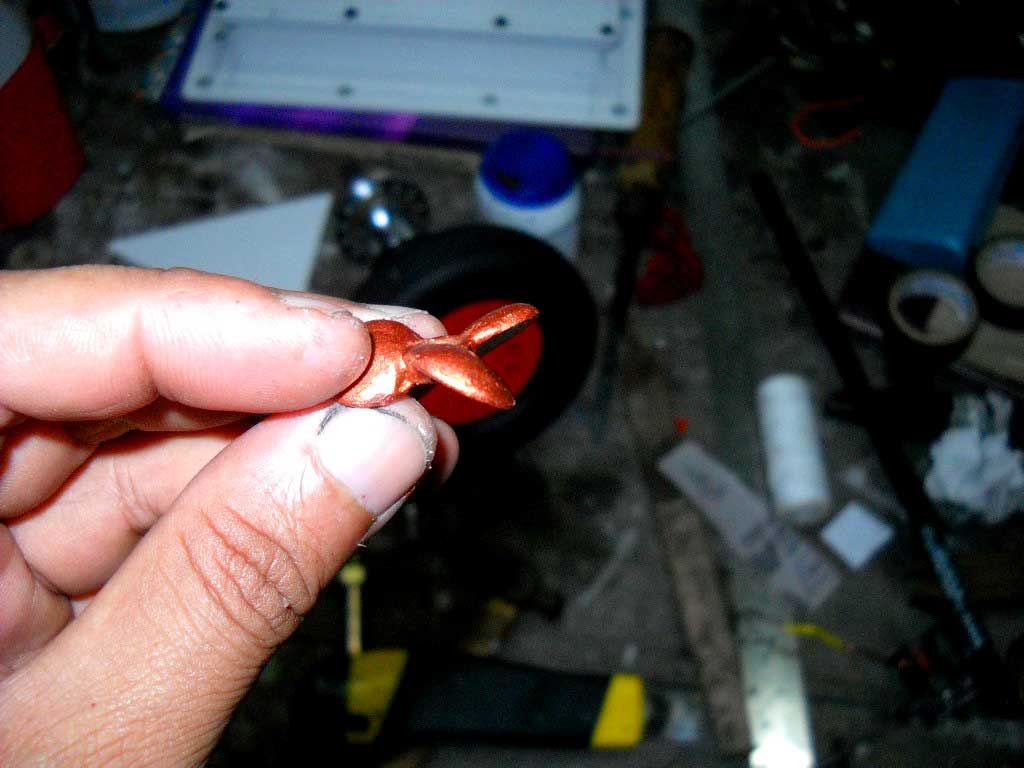

                                after drying..paint it…
                                #32957
                                aquaplaner
                                  @aquaplaner
                                  and as proved as sucessful..tried with big..this one is made for my submarine..with more blades..slow running..but with immense thrust…
