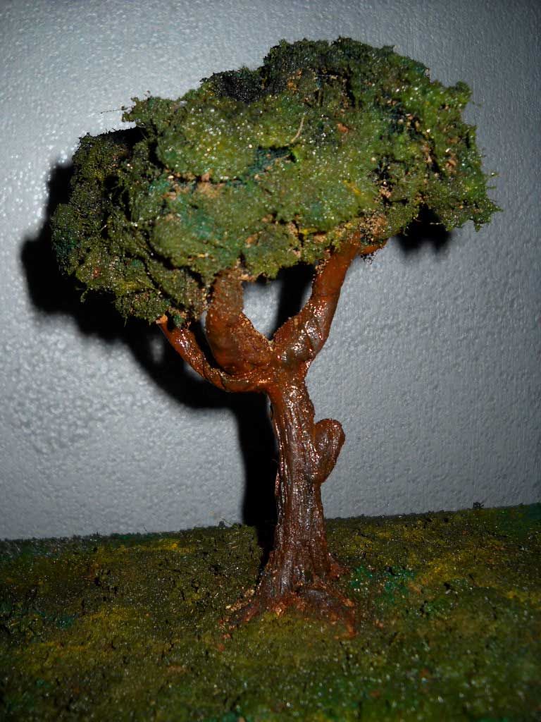

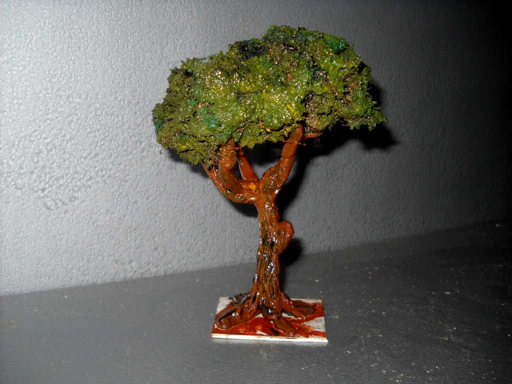

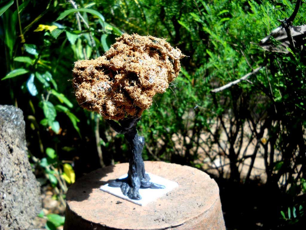

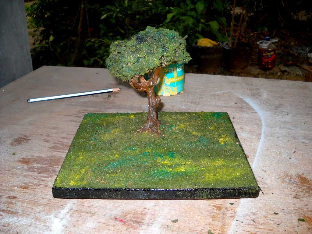

this is my “Tree of Hope” to this new year..pray that this tree may bring prosperity to you all this year..

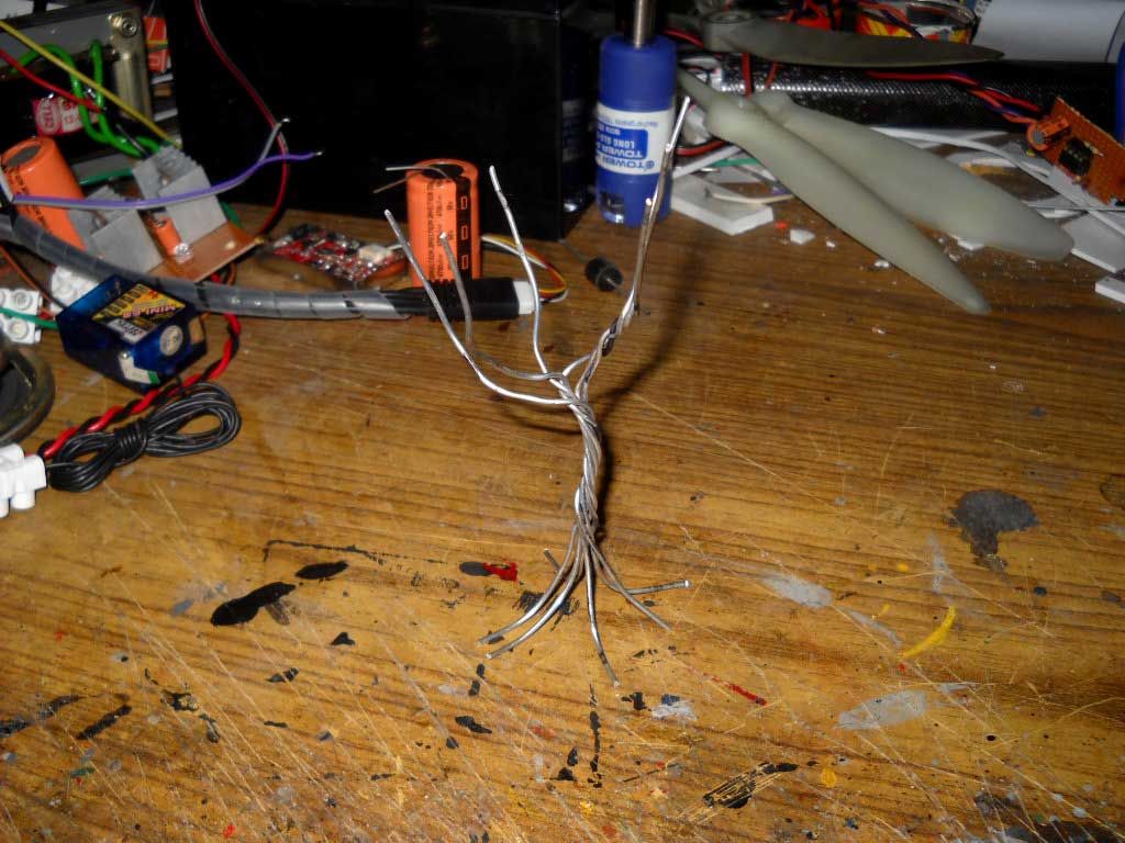

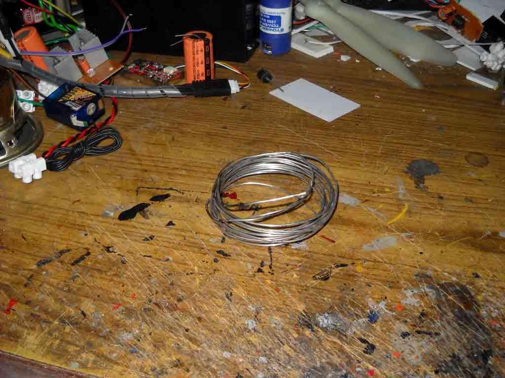

collect some aluminum ,copper, or stainless steel , or brass wires in to 1 or 2mm thickness..please avoid to take metal or ms wires as they tend to rust..
