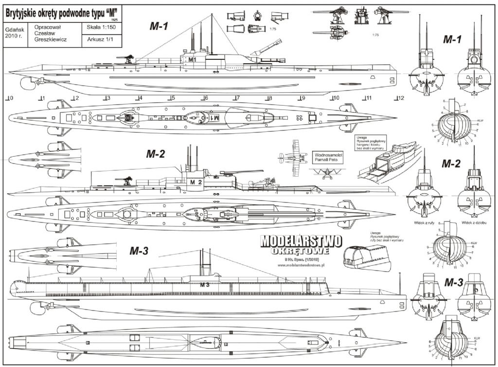

                      Anyway, I just typed M1 into Google images and this came up!type-m-british-submarines-m1--m-2-m-3-de-1925.jpg
                      Job sorted! Got all mi datums' and hull lines. What I do is copy the drawing onto a piece of A4 acetate. Stick it on mi over head projector and you can then trace it at any size you want, A0 whatever. The only trick is to keep everything dead square so there is no distortion. It's mi £20 version of Solid Works!
