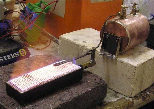

                  Seems there is a bit of interest in LPG and burning performance. I have seen and photographed a ceramic burner with a stainless steel vaporiser using neat gas form a tank. I have included the picture for anyone who is interested.
                  http://www.modelboats.co.uk/wp-content/uploads/sites/5/images/member_albums/2660/Burner.jpg
                  As can be seen the vaporiser is the stainless pipe which sits over the ceramic and heats the liquid fuel before it passes throught the jet.
                  Any comment?
                  I have also had a letter from Mr Martin Ranson who has written in the Model Boats Mag about using a ‘heat shunt’ to warm the fuel tank and this also reduces the tendency for the tank to cool and thus reduce performance. He has apparently used it for many years quite successfully.
                  All the best, Fred Graham
                  #13868
                  Fred Graham 1
                    @fredgraham1
                    Hi again folks,
                    Just noticed a typographical. Where it says ‘neat gas form the tank’ it should say  ‘neat liquid from the tank’. My apologies as clearly there is no need to vaporise gas, only liquid.
                    Best wishes, Fred Graham
                    #13869
                      Hi Fred
                      I recognise the burner as being from a domestic mobile gas fire and would agree that this burner would provide quite a good level of heat over a large area.
                      My worries would be how quickly the burner would get through a small gas supply as would be carried on an average model boat but I would be more worried over a pressure build up between the vapouriser and storage tank, I personally would install a safety blow off valve to give me piece of mind.
                      Nice copper work though.
                      #13877
                      Len Ochiltree
                        @lenochiltree67043
                        How is the Fosters linked in?
                        #13883
                        Fred Graham 1
                          @fredgraham1
                          Hi Len,
                          What is a Foster?
                          #13886
                          Fred Graham 1
                            @fredgraham1
                            HI Len,
                            Doh, Just realised you are referring to the ash tray.

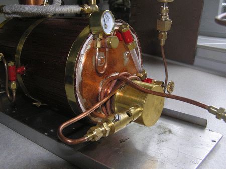

                                  http://www.modelboats.co.uk/wp-content/uploads/sites/5/images/member_albums/2660/Boiler_condensed.gif
                                  Hi Folks,
                                  The above is a photo showing the vaporising coil which I use to utilise liquid fuel. The burner is lit using a tank which will supply gas from one valve and when the flue is hot ,another valve is opened to allow liquid fuel to pass through the vaporiser and it burns without flaring. The gas valve is closed and the fuel supplied relies on the internal tank pressure created by the gas inside to push the liquid fuel out of the tank. The can thus does not cool down which is one of the problems of using LPG. As suggested by Martin Ranson I have a pressure gauge in the supply line. This shows no change in pressure when the pipe line to the burner is changed over from gas to liquid and is typically 35-40 psi. The fuel tank was hydraulically tested to 340 psi.
                                  I hope this is of interest to other users of LPG , all the best , Fred Graham
                                  #14271
                                    Hi Fred
                                    A very nice set up,
