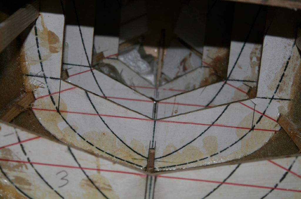

      Firstly, I found a load of bits of 5mm ply in a skip that I cut up into the frames and keel. The stringers were made from some scrap from a local window maker ( not upvc ones ). The frames and stringers were assembled along the lines of ELLIE to give me a nice skeleton.

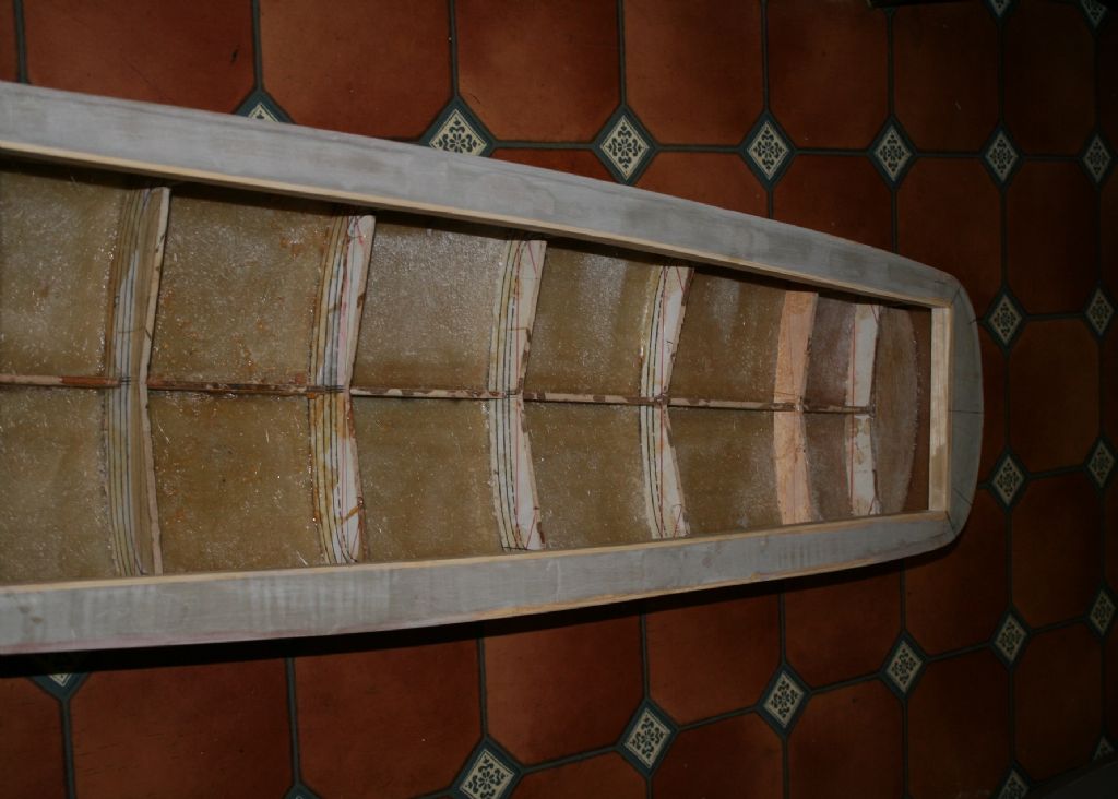

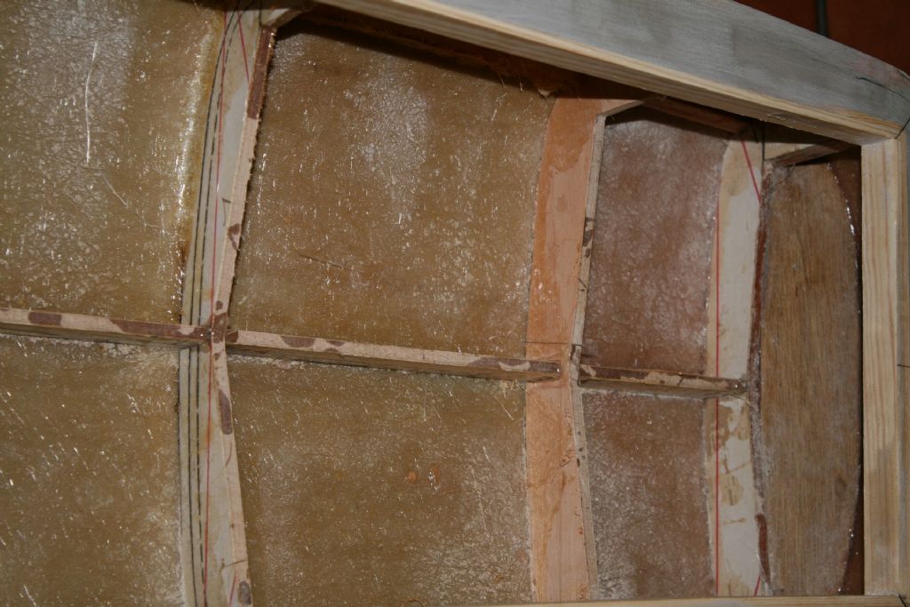

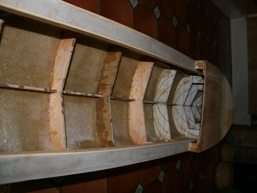

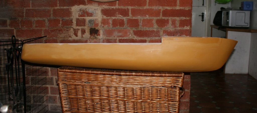

      In my room of rubbish, I dug out a load of woven glass roving that I cut into sections that I could stretch over the frames and secure with staples.
      Having covered the entire hull like a tissue covering on a plane, a liberal coat of reconstituted resin was applied and left to harden. Very little sagging occurred and it took only a small tin of Poundstretcher body filler to build it up and sand to a good shape. A few coats of primer and a bit of ply decking got me to my present stage.

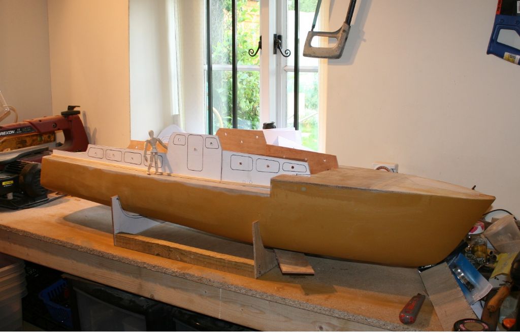

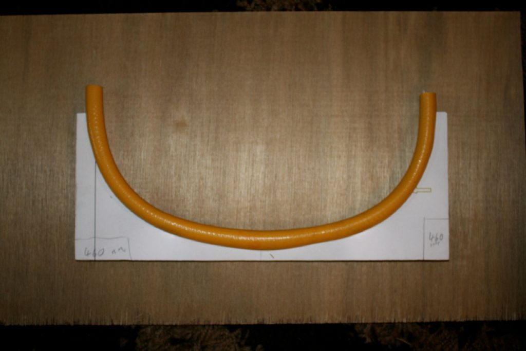

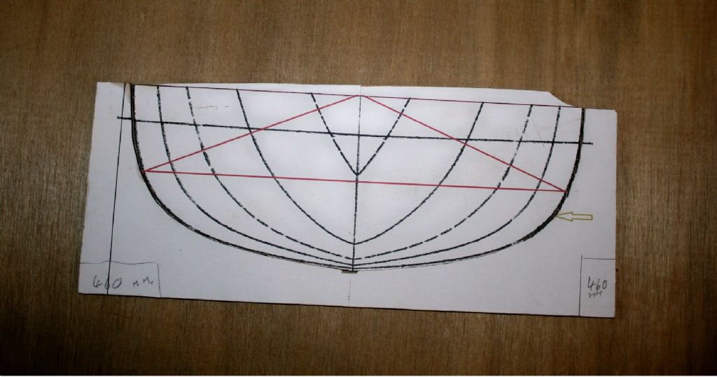

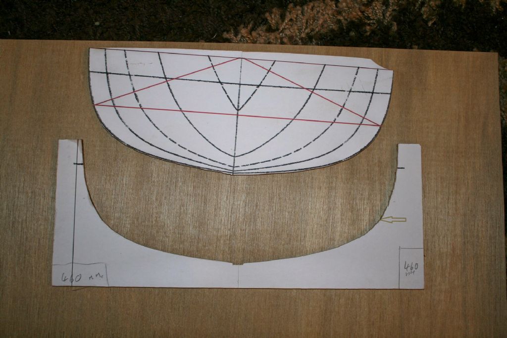

                I know I should have done this before ! I reached the stage where it is hard to keep the hull firm while I work on it so a stand has become a must.
                Simple job I hope, just print out the required frames and cut ! SIMPLES !
                Then split a bit of old hose, stuff it with filler and wedge onto edge of frame.
                Now for the other end and some stiffeners. ( large brandies always work for that )

                  Looks good so far. Nice smooth finish on the hull.

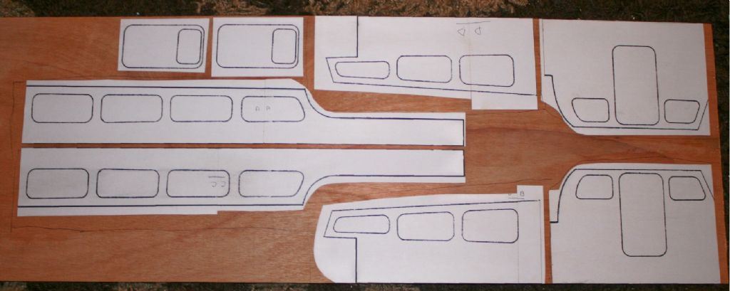

                      It's been a busy day at the pond today so I haven't done much in the workshop/kitchen.
                      All that happened was tidying up some of the scraps of ply that I found, printing out the cabin sides and sticking them to the ply ready for cutting out with the trusty hatchet !

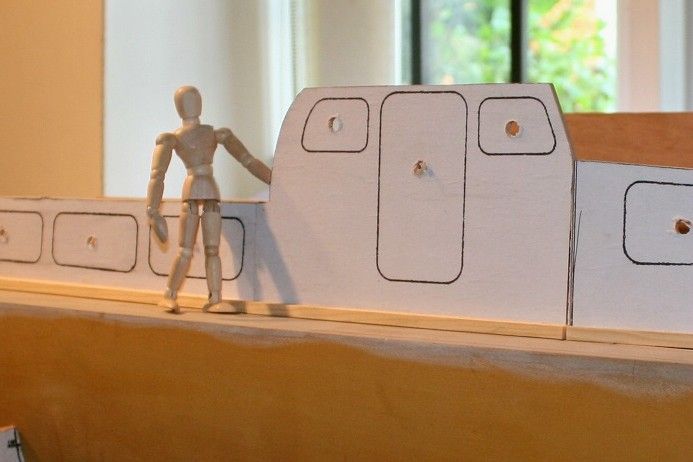

                            Is it me, or do the windows look a bit small ?
                            Perhaps I should make them the same size as the frames indecision

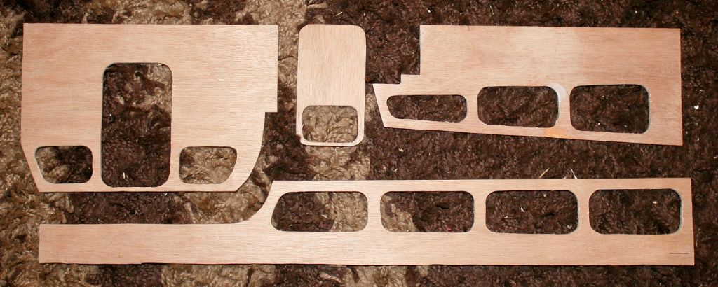

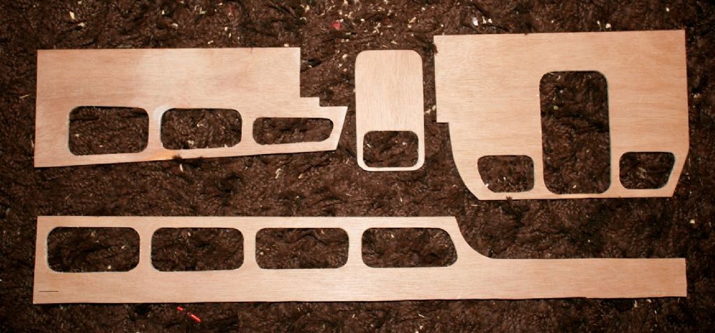

                                And so, many hours later and having sharpened the axe twice, here we have the cabin sides all cut out and ready to be fitted.

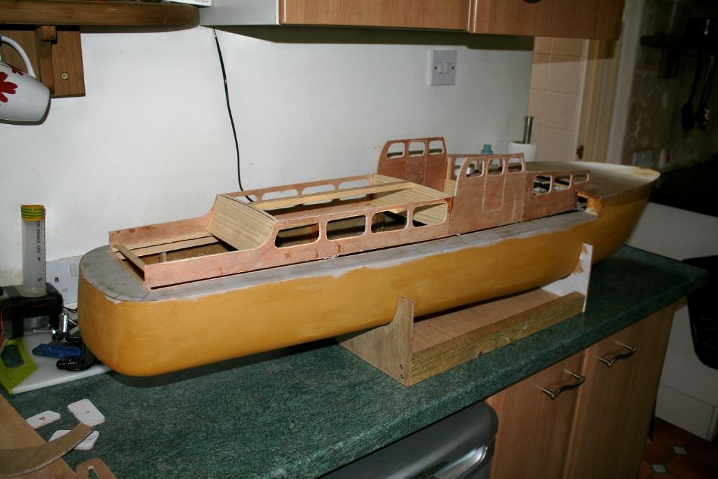

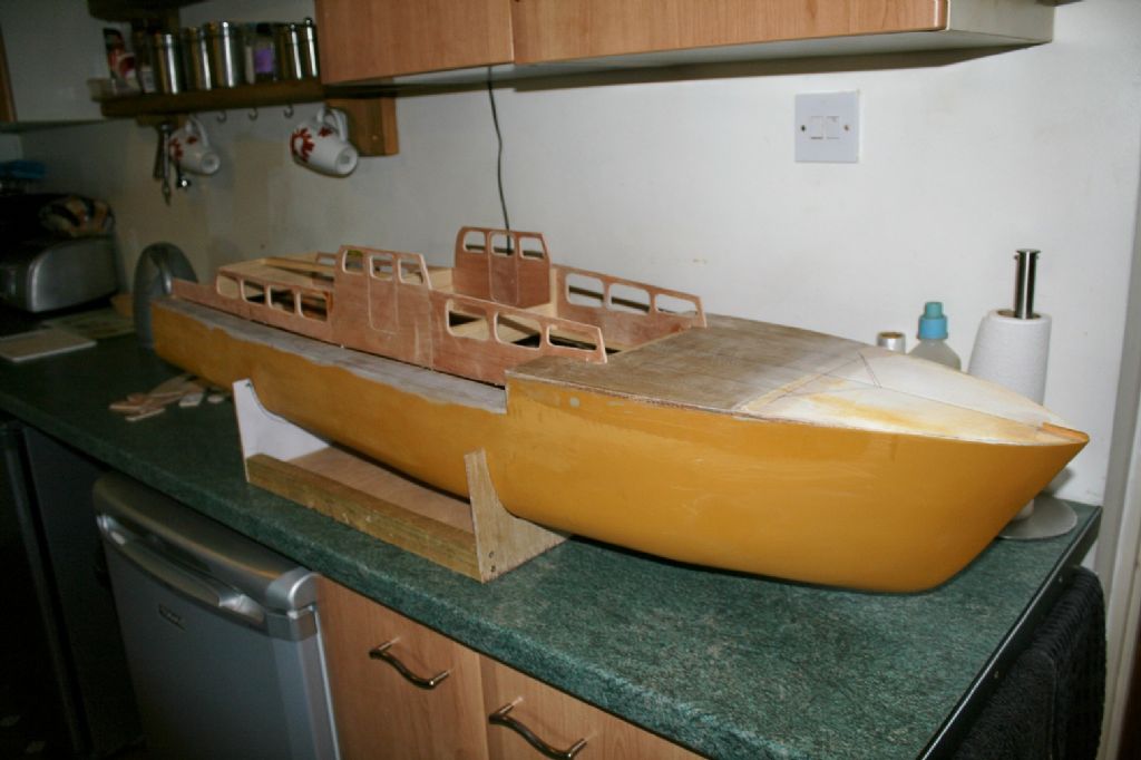

                                  Now it is starting to look like something is happening.
                                  I have started making up the cabin and will have to make a few adjustments to the deck as at the moment, it falls into the hull.
                                  I haven't a clue what to do about it but not to worry, I'll think of something.
                                  There's very little that a bit of polyfilla wont sort out !
                                  And maybe a few bits of 2 x 1  as well ( that's 25 x 50 for the younger viewers )

                                      Now I have a real problem !!!!
                                      There is nothing worse than a model boat scudding around with no-one on board, just a disaster waiting to happen !
                                      Dear Mr. Smeed drew his plans at 3/4" to 1ft and that is the size that I am ATTEMPTING to make however there seems to be a major problem here.
                                      Where oh where does one obtain 1?16 scale figures to crew the beast? OK, I could have no end of various soldiers on board, or even half naked fantasy maidens, but not a single NORMAL person has shown their face on the interweb no matter where I search, or even who with !
                                      Can any of the more knowledgeable chaps or chapesses on here point me in the right direction ? It would be a shame to have her moored up at the quay without a crew to take her for a spin.
