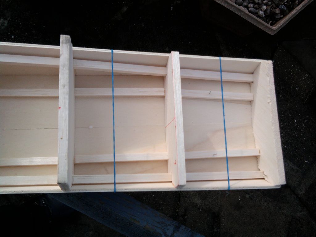

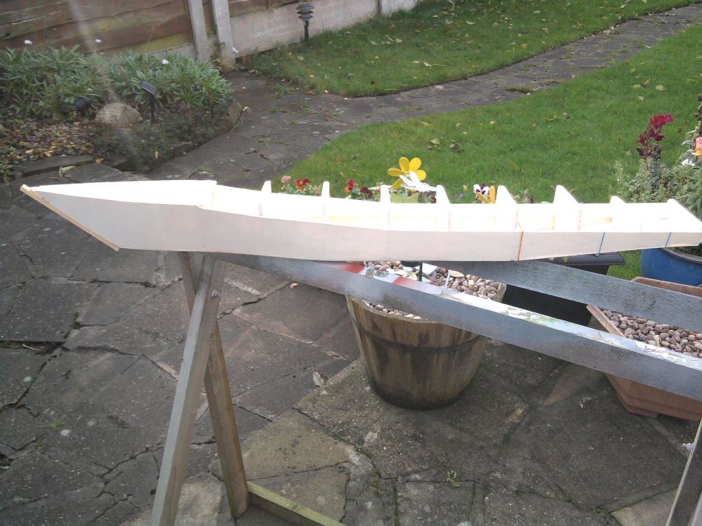

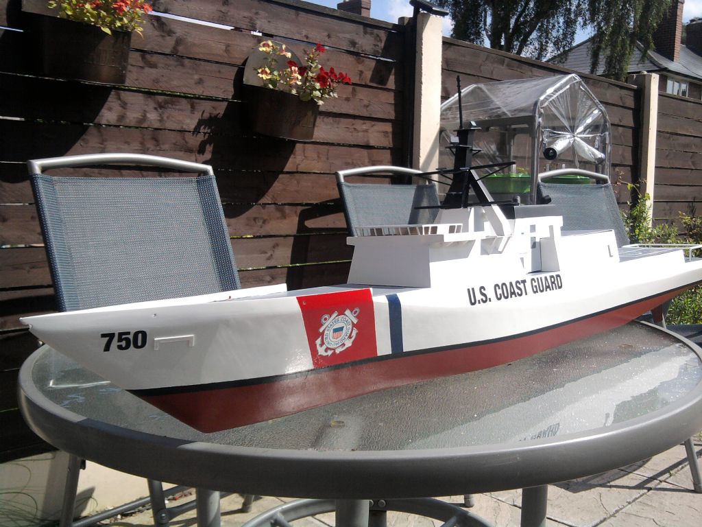

      After quite a while searching for plans for this class of ship on the internet, and after lengthy discussions at my club, i decided to try this from scratch with a bit of guess work.
      I have gone for a semi-scale hull design at 1/150th which makes her about 90cm from bow to stern.
      The bulkheads are made from 1/4 inch balsa and the hull from liteply, lots of wood glue and elastic bands are all that are needed!
      With the upper part of the hull and superstructure added she is begining to look ok?

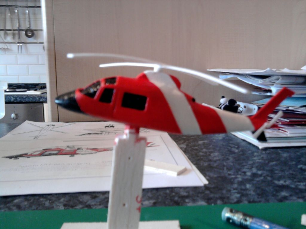

      I’ve even had a go at the MH-68A which she carries!
      Any feed back or suggestions or constructive criticism would be welcome.
      Gary

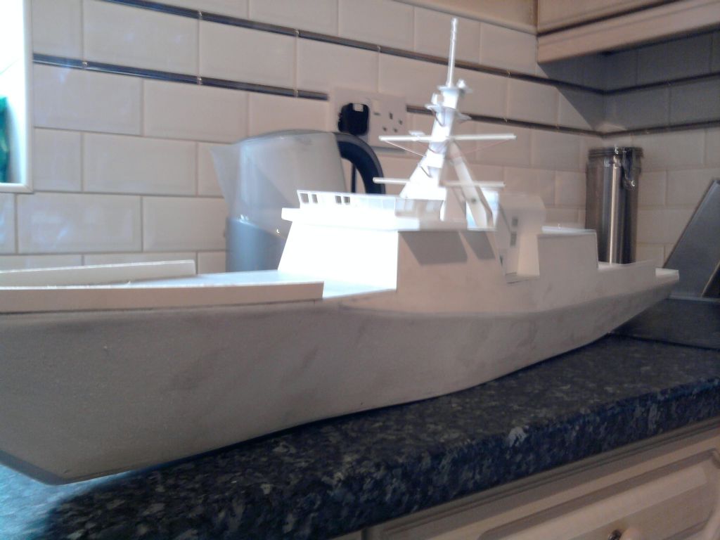

        Scratch build from guess work!
        #33331
          Very good Gary, you certainly seem to have captured the shape of the hull and superstructure – not at all easy when you don’t have a set of plans.

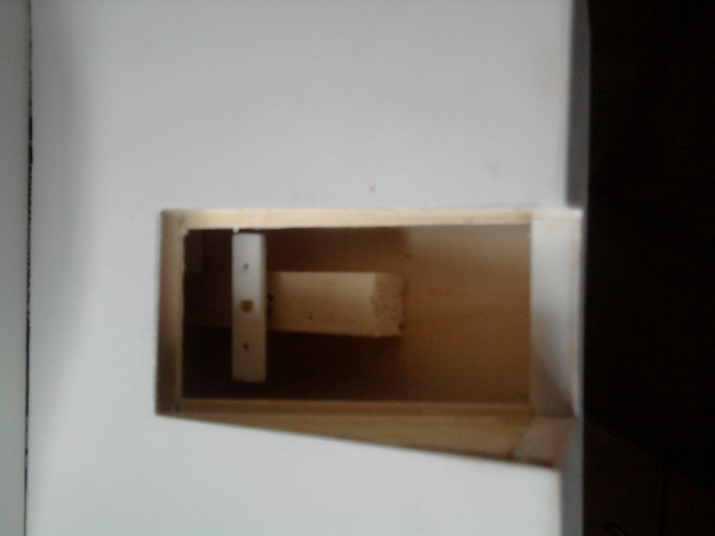

                Gary Wood 1
                  @garywood1
                  Thanks Guys,
                  I guess its going to be trial and error!
                  This is the problem i have . You can see by this construction photo, there is a boat ramp at the stern and a rudder either side, therefore i cannot put a single rudder in the center.
                  Failing the one prop/ two rudder option i will just have to invest in two props as per the boat itself!

                            #33702
                            Gary Wood 1
                              @garywood1
                              Hi Guys
                              SUCCESS!!!!
                              I have re-engineered the rear boat ramp to make room for a single tiller arm, the rudder is slightly further forward and the ramp is slightly steeper, but it is near enough.
                              #33703
                                Gary, You appear to be getting the hang of this scratch building lark.
                                Always remember it is the overall look you are aiming for. I suggest that the minutae can be "accomodating" for operational and time restraints, and no one will notice. Viz the rear ramp….the other thing to think of is access for future maintenance or damage..no good having stuff buried in the ship you cant get at , and rudders can take a bit of a knock.

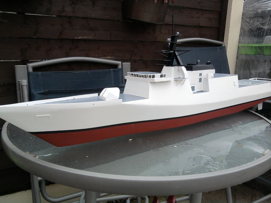

                                #34363
                                Gary Wood 1
                                  @garywood1

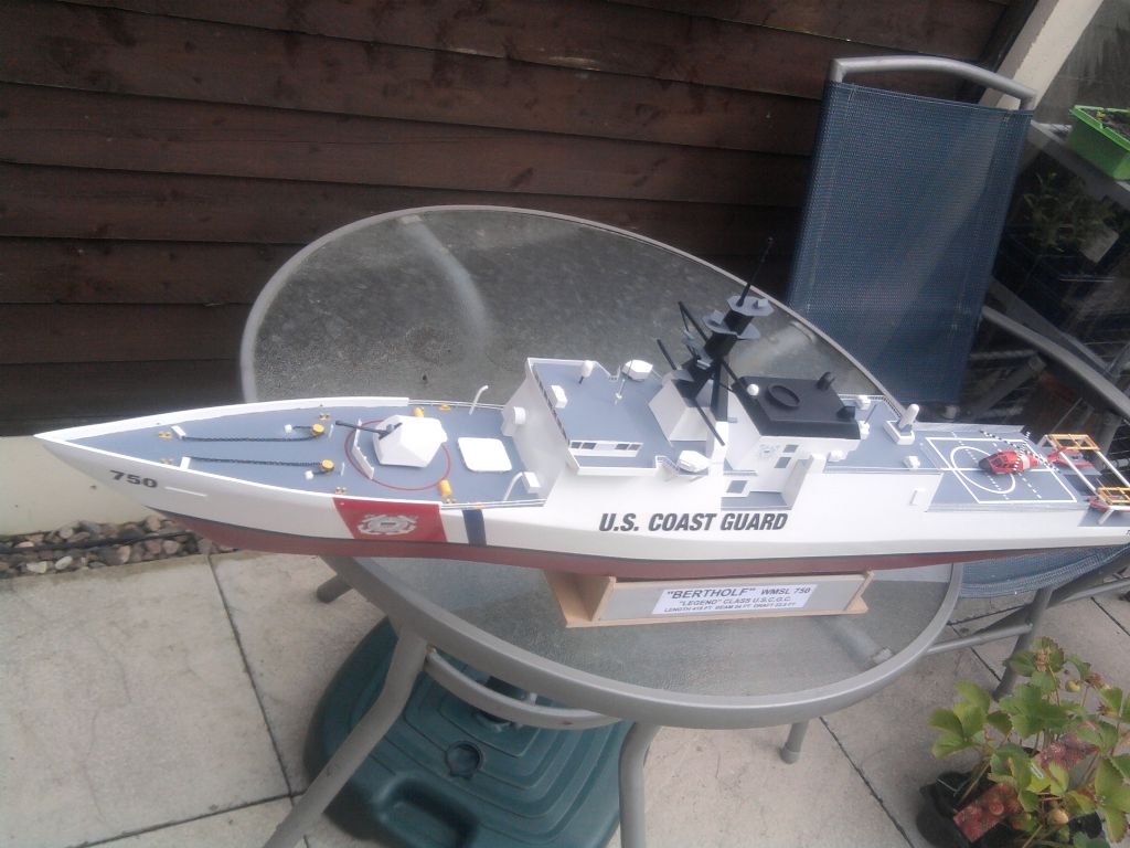

                                  HI all, just aquick update on the progress of the legend class….
                                  Running gear is all done, paint work is almost finnished, just the deck fittings to do!!!!!
                                  #34366
                                    Gary..stuck it in the water yet?? you decided on a one shaft arrangement eventually then?
                                    Unless its a special, almost the last thing I do is take boats out for a run half finished, other than the usual bath test early on. Seeing it on the water and working just makes me think of the NEXT one, so I resist the temptation until the bitter end.
                                    #34368
                                    Gary Wood 1
                                      @garywood1
                                      Hi Ashley,
                                      Yep i decided that the one shaft/ one rudder arrangement was the simplest and cheapest option, I am trying my best not to spend any money on this boat and so far the only things i have had to buy are cans of paint, everything else was lying about in the shed or have been made from scraps.
                                      As far as the water test is concerned, I am of the same mind as yourself, if it goes down to the club pond on a sunday morning it has to be finnished first !!!

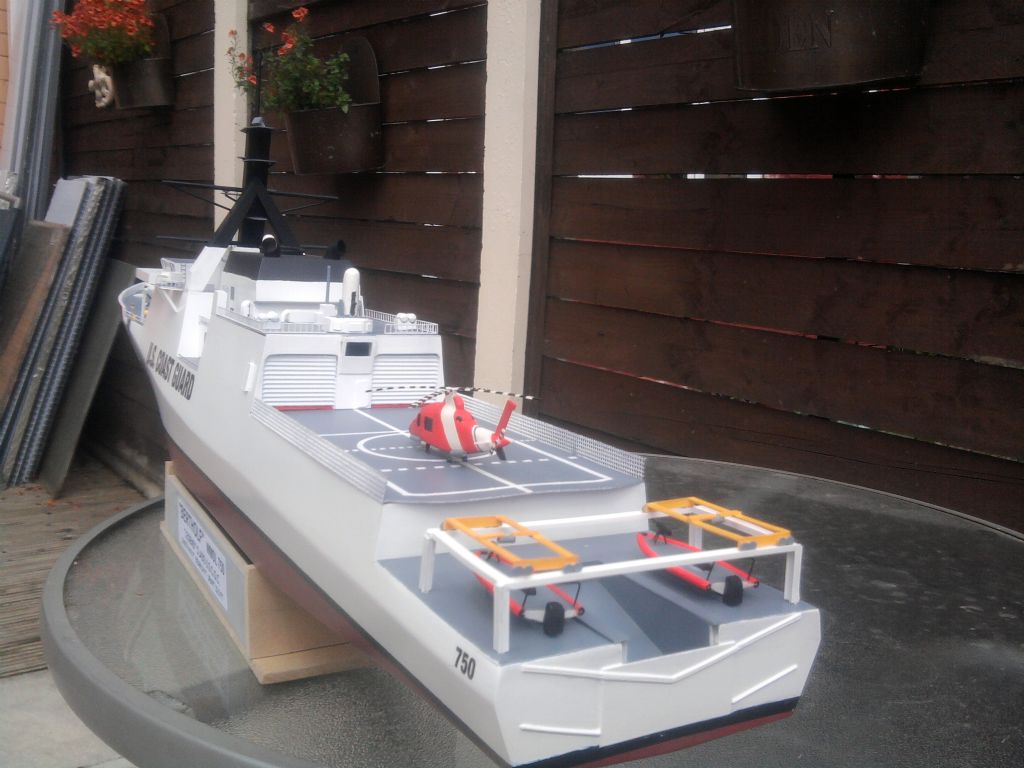

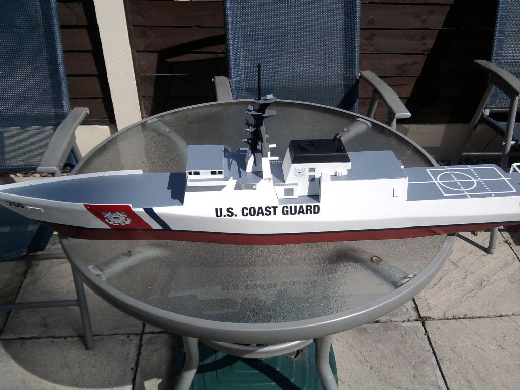

                                              #34894
                                              Gary Wood 1
                                                @garywood1
                                                Hi Guys,
                                                As promised a quick update,

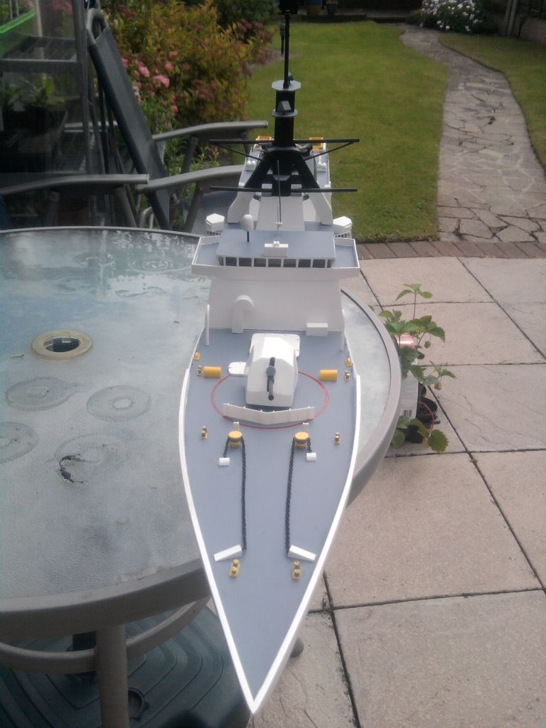

                                                #34898
                                                  Gary. great job. nice and clean, very sharp .. finished enough for a water test yet,, fast or wot?? Ashley
                                                  #34953
                                                  Gary Wood 1
                                                    @garywood1
                                                    Hi Ashley,
                                                    Still not put it on water, i dont want to take it to the club on a sunday till its finnished, all the deck fittings still to make/paint.
                                                    Also a bit apprehensive as this is basicaly my own design, i've made it from photo's not plans, it might just keel over at the first ripple!!!!
                                                    Gary

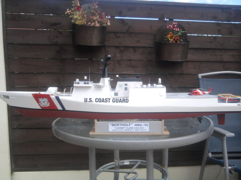

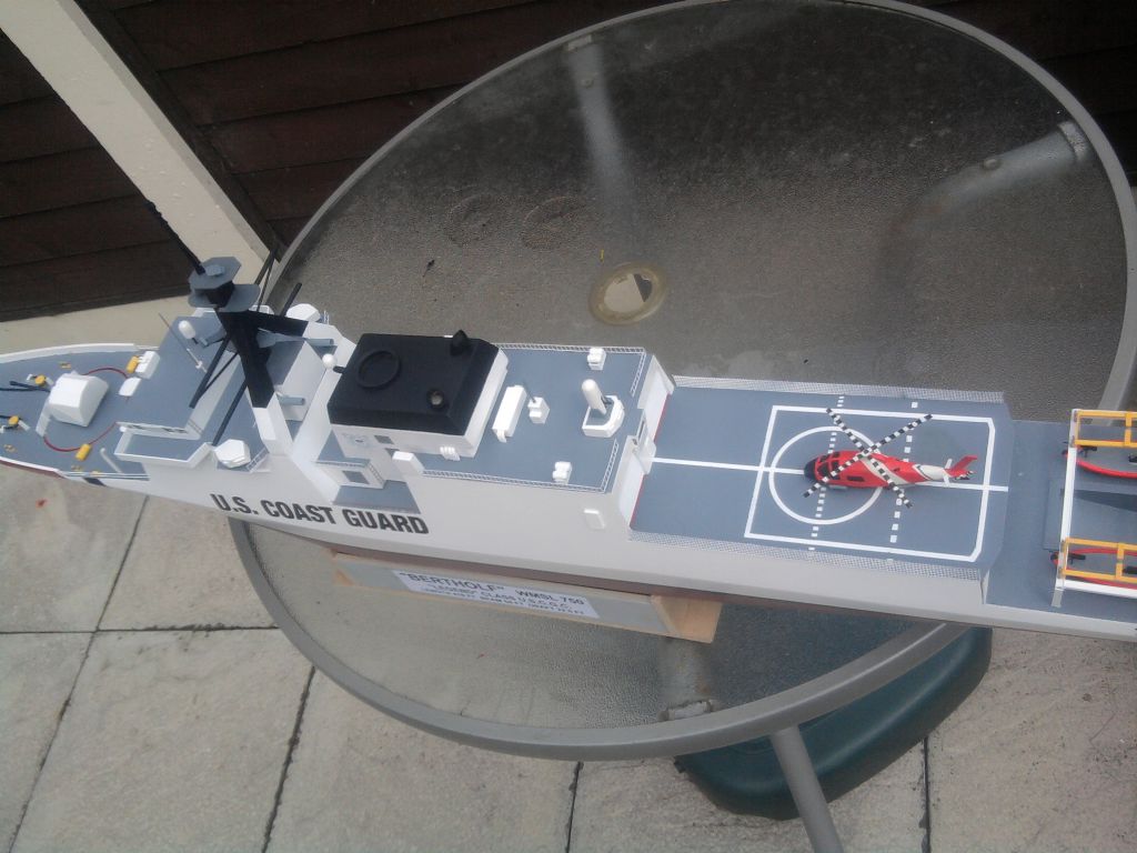

                                                    #35217
                                                    Gary Wood 1
                                                      @garywood1
                                                      Pretty much done, just need a dry day to take her out for her maiden voyage!
