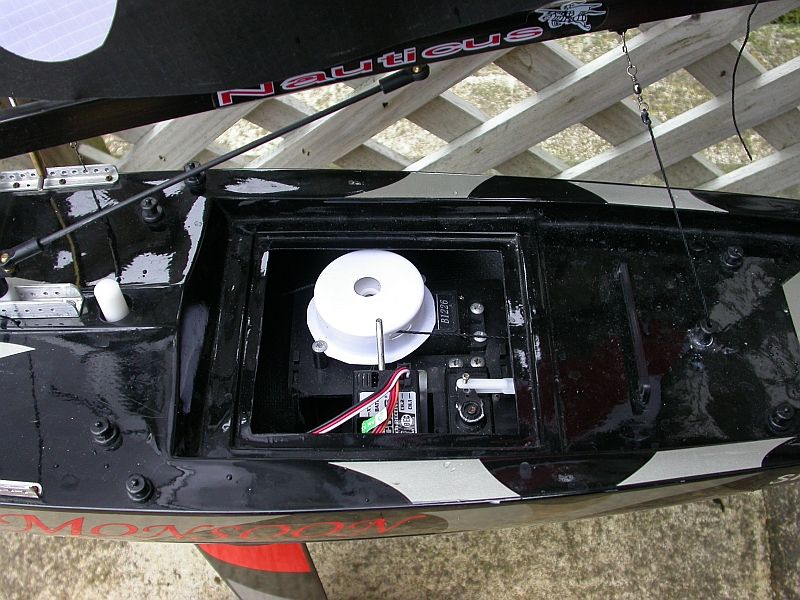

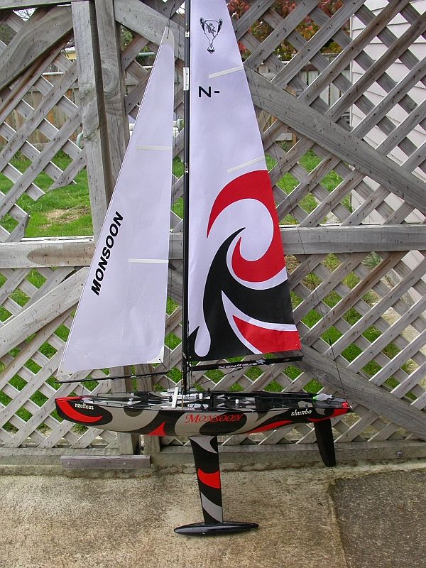

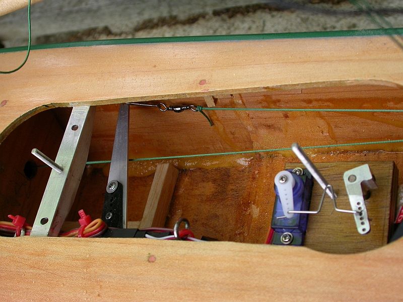

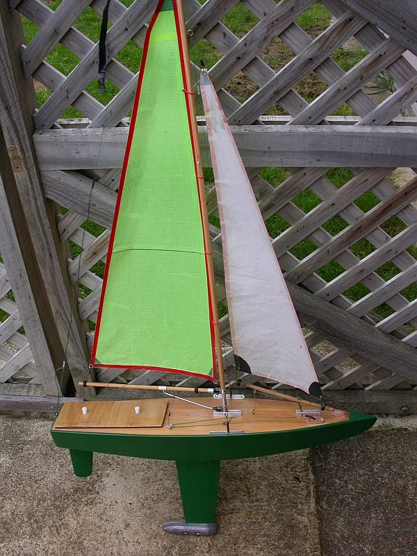

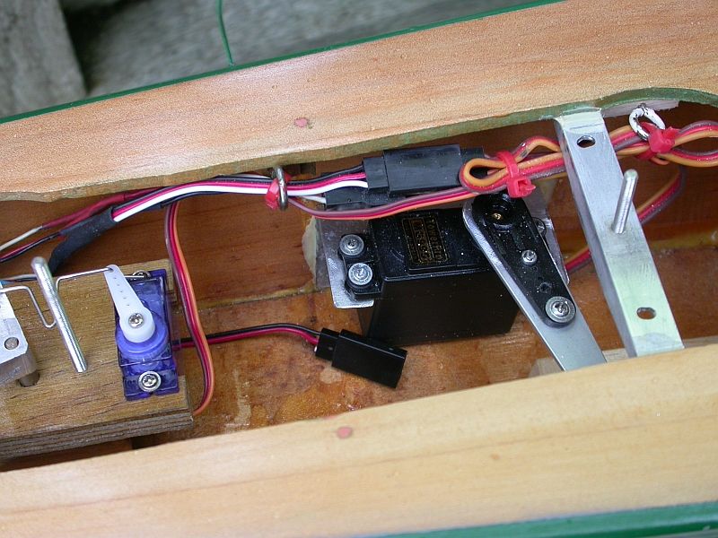

                                        #27048
                                        David Meier
                                          @davidmeier28154
                                          Hi Roger.
                                          Here are the photos I mentioned on the PM.
                                          If you look closely you can see one thread coming out of a curved tube on the front of the deck on the small green boat and then changing to two threads by the mast stay wire (one thread going to each sail).
                                          On the Monsoon yacht a thread comes from each side of the sail winch drum and go through separate holes in the deck to each of the sails.
                                          Edited By David Meier on 02/06/2010 03:25:14
                                          #27068
                                          roger thompson 1
                                            @rogerthompson1
                                            thanks for the pics. david.——-i now am beginning to get the picture of how the sails are operated.
                                            how do you know where to put the servos , balance wise?-or is it not too critical?
                                            rog.
