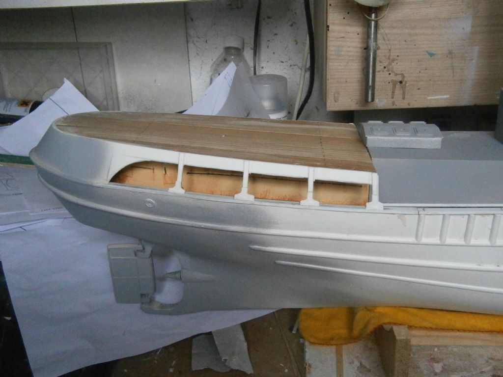

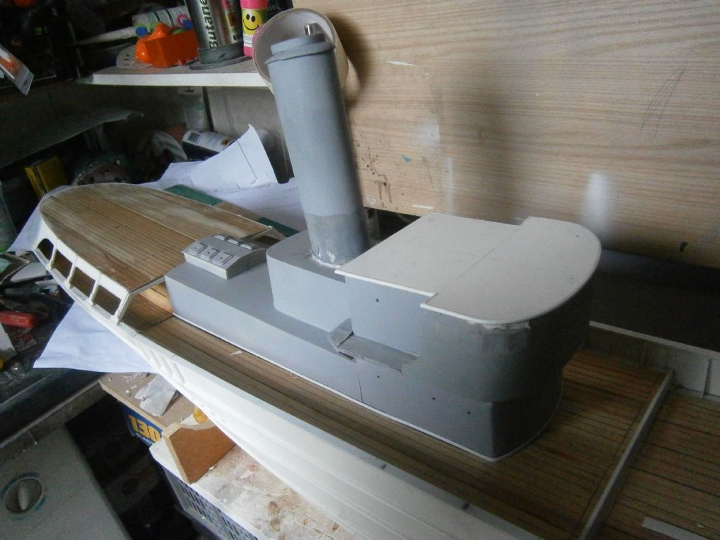

                HELLO back again,
                wheel house and cabins ,formed plus subdeck tempory fited.
                a lot of errors in hull shape allover place had to pull to shape using centure
                datum line taken from drawing, witch is is difrent to hull lines ,
                may be hull mould or deflected on curing.
                but got round it next move is to work on gunals a lot of filler and sanding to get
                a workable finish. …….LARRY…

                    #33180
                      Hello Larry
                      I would simply cap the top edges
                      Out of sight……Out of mind….eh?
                      #33181
                        Bob is right, I have used small brass channel to cap bulwarks and it gives a good result. As far as the inside of the bulwarks is concerned the ‘standard’ answer is to use car body filler to smooth them off but I have found it better to uses short lengths of thin ply or plasticard attached with contact adhesive. If you are using plasticard then only use a smear of adhesive as some types can eat into the card and softn it. Use filler to seal any gaps between the sheet sections. I have found this method to work very well on two models and it’s a lot less messy than the filler route.
                        Do the capping after you have put the sheeting on the inside of the bulwarks.

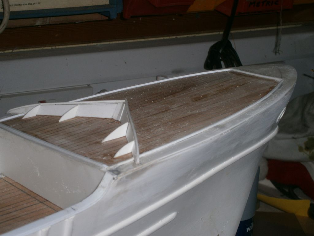

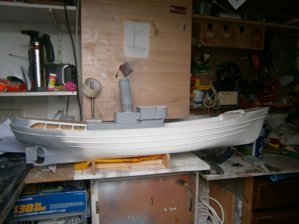

                          LARRY WHETTON
                            @larrywhetton68737
                            THANK YOU BOB AND COLIN
                            Help as you see from pictures this not a good hull mould,
                            it is different to Tom Gorman drawing, but only slightly,
                            i think its down to bad mould build …..both are hobby store products …Larry…..

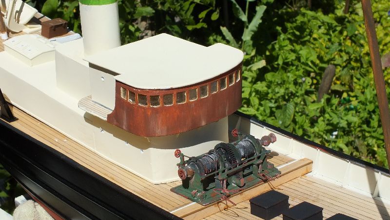

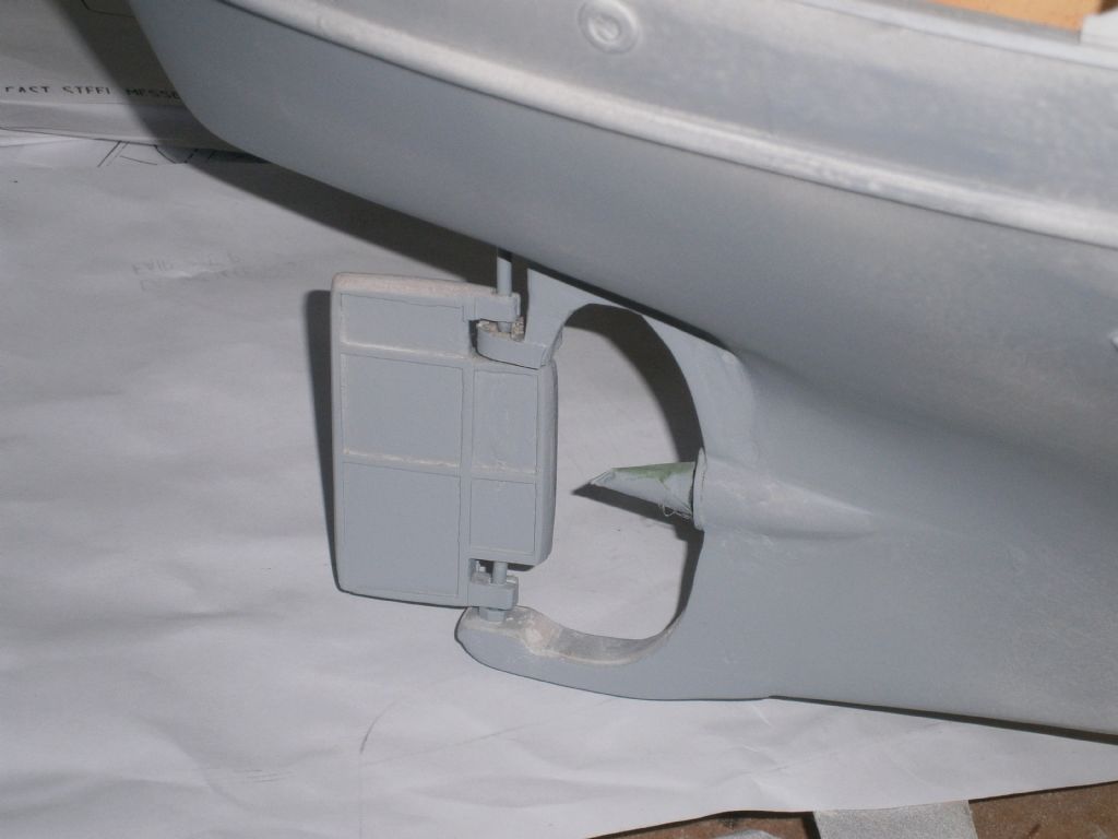

                                  Gone back to trawler build , now finger as healed,….lined bulwarks and fited braces and toprail.
                                  also fitted moor and rudder link , completed stern cover deck , and bow spray deck ,….
                                  and a paint finish to crews stern cabin now starting on winches and deck clutter and hachtes ,…..
                                  when get some info can any body help with this not much detail on plan so artistic licence will
                                  take over still like to scratch build my own bits ………..Larry…….trawler

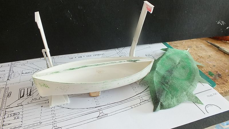

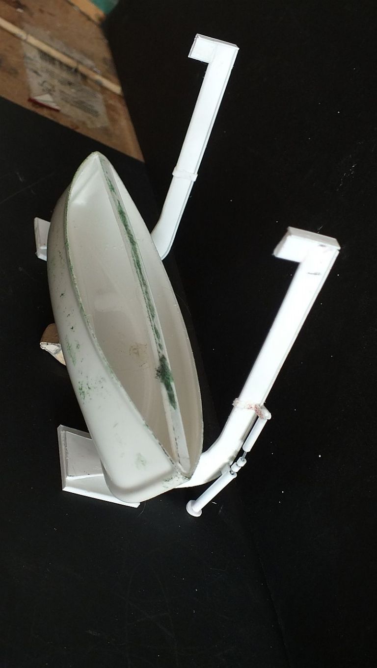

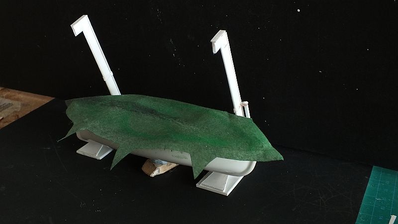

                                          davits started , the green bit willbe life boat cover, Larry…..

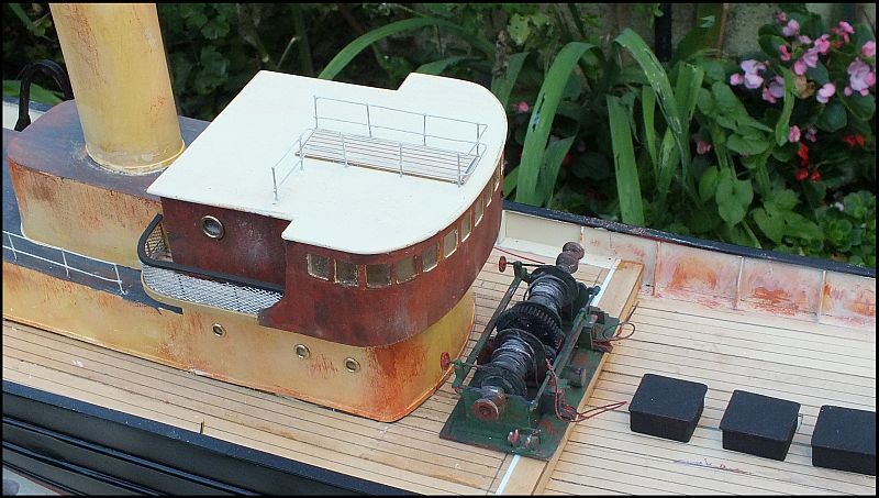

                                          LARRY WHETTON
                                            @larrywhetton68737
                                            harry pool trawler (12) edit.jpgHi All
                                            On with the motley , or paint job now the weather better,………Larry…harry pool trawler (15) edit.jpg
                                            #35414

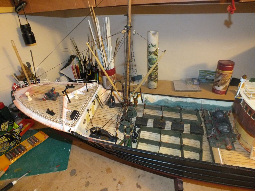

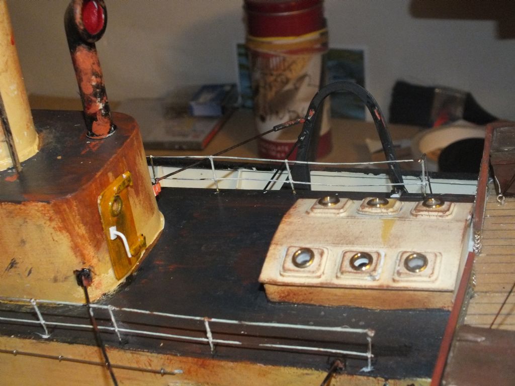

                                                LARRY WHETTON
                                                  @larrywhetton68737

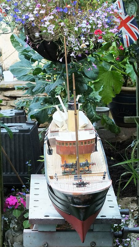

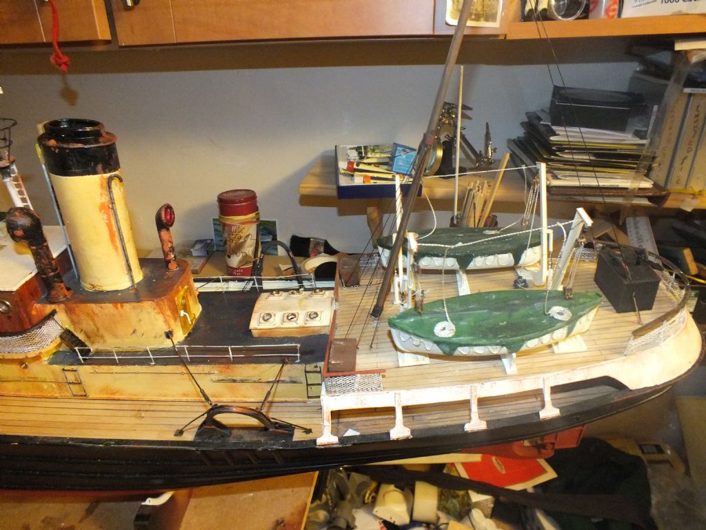

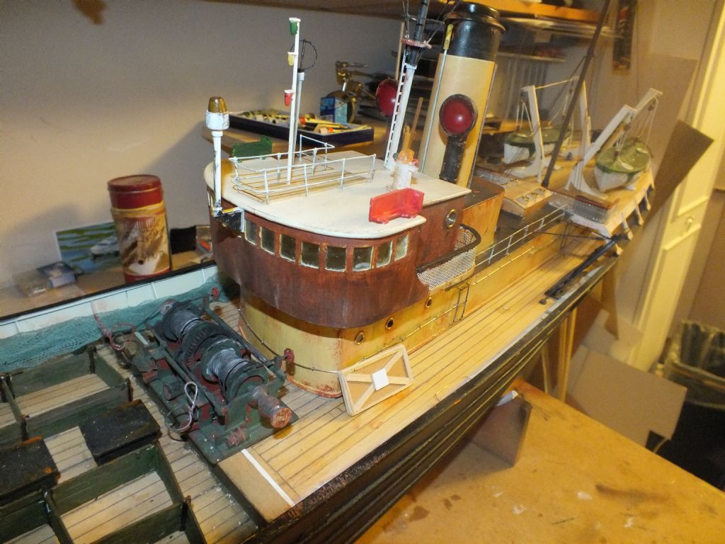

                                                  trawler 002edit.jpg Hello all ,
                                                  Done a bit more on trawler , between gardening and a family sad event ,
                                                  so take look at latest pictures , be free to comment ………..Larry…trawler 001.jpg

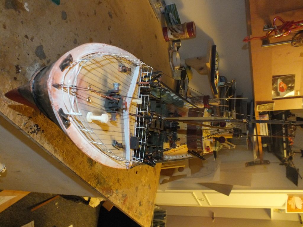

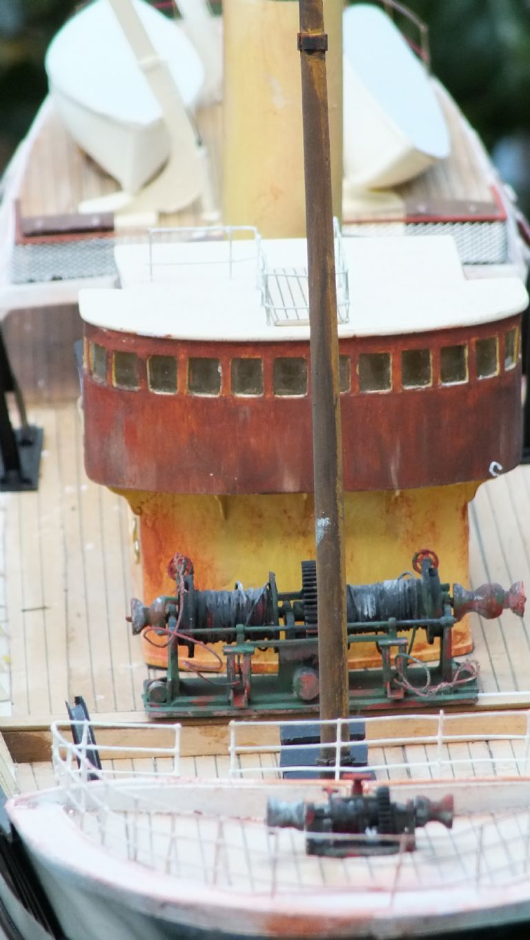

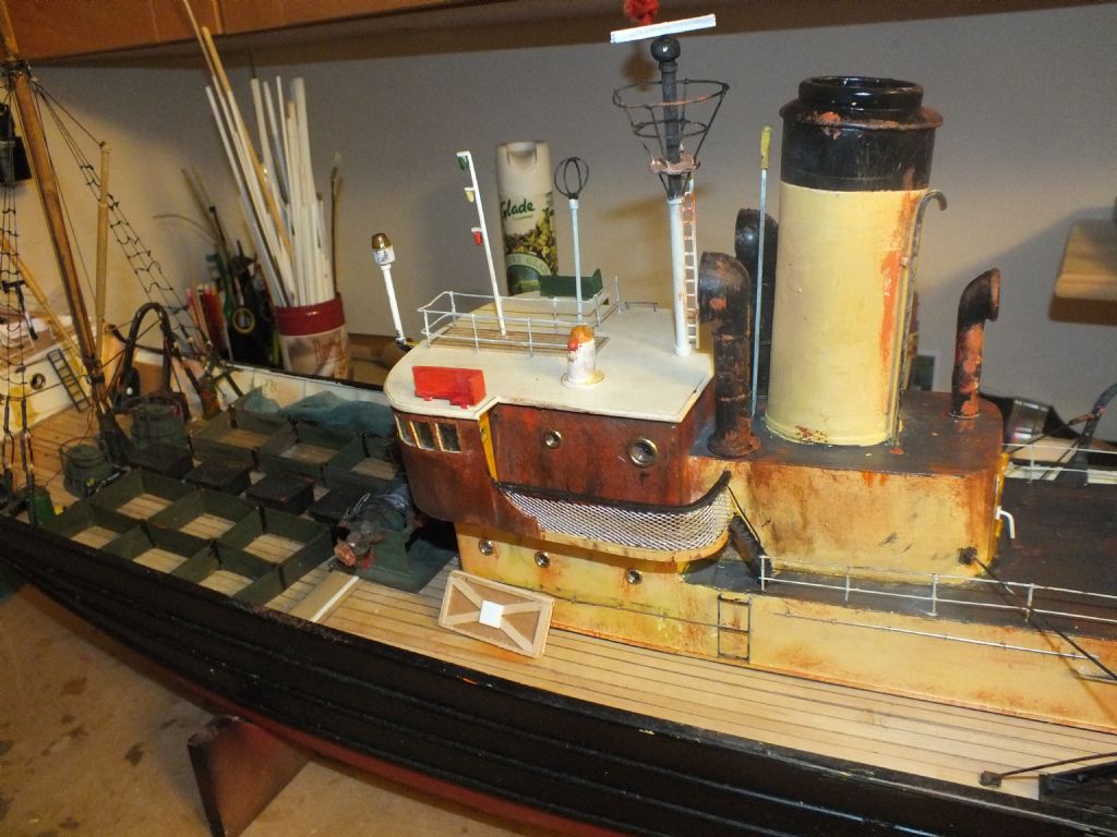

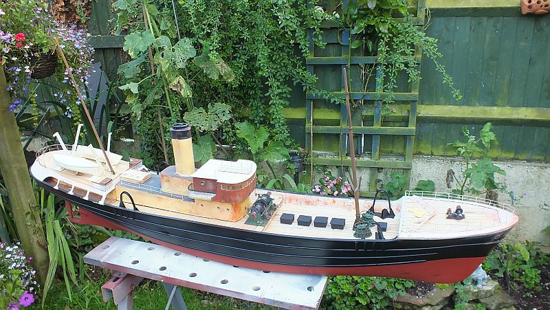

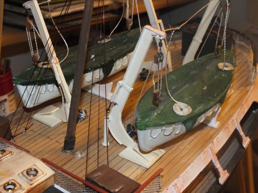

                                                  #38274
                                                  LARRY WHETTON
                                                    @larrywhetton68737
                                                    Hello all

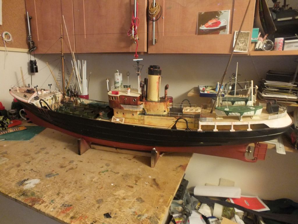

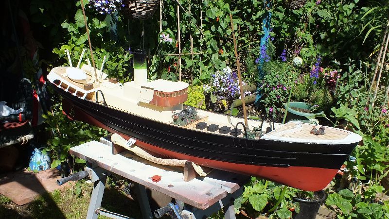

                                                    Well my artic trawler is ready for launch, just a few little bit of tweeking to be added ,
                                                    happy with paint job and scratch build details , its been a hell of build ,
                                                    hull did not match plan , and was a bad moulding , and plan lacked detail so ,
                                                    its my consept of a trawler , see photos ,…….cheers Larry…..
                                                    #38275

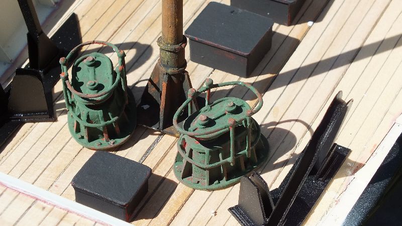

                                                      Hello Larry
                                                      You've certainly given your boat a good weathering!
                                                      One thing that stands out ……….is the squeaky clean deck!
                                                      Take for instance the deck under the very mucky winch and those green tub things
                                                      With such a mucky boat, there needs to be a build up of grime all around anything that rests on the deck
                                                      I would use acrylic paint…..umber and burnt umber with some matt black sparingly
                                                      Where the crew actually walk, should be reasonably clear
                                                      Does this suggestion make sense?
