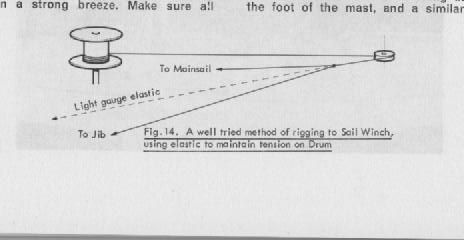

                Hi ,      I’ve always used the elastic cord method of pulling out the main sheet on deck.       It keeps a constant tension on the winch line so the winch pulls it in and the elastic on deck pulls it out, simple.         I only have one line going to the winch drum, the other end attached to a 10mm ring, all the sails sheets (5) are attached to this ring as well as the elastic cord.         The ring is not a deck ring, its just a wire circle made from a paper clip and soldered together.              My boat is a two mast american fishing schooner like the Blue Nose schooner.
