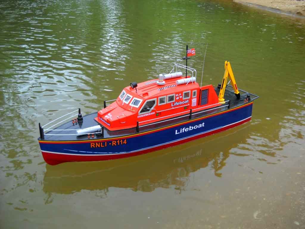

      Friends..it was my long dream to complete aN RNLI Life Boat..all of my efforts to complete this boat is dedicated to all brave Men and Women, who serving the RNLI..and i am bowing in front of them all, for the bravery and dedication..to save lives, while risking their own life..

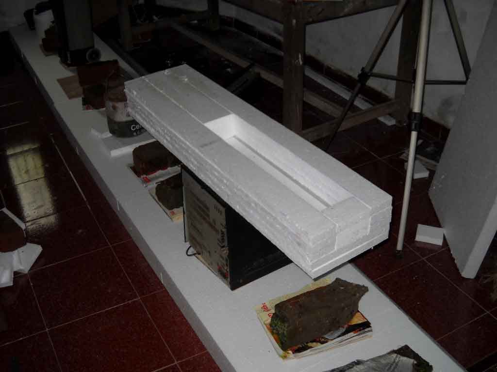

      as usual, i started with thermocol sheets..she spans about 3 feet..

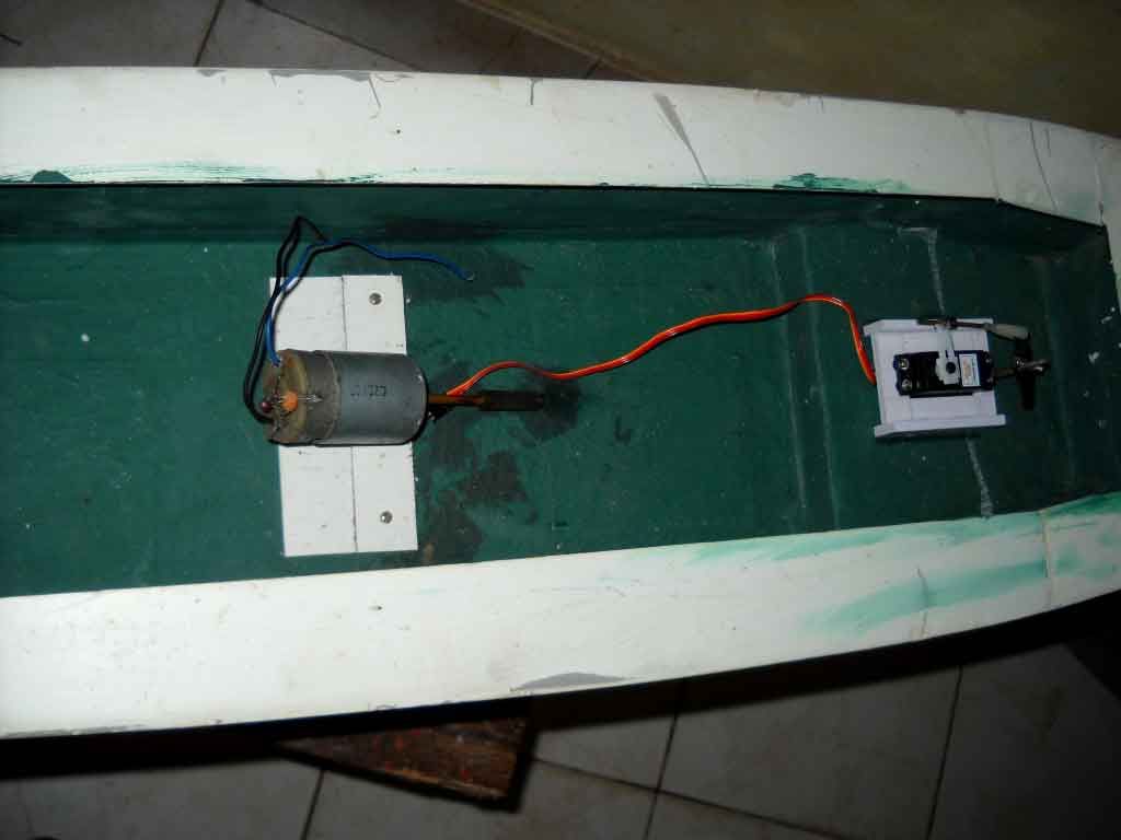

      the motor was scraped, and reworked for 6 volts..it runs about 5000 RPM..

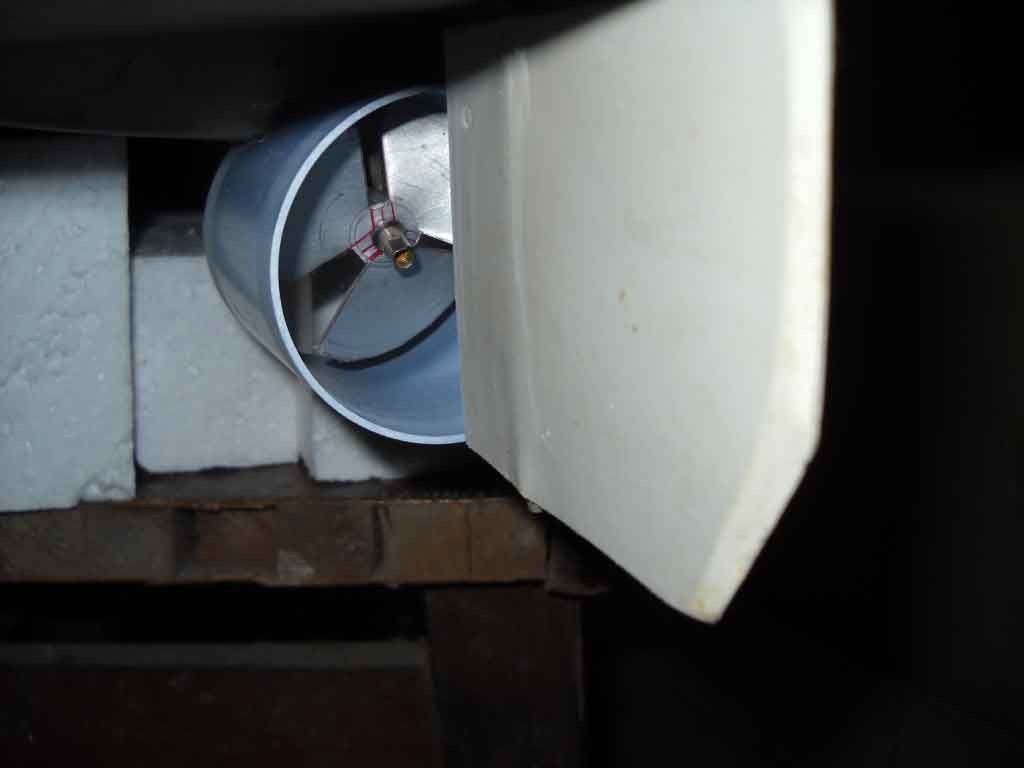

      you can see a simple piece of PVC pipe, over the prop made of aluminum lid, is a simple nozzle, to avoid any side thrust wasting..it gave me even more than 20% battery life..

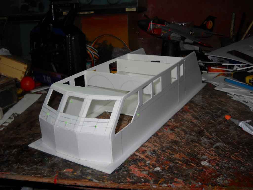

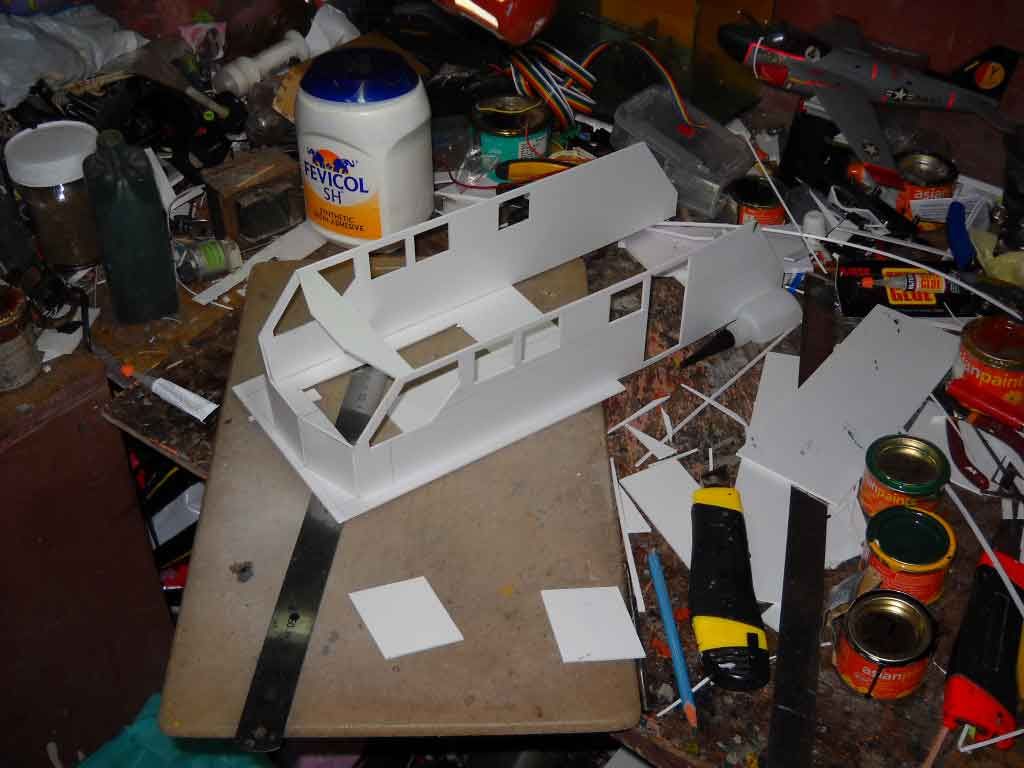

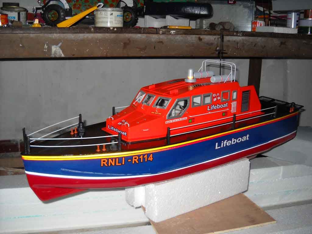

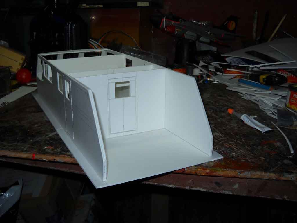

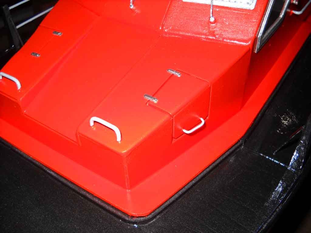

          all super structure was made of foam board and paper..and seasoned to water proof..
          she is made of 1:27th scale aprox..to me..

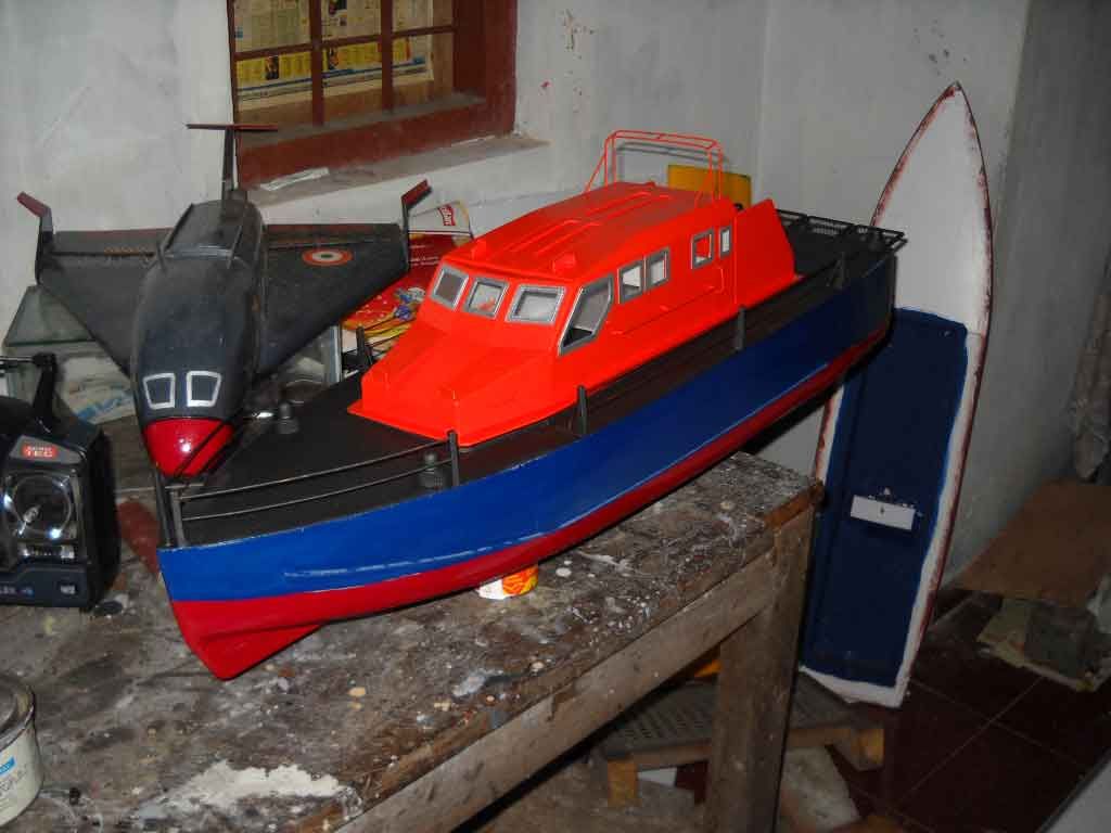

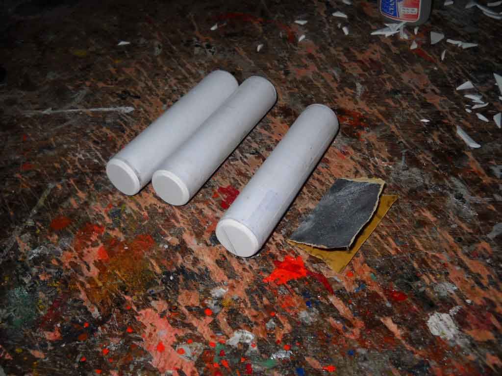

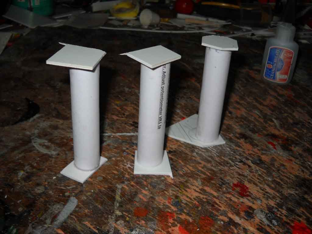

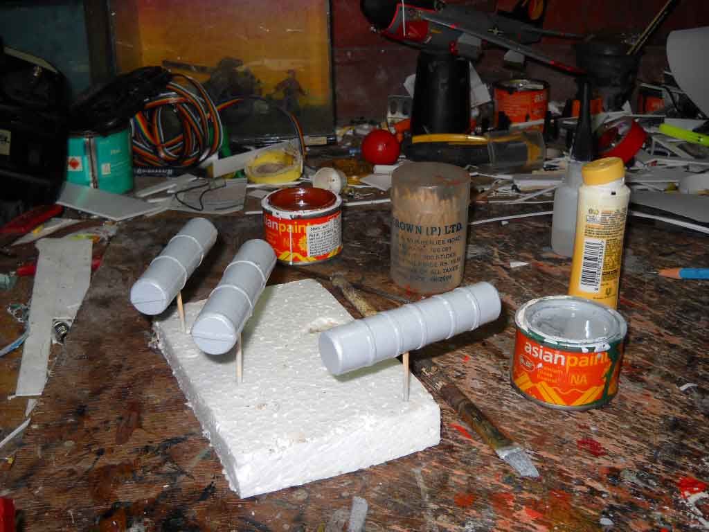

            life rafts from paper rolls and worked with papers..
            can see the finishing works..
            after detailing with papers, i painted it with ordinary enamel paint, while adding some clay and talcum powder in it..
            #32972
            aquaplaner
              @aquaplaner

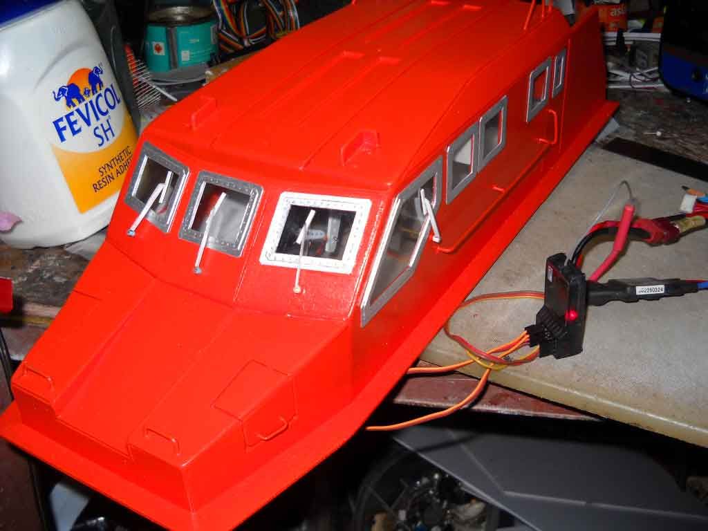

              painting is done with ordinary enamel paint..with hand brush…
              added some clay powder to get a textured surface..
              all window lining made of paper..later painted with aluminum paint..
              waiting to dry up..
              all stickers were took by DTP, and printed in an A4 paper..cut and paste..laminate..to water proof..

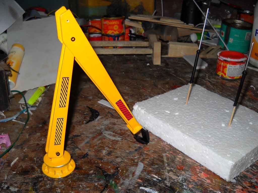

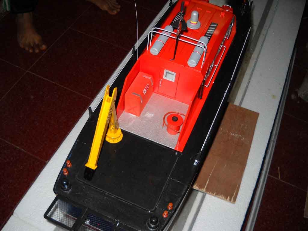

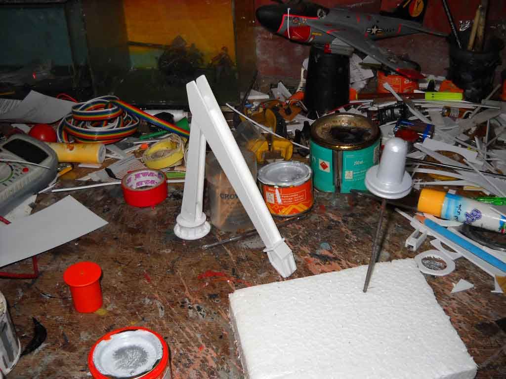

                the crane is made of foam board..
                i was in an extreme excitement, to run her..so i kept the crane as non working…
                on the panel..
                added some kum kum powder to paint to get a high brite yellow..

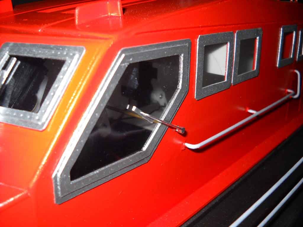

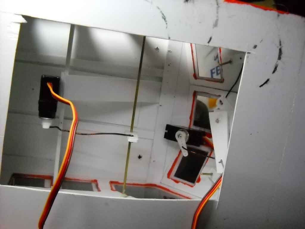

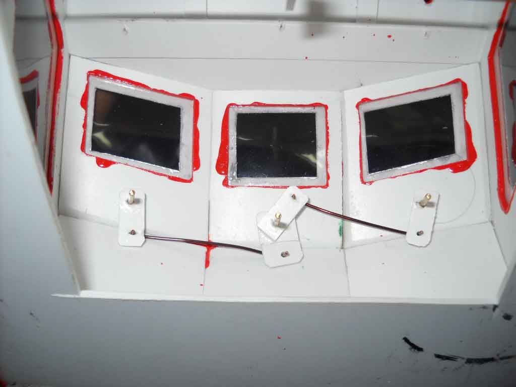

                  wiper was made of reworked servos, in continious rotation..
                  can adjust the speed by relevent channel..

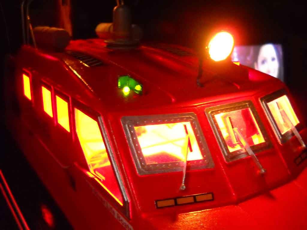

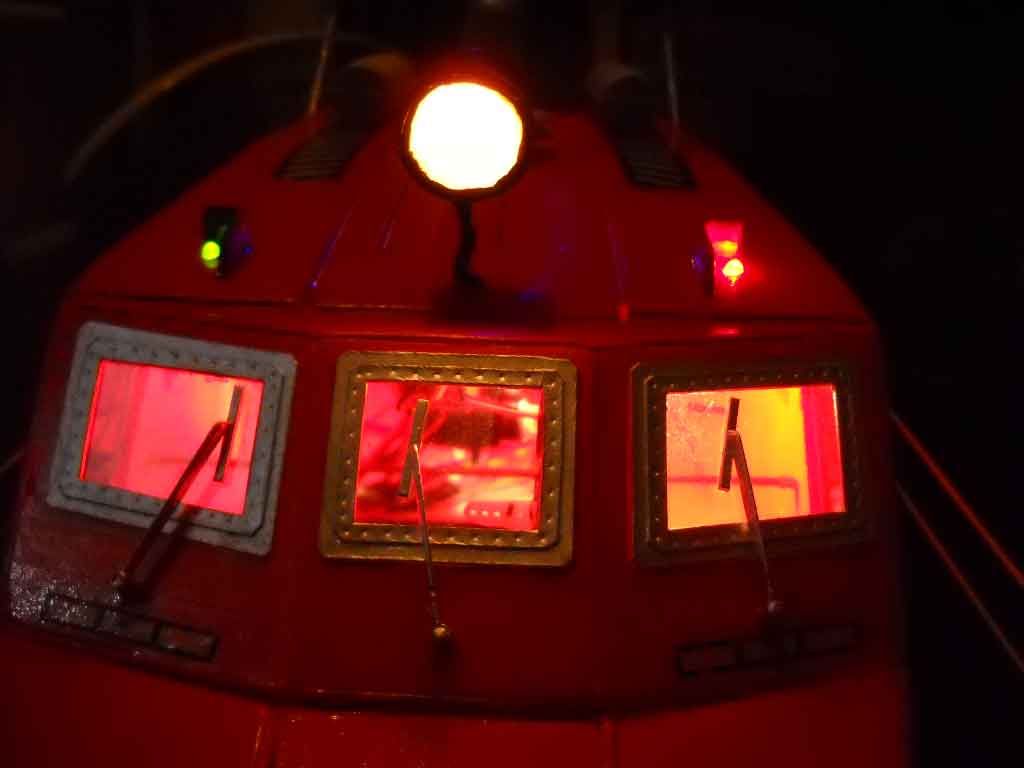

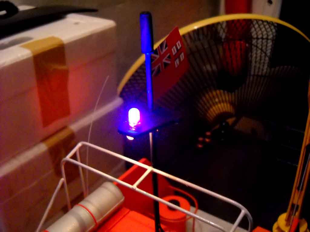

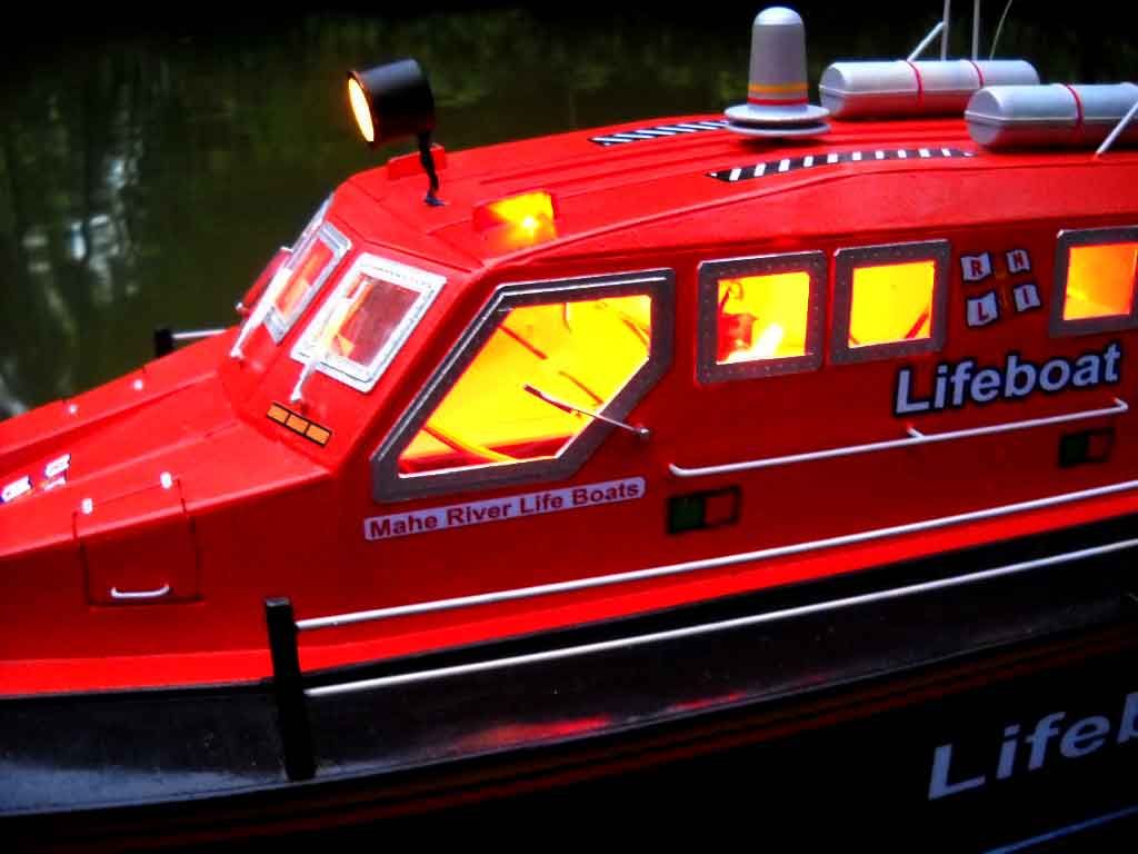

                    whats a craft without lighting…
                    #32976
                    aquaplaner
                      @aquaplaner

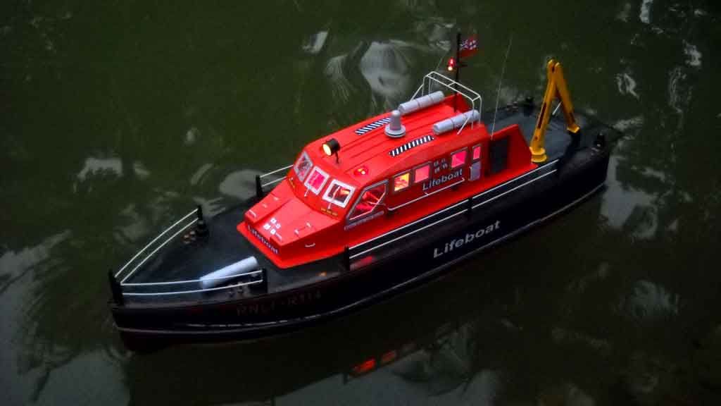

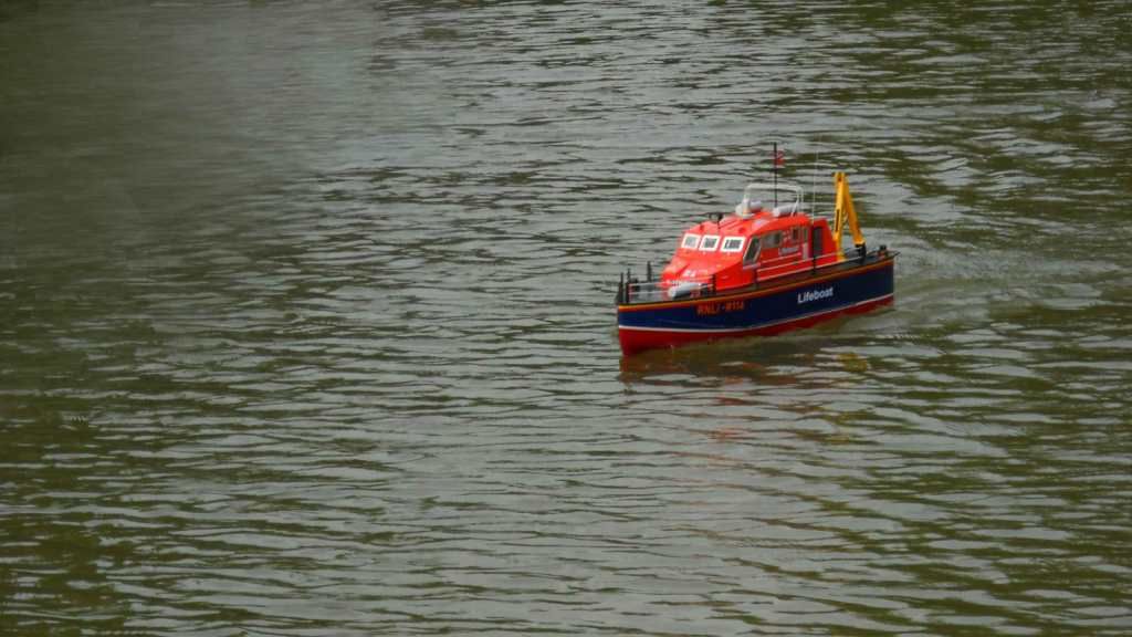

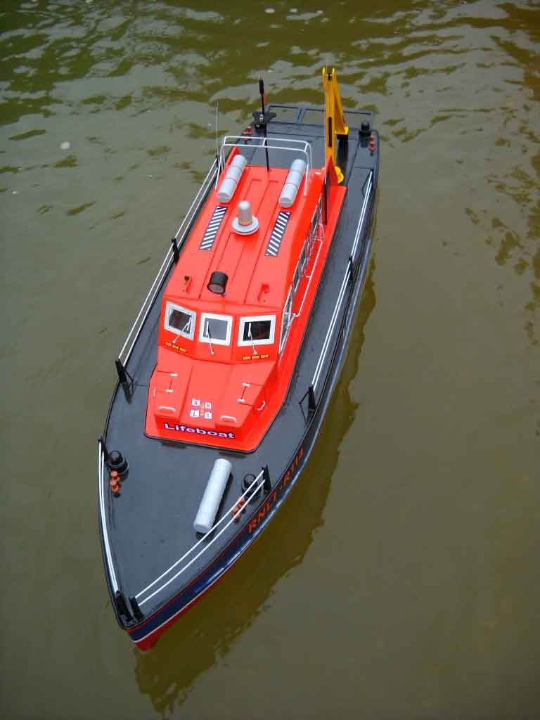

                      and she is in water…
                      lights on..
