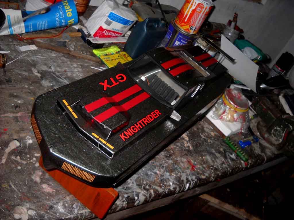

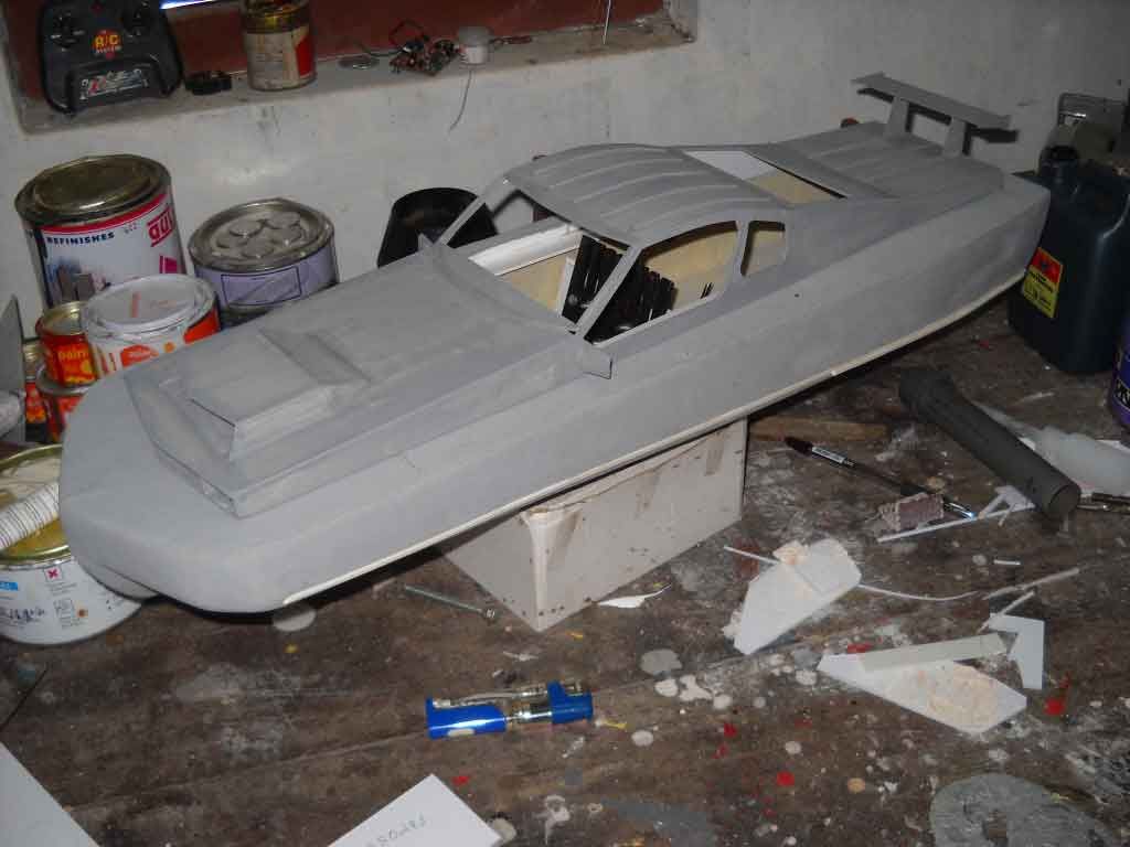

      Friends..when i was a boy, one of the most inspired TV show..was..yes..the Super man..but among them, one was the..yes the episode from KNIGHT RIDER…so, as i started my model making seriously around 8, i completed many Knight Riders on wheels..but this is my new KNIGHT RIDER, on a hull…as a modeler, whats a collection without a classic Knight Rider..
      it is equiped with all features..horn..infrared scanner..high power head lights..and she is awesome…in water…

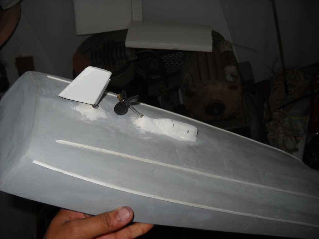

      i sarted as usual..with thermocol..(expanded polyterene). she is based on my imaginations, not from a plan..but surely inspired from FORD MUSTANG..one of my favourite car…

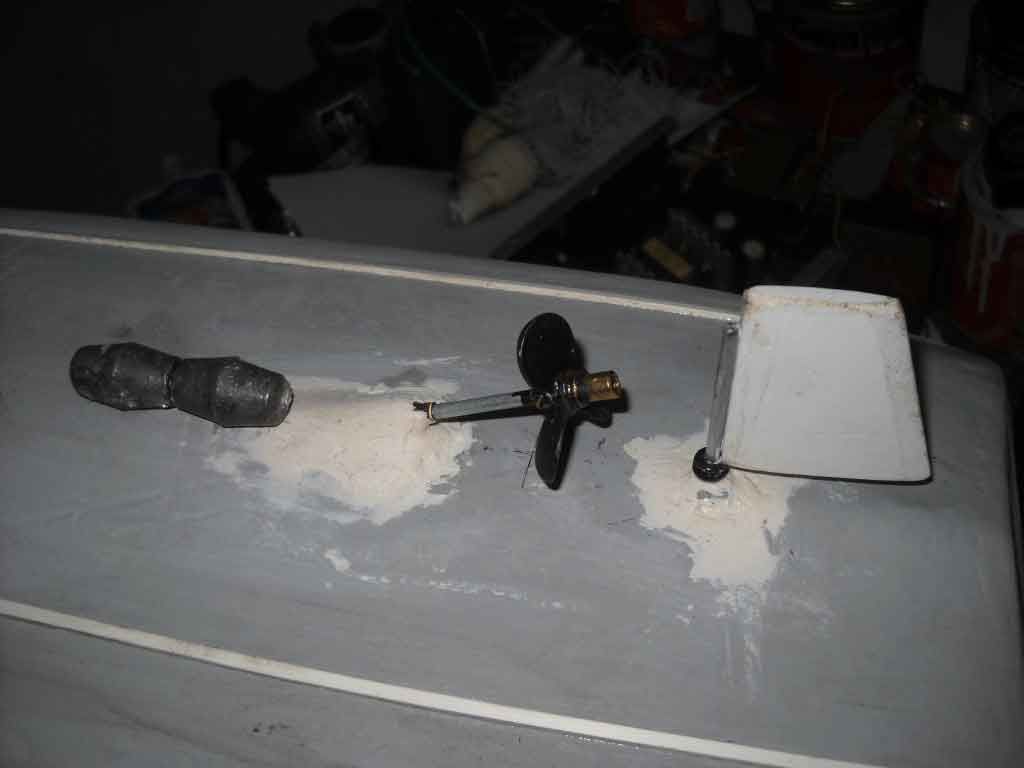

      after finishing the hull, i test runed her..and added two led weights on the centerline..for added roll over stabilty..and worked well…

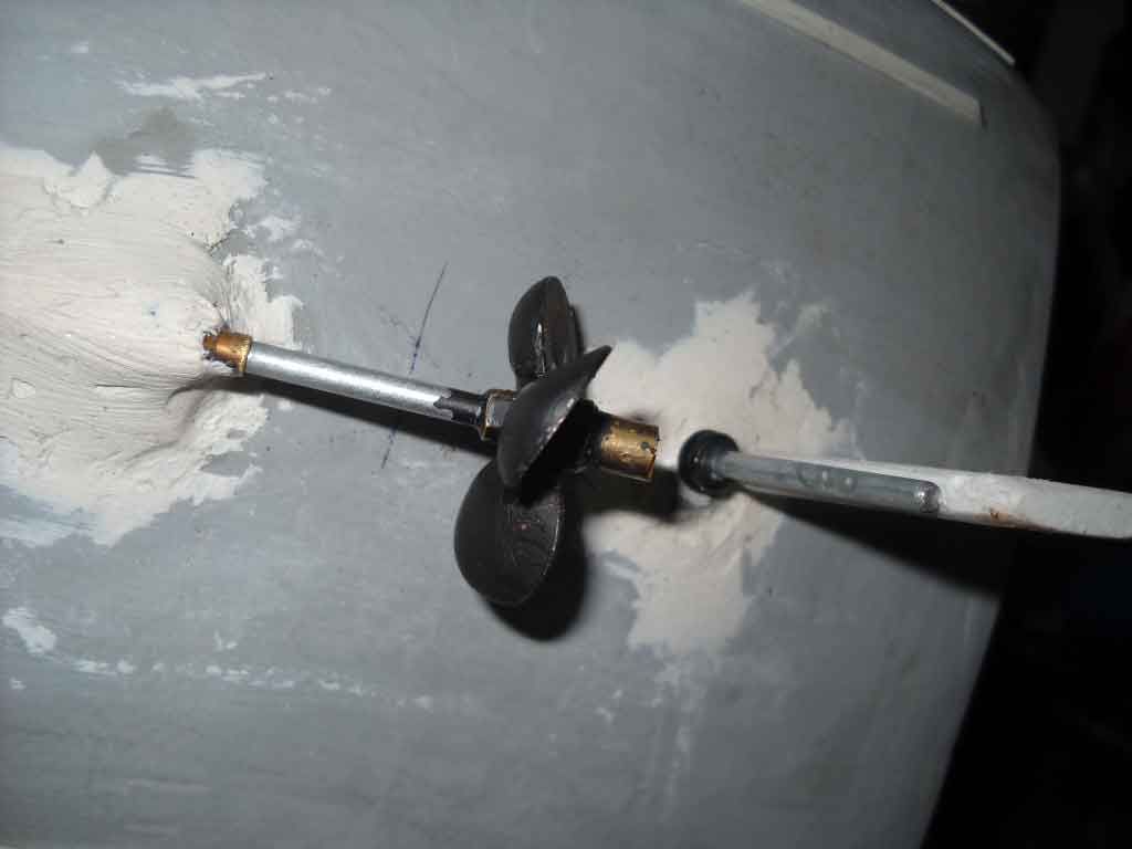

      the prop was made from metal washers, groved on a 6 pole hex nut..and you can see the aerofoil like structure, is made from pu putty, gives me even more thrust even at low revs..

          she is powered by a immensly powerful ECM, is fixed on a heat sink, scraped from a SMPS..

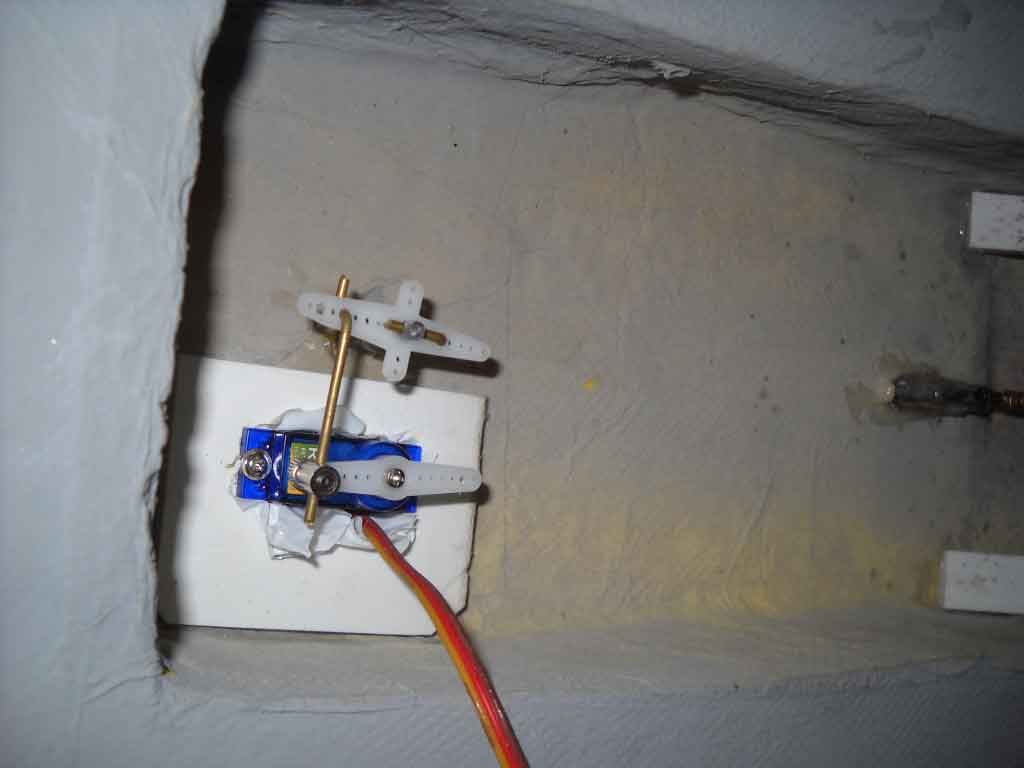

          the micro servo was not enough to hold the control surface..so i rewoked on motor and rectified it…

            showing the control setup..
            and can see the weight is fixed with pu putty..and stream lined…

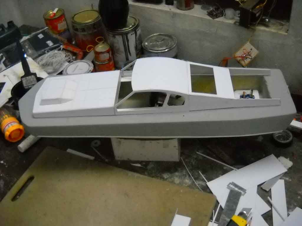

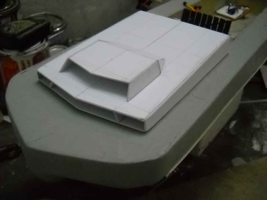

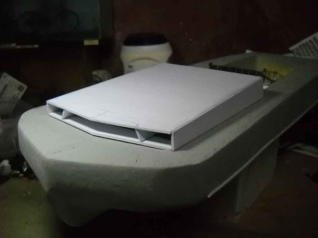

              the pod is for infrared scanner…
              started making the super structure..all drawing papers…

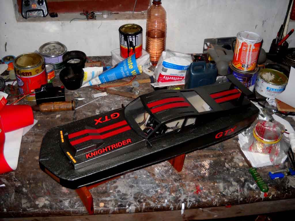

                after putty work..still progress…
                and later i sprayed her with poly paint, in to silver ghost color…and all stickers from DTP, and reflective tapes used in automobiles…

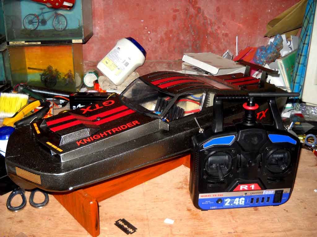

                  she is about 2 feet long, and beamed in to 7 inches…
                  she is powered by a reworked 4 channel radio..i added two more channels on it, and just added a DR..and for horn and lights…smoke generators..many…

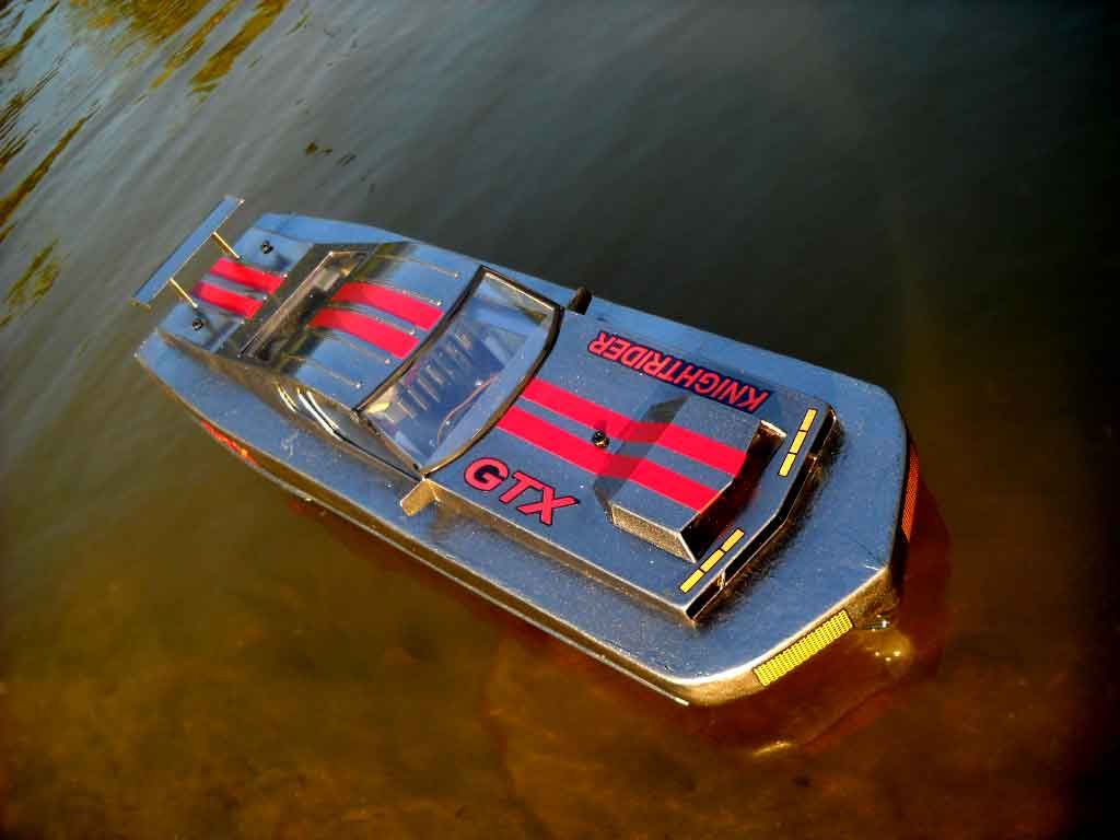

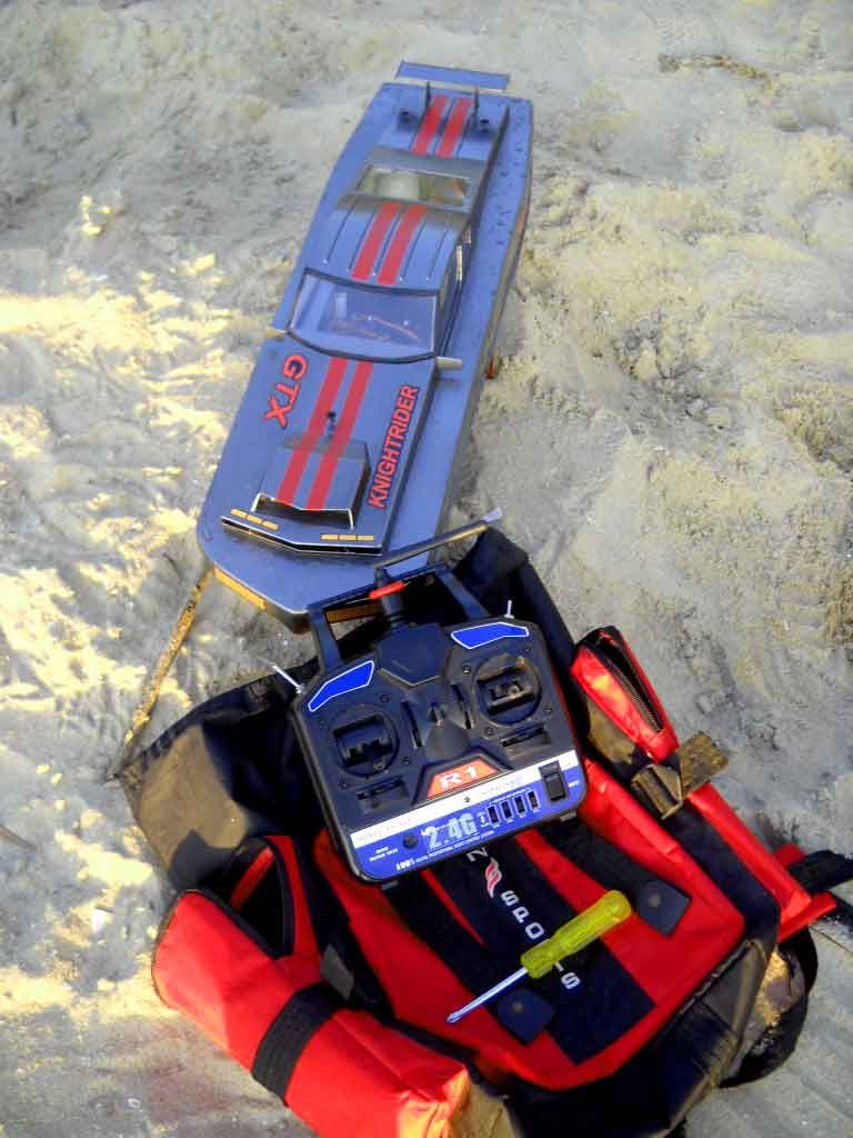

                    she is in water..look how stunning she is…
                    and after some time my back pain came intense..so i took some rest at beach…so i got some good photographs to my collections…

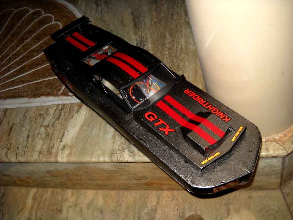

                      see some good photographs..its my place… and she back at home..she is so beautiful..even at night…
