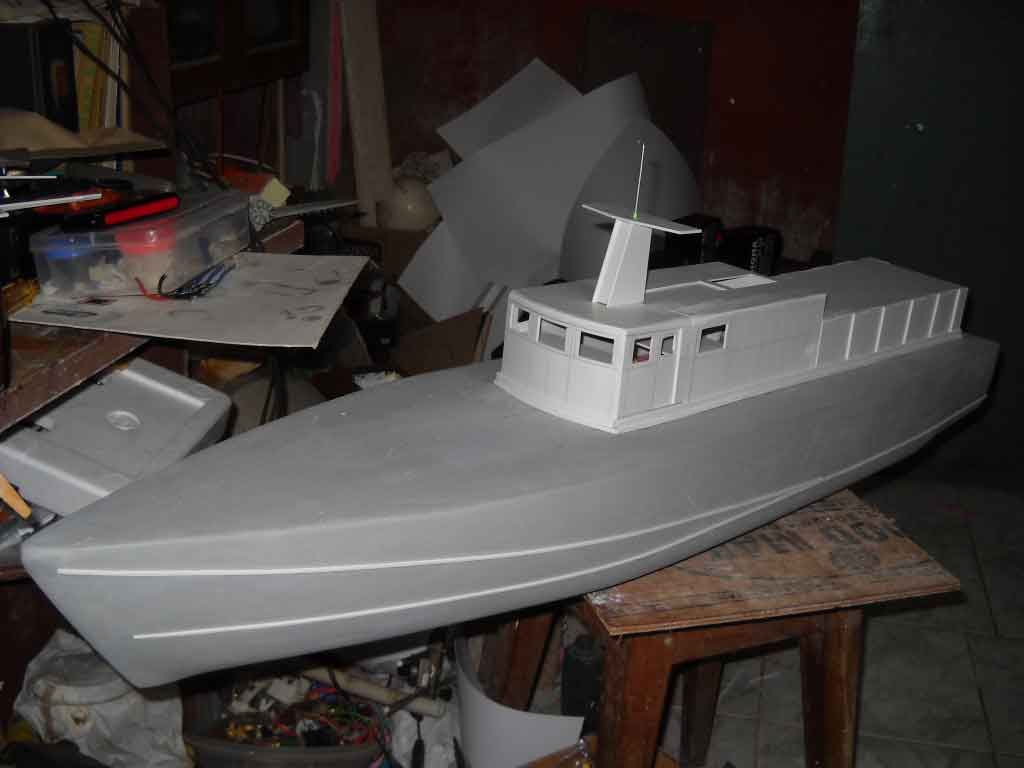

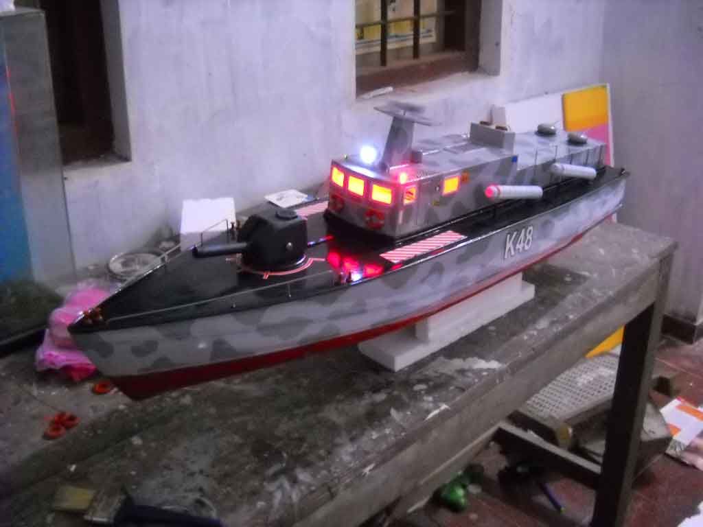

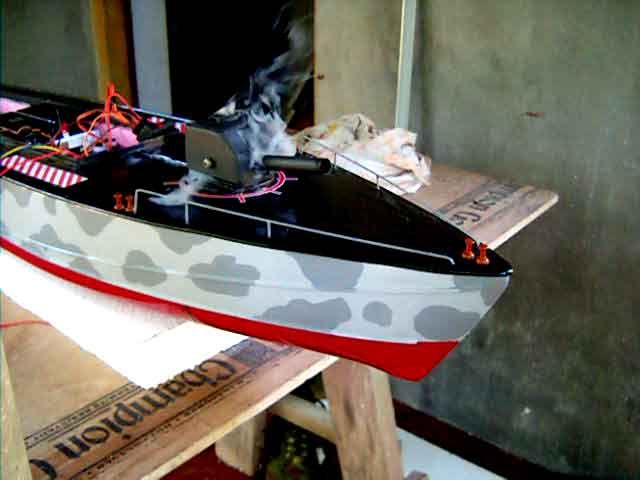

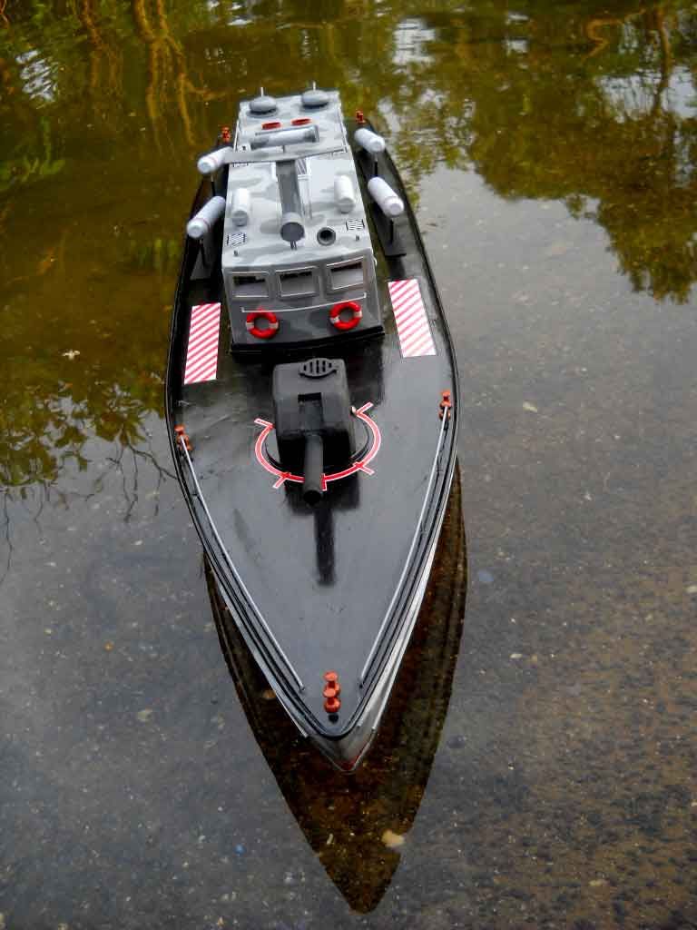

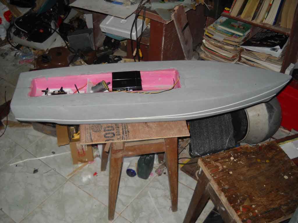

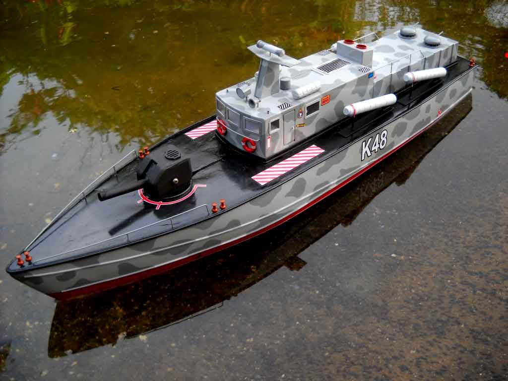

Friends..this one is my K48, means i added lots of my imagination on this craft, from original..started with thermocol…

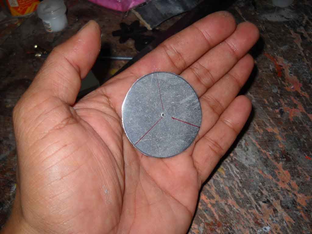

pro made of aluminum sheet..
scratch built missile launcher..

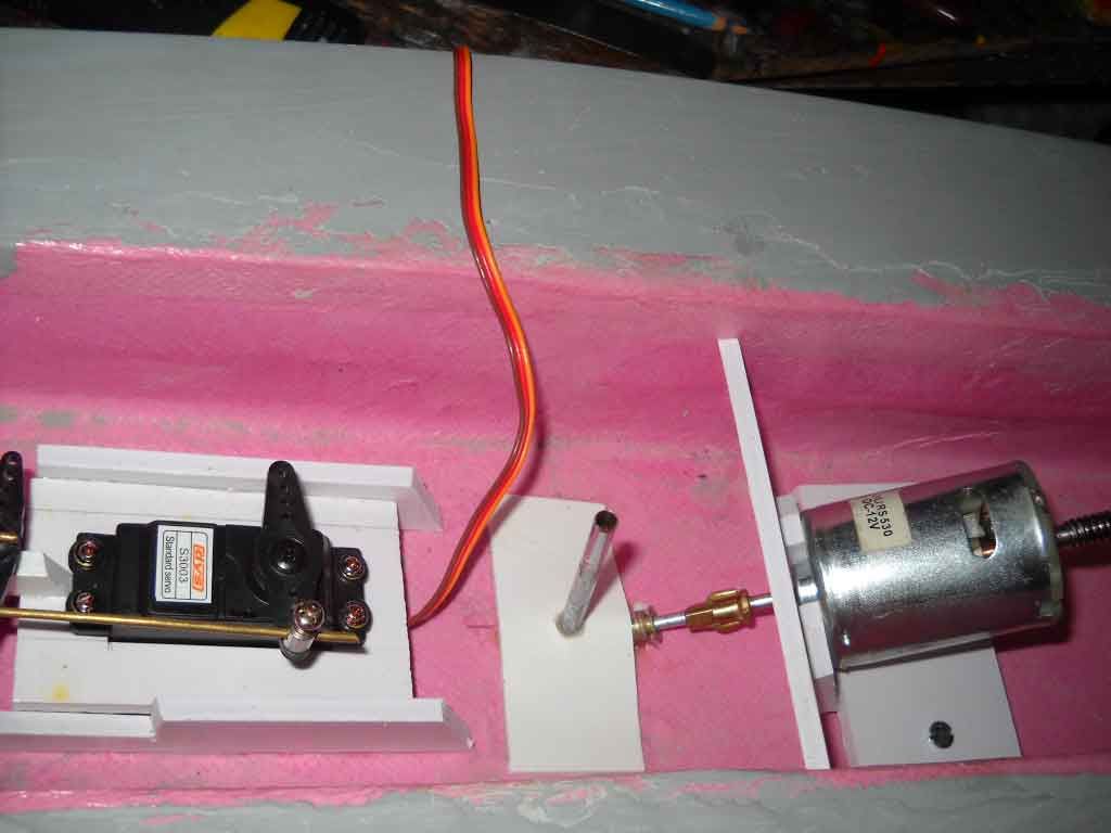

she is powered by a brushed motor..

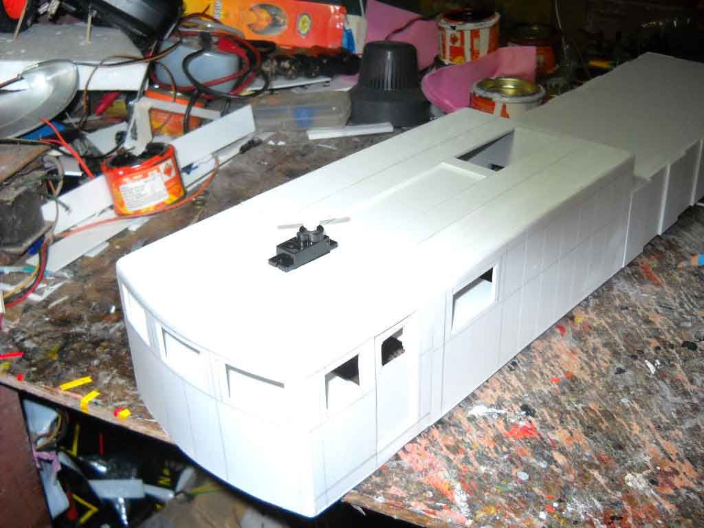

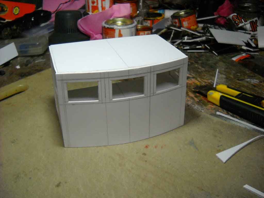

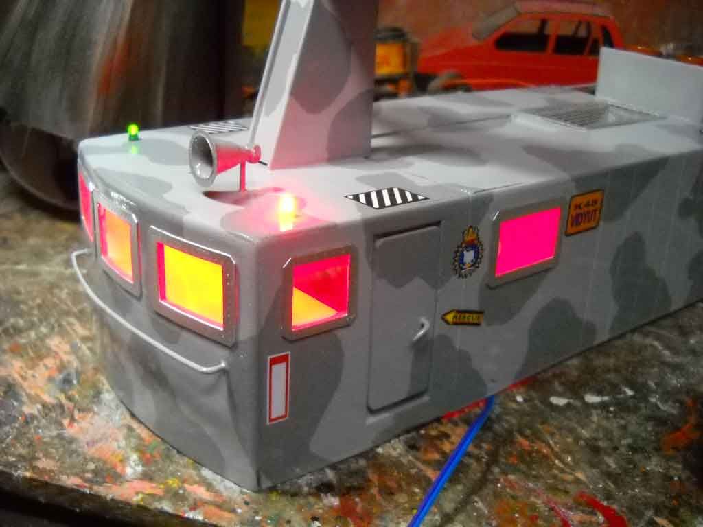

superstructure are papers..

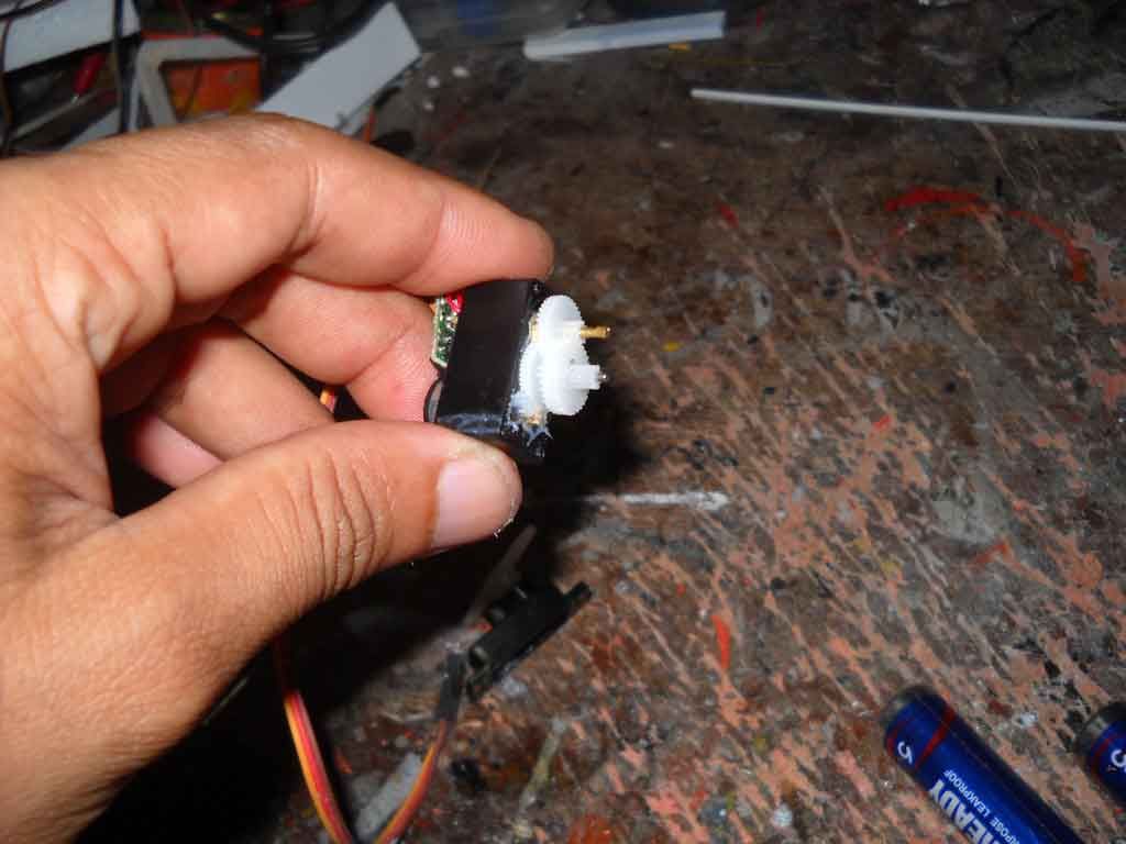

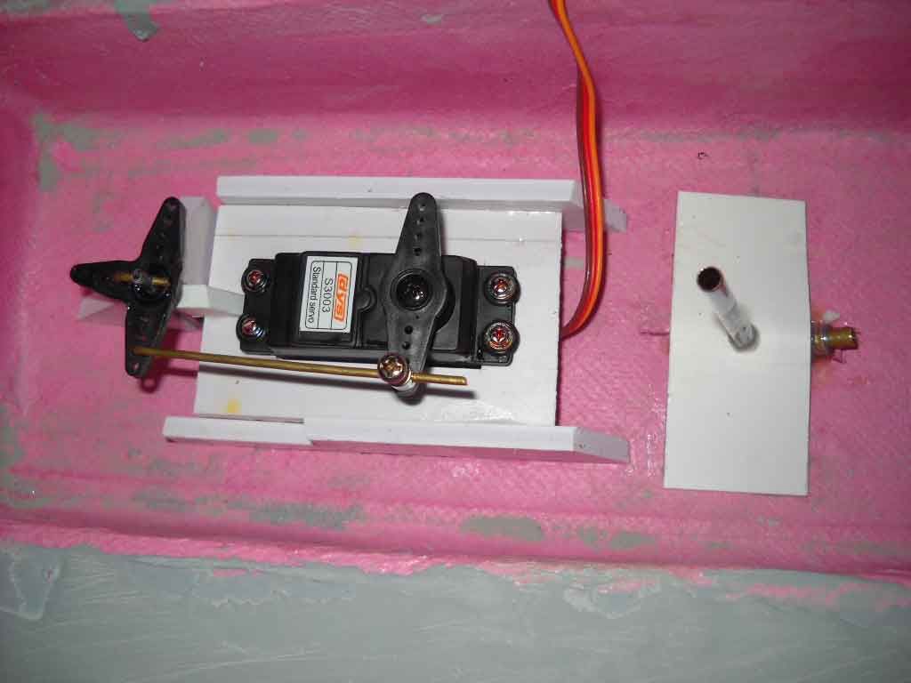

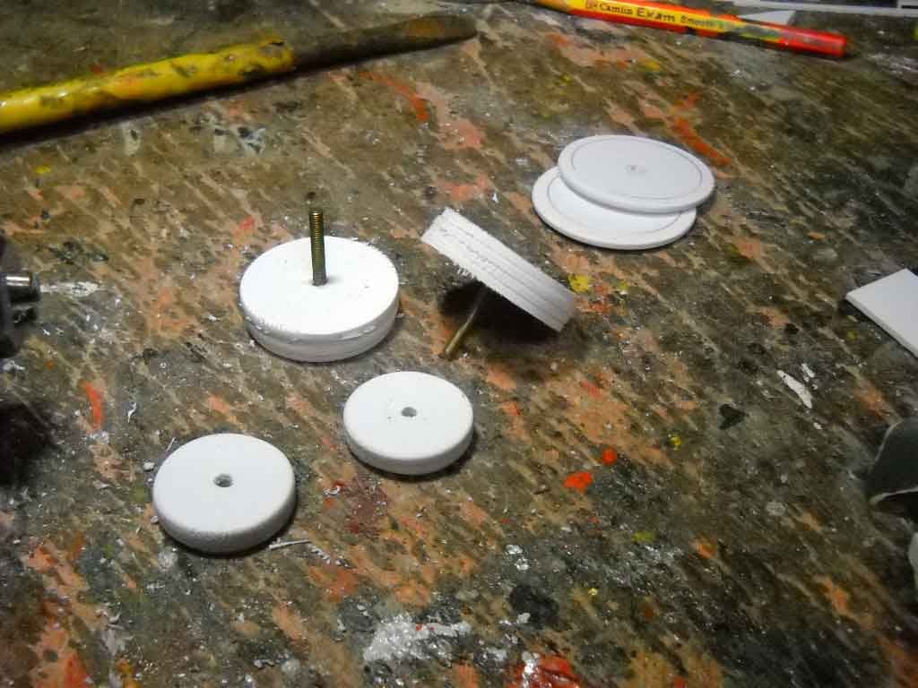

radar rotator was made of a reworked servo, in to continuous rotation…
on hull…

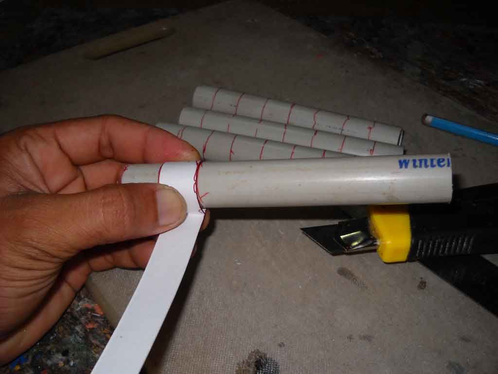

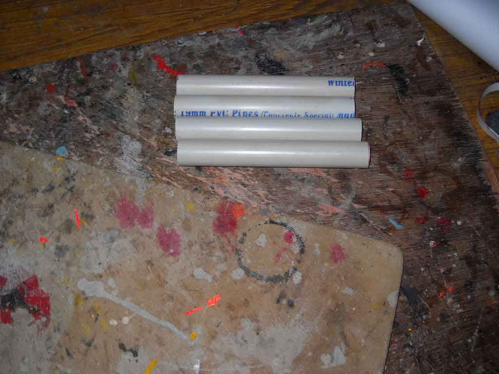

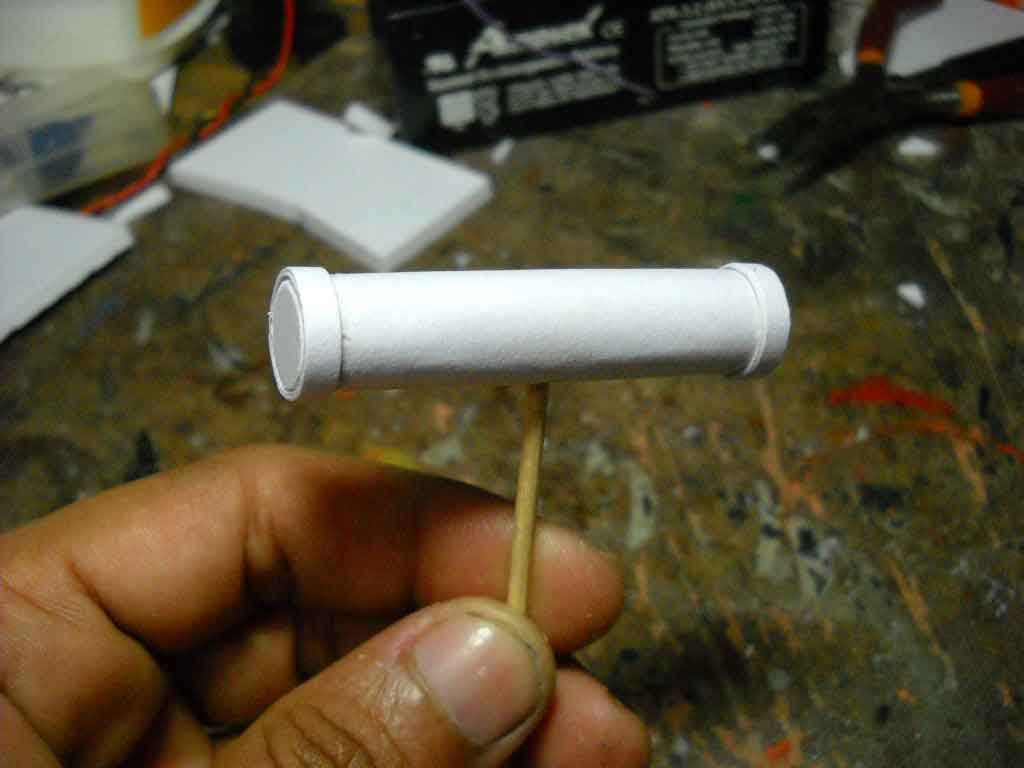

all missile tubes are made of PVC pipe..and detailed with paper…

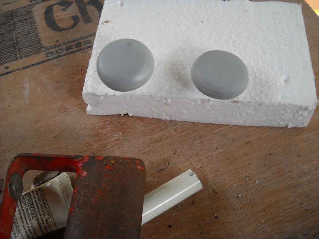

painted with off silver, by adding lots of strained clay powder and little talcum powder..

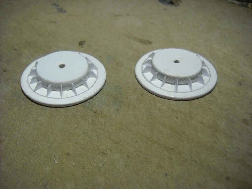

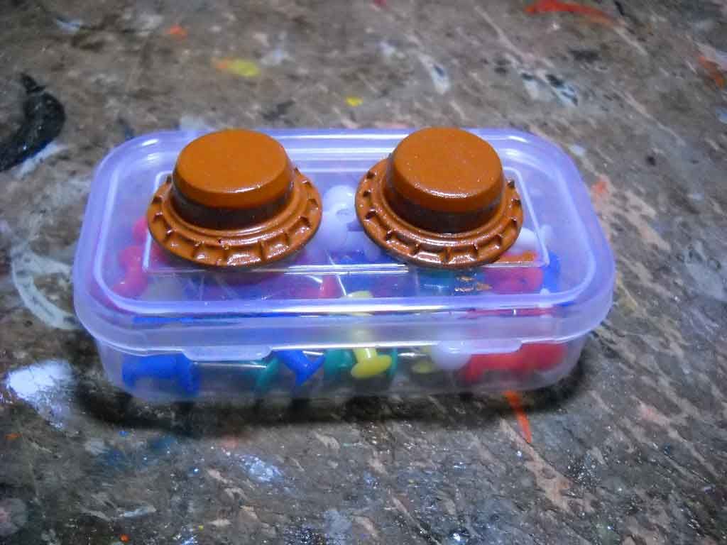

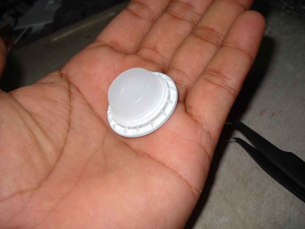

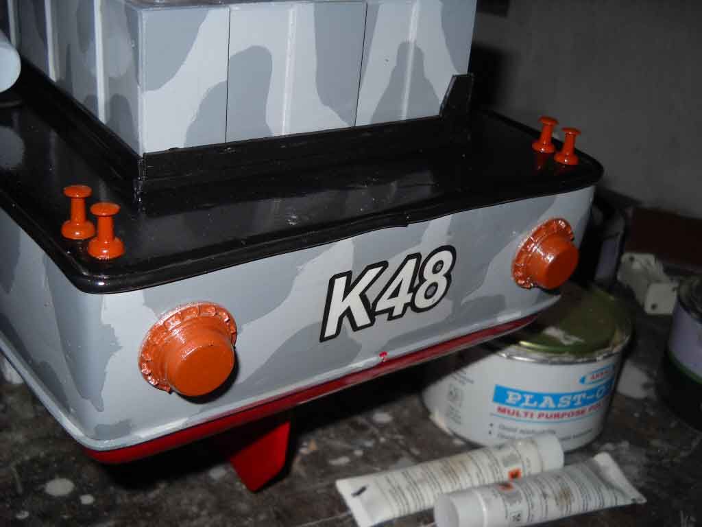

aft hatches are made of foam board and a plastic can cap..

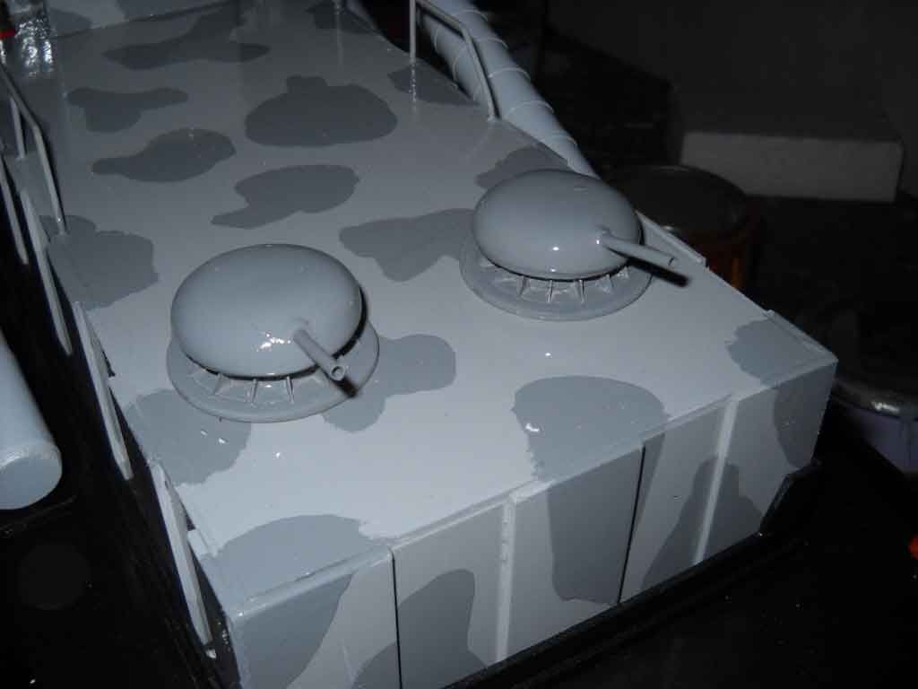

gun turret is also foam board and worked with NC putty…

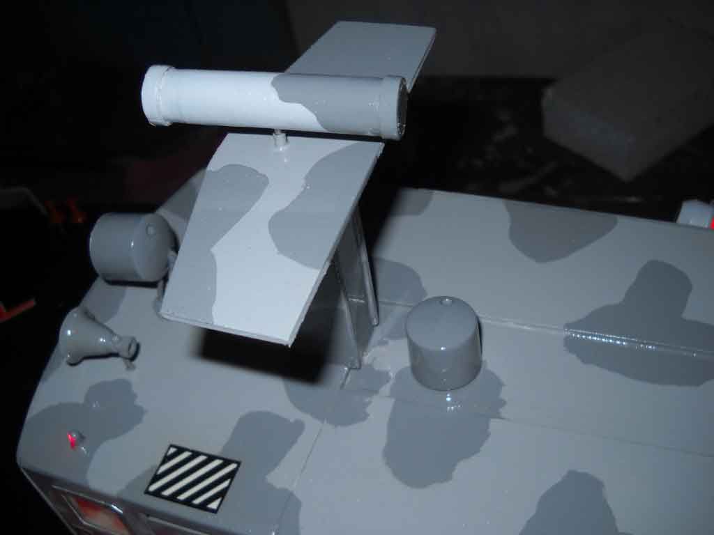

radome …paper roll…

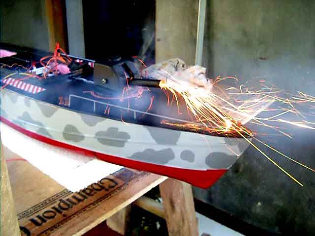

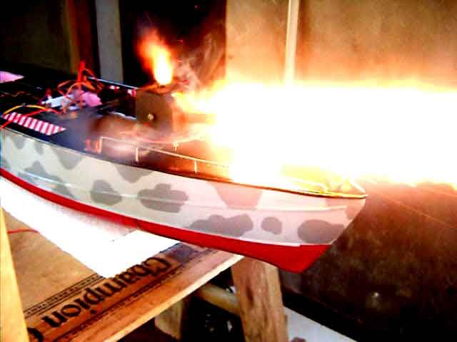

really firing gun..made of foam board and reinforced with alum sheets and rods..

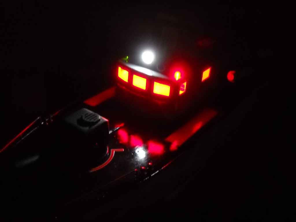

all internal lights are high intensity L E D s..
and she is ready for the run…
test time of gun fire…
