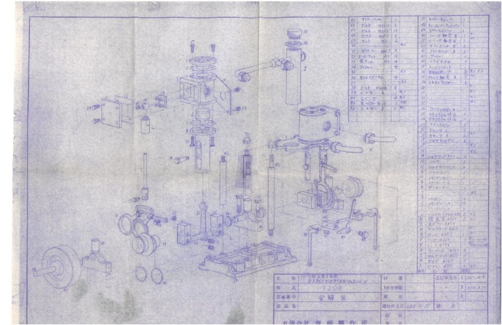

                          with regard to the thread and my earlier typo where I typed 1/8 instead of 1/16 for bsp, and also having read on several forums the most likelihood is that this particular thread is a 7mm fine thread. If the gent wishes he can try an 8mm tap in the hole, but my thinking is he may destroy it… can anyone read Japanese? The following image is of a drawing of the engine with parts – but its in foreign language to which I am not privvy also working on a lot of Airsoft guns from Japan for my son – I know some of these threads can be way off the standard mark.
                          aye
                          john

                            I don't know about Saito, but some Japanese Metric is different from the rest of the worlds Metric.
