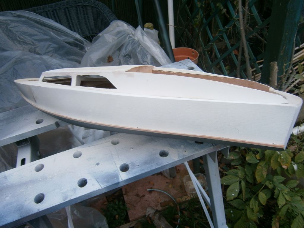

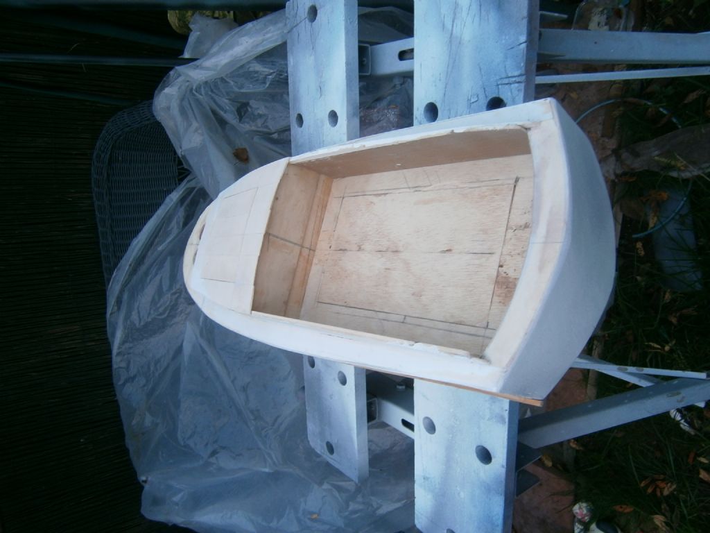

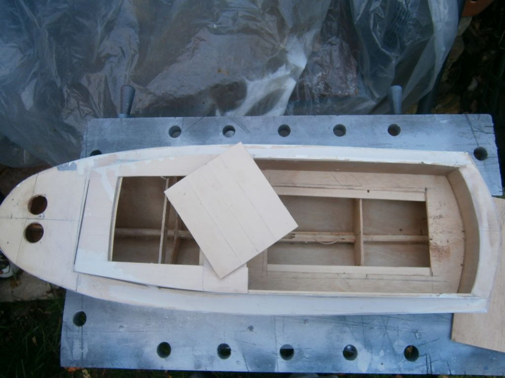

                                #37222
                                LARRY WHETTON
                                  @larrywhetton68737
                                  here you go
                                  #37223
                                    Larry…..Nice to see you making good use of datum centre lines and squaring up where necessary……..Essential for marking out and build accuracy
                                    There`s nothing worse than a "Banana Boat"!
                                    Your model looks excellent

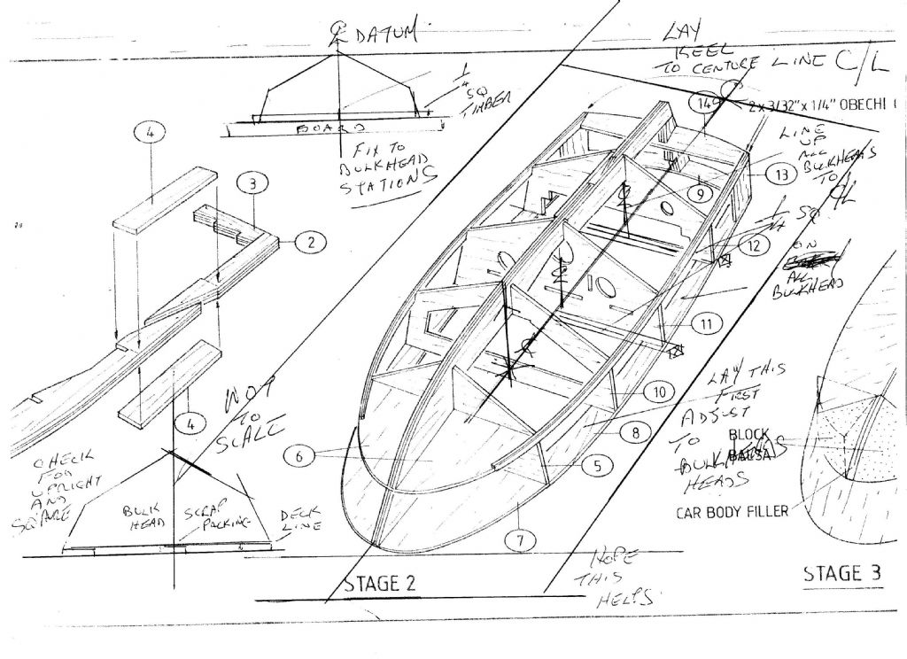

                                    #37231
                                    LARRY WHETTON
                                      @larrywhetton68737
                                      Dave,
                                      a sketch of build board lay out, as Bob made the comment , dont buid a banana boat check line and plumb, if you get stuck ask , build board 001.jpg
                                      Larry……
                                      fix 1/4 sqare to board at bulkhead stations with screws , fix bulkheads to s
                                      1/4 sqare with small clamps ,  remove when all timber and stringers are set and finished , and ready for skins …….
