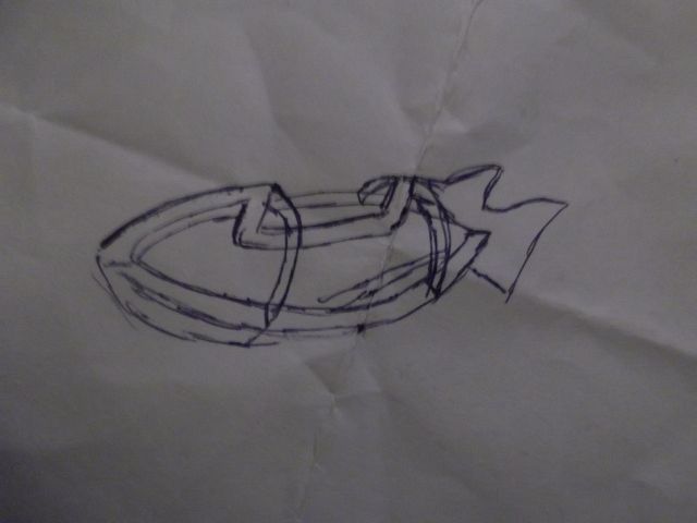

                      #47777

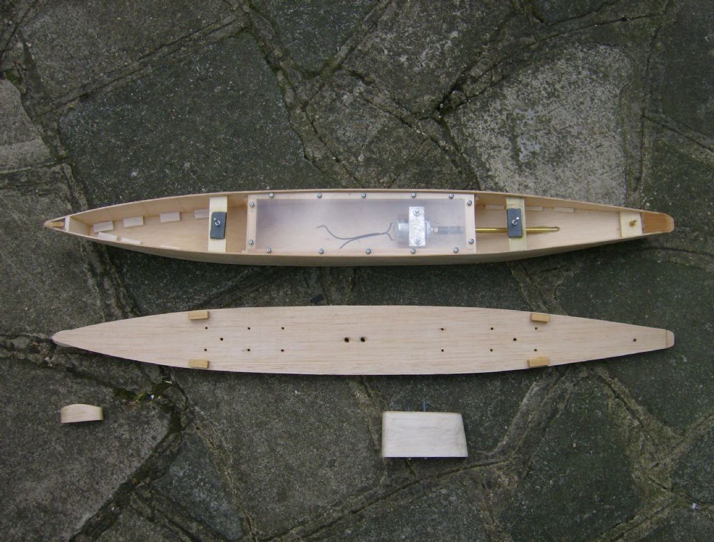

                        Andy.  Pauls method, as he has described it, is in essence exactly what I use.. the three view drawing blown up to the size of boat that you will be making.
                        You can get clear acrylic tube and domes to fit on them in a wide range of sizes. This would give you a line at the joint at the top, however if needs must. (EMA model supplies, check website)
                        I was using a coke bottle a "for instance", but its one of those things..it may be that you try it and look hard and see that it indeed does have potential.
                        Waterproofing the machinery space will be your issue. The hatch method works well, the gubbins and ducted prop can bee in one section and the rest of the craft could plonk on top,. If you are not fussed about diving then the body can be Styrofoam (EMA), easy to get a good shape. ballast will be needed, but only to keep it upright.
                        Picture, my sub, the top bit is underneath…this is the only bit you see when it is in the water. It would be very easy to adapt this for your vessel. Second picture, alternative top.. this could be the Gup-b ?
                        oberon submarine #2
                        shark!#2
                        Edited By ashley needham on 23/03/2014 13:34:21

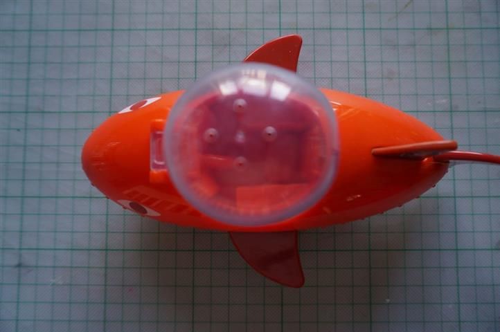

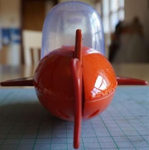

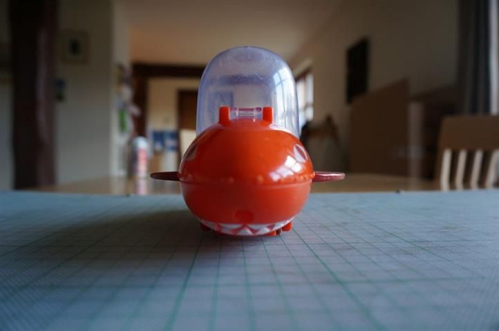

                        #47806
                          Hi Andy

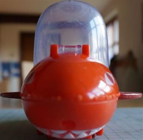

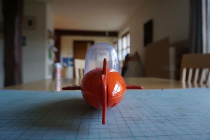

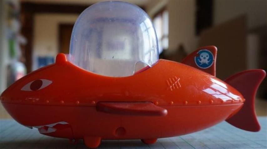

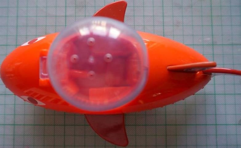

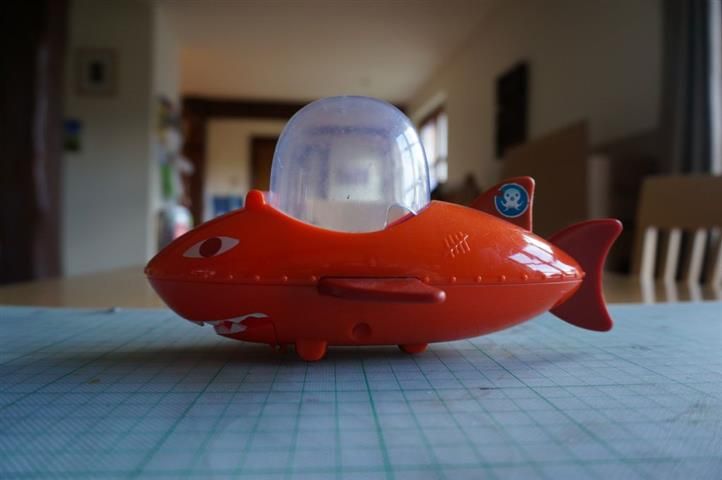

                          This is how I would start this project

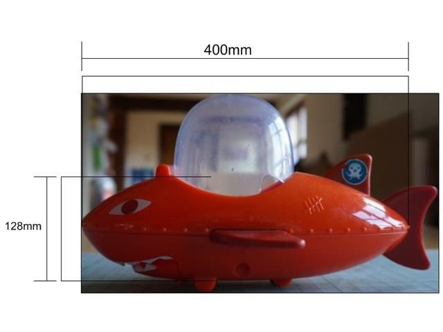

                          Take square on pictures of the top, side, front and back (exactly as you have done)
                          Then crop them to remove the excess material
                          507508r1 (small).jpg 507509r1 (small).jpg 507510 r1 (small).jpg 507511r1 (small).jpg
                          The images can now be manipulated (expanded) to make them the right size

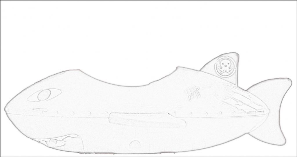

                          Now the images are the correct size they can be traced to produce line drawings
                          These line drawings become the basis of the design drawing.
                          More to follow tomorrow.

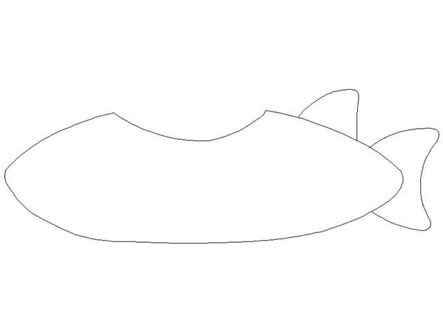

                          #47819

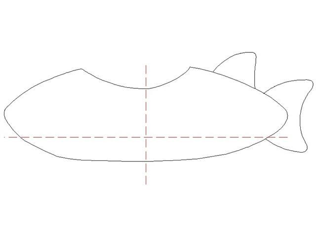

                            The line drawings are tidied up and reduced to the bare essentials.

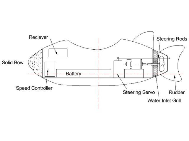

                            The next stage is to make sure that all of the equipment will fit within the hull, the problem with Gup B is that the hull is shaped like a squashed rugby ball and has very little internal space.
                            This is a good time to work out the projects centre of mass (sometimes incorrectly called the centre of gravity) so that the equipment can be positioned correctly.
                            The equipment should be drawn full size and positioned in its ideal position i.e. keeping the heavier objects lower down.
                            It is important to carry out this procedure before you start the detailed drawings as this will allow you to see if the equipment will actually fit within the internal void because if it doesn't you might have to increase the size of the hull.
                            This pretty picture is NOT drawn to scale and has been produced to show the internal equipment located in its possible best positions.
                            After this has been done and the equipment size / locations been confirmed the project can move on to producing the detailed drawings.

                            #47845
                            Andy C
                              @andyc56856
                              Hi Paul

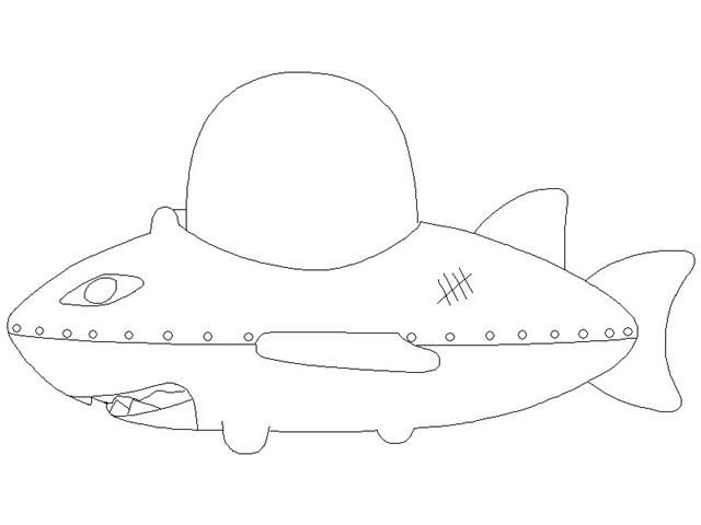

                              that is amazing. I am getting to grips with PSE 7 and have produced this;

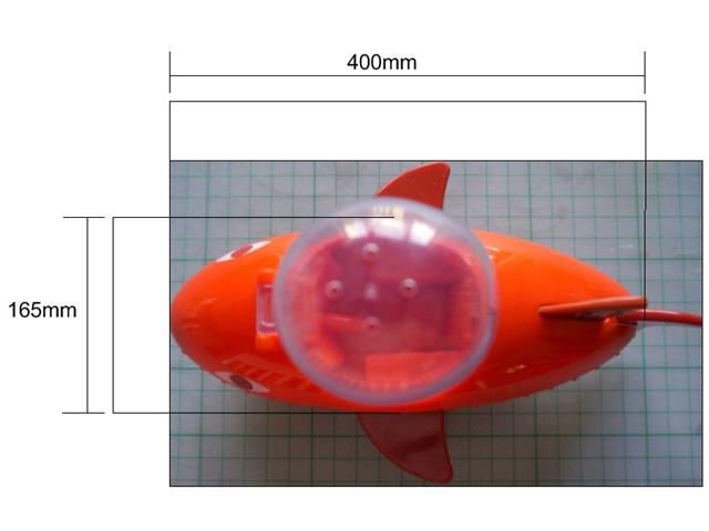

                              #47855
                                Hi Andy
                                So far so good, the next step is to manipulate the drawing to make it the correct size.
                                #47857
                                Andy C
                                  @andyc56856
                                  Ok, as per PM, I have 2 versions, 400mm and 500mm. I think 500 would be better as looks like it gives more room inside. I guess it would also make it easier to cover with a skin. I will investigate the article about 3rd person whatyacallit and see if I can transfer my line diagram on to it. Will post a piccy of the results.
                                  Cheers
                                  Andy

                                      Don't forget to make sure all of the RC equipment will fit in the 500mm model before you go any further with producing detailed drawings.
                                      The problem with Gup B is the lack of internal space as it is has the profile of a squashed rugby ball, the saying 'square peg in a round hole' springs to mind when trying to fit all of the rectangular bits of kit into the curved space.
                                      Then there is the allowances for the hull framework.
                                      Lots to think about before starting the detailed drawings.

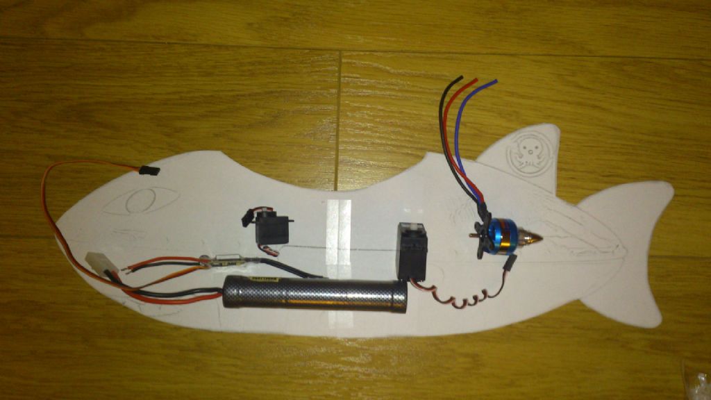

                                        The electronics bit got me rooting around in my spares box. The reason I thought small brushless was twofold, one it's small but I also have one (2826/12) that was going to go in my hovercraft. That is on hold while the builders knock walls out to fit a kitchen in the existing garage and then my workshop / small room at the front.
                                        I also have a std size servo and also a small servo plus associated esc for the motor. I have layed them all out on the drawing below with a rather large Tamco 4200mAh 7.2 volt battery sitting in what would be the bottom of the craft and the other stuff arranged around it.
                                        I know there will need to be bulkheads somewhere in there, but it all seems to fit height wise. The Gup is also wider than it is tall as it is squashed rugby ball shape.
                                        What do people think….. Bonkers or might work sort of?
                                        Cheers
                                        Andy
                                        #47875
                                        Amy jane September
                                          @amyjaneseptember49770
                                          Hi Andy.
                                          No reason in the world why it shouldn't work, go for it!
                                          Personally I would build a simple plywood space frame
                                          fill it in with polystyrene… carve to shape… stretch a couple of layers of stocking over it…epoxy coat… and dig out the polystyrene where ever it wasn't needed.
                                          Soft drink bottles can be moulded over a wooden mould with a hair drier, for a clear dome…
                                          I shall be looking forward to your progress!
