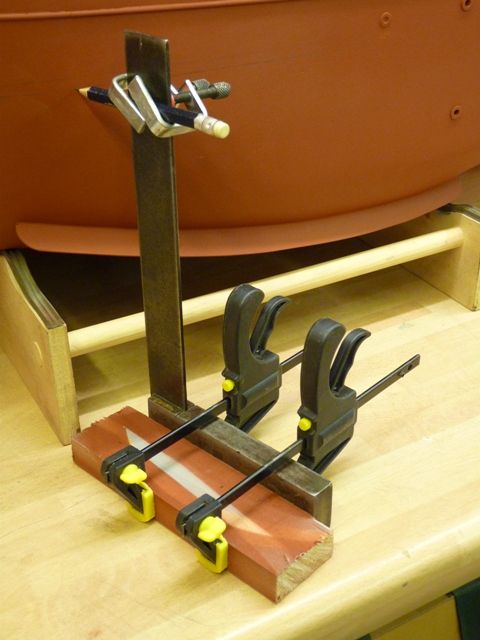

            Hi John,
            I usually mount the hull on its stand on the top of my bench (or kitchen table in your case) so that the waterline will be level. Depending on your stand, you may have to pack up one end or the other using scrap timber so that the angle of the hull matches what is shown on your plans and gives a horizontal waterline parallel to your table top.
            I then make up a pencil holder using a block of wood, square and a few clamps as shown in the photo below.
            The pencil usually has to be angled up slightly to give the best position to mark the hull where it is curved. A bit of trial and error is usually necessary. When you are satisfied the tip of the pencil is at the right height, just slide the whole assembly along the bench and mark the line along both sides of the hull

              I use the same method as Gareth but you do have to be a bit careful with sections of the hull which curve in sharply towards the bottom of the boat. Counter sterns for example.

                I do as Gareth and Colin do, but always mark a couple of milimetres higher (or lower) than required. Why? Well I mask the bit I don't want painted parallel to this marked line (the couple of milimetres difference), so that the paint being applied then covers the pencil line because I have seen a number of models where the pencil line still shows along the edge of a painted section. Use a soft pencil and Tamiya masking tape is excellent, leaving no residue or lifting paint from underneath it. For big sections of the hull, I now use kitchen foil. Easy to 'crush' to shape, impervious to paint and easy to stick to the Tamiya tape with ordinary cheap brown sticky 'car' masking 25mm wide tape.

                  Hi John and all,
                  yes, a very similar method used by myself, I have a hole drilled through the upright timber Gareth shows and stuff the pencil in that.
                  You do need space all about the vessel so that both sides can be done in one sitting, of course, having checked the boat "levels" before during and after the scribing.
                  I have one other check – I use a red laser beam just to confirm the pencil line hasn't drifted, as Colin says, where the hull curves inwards, usually at the stern.

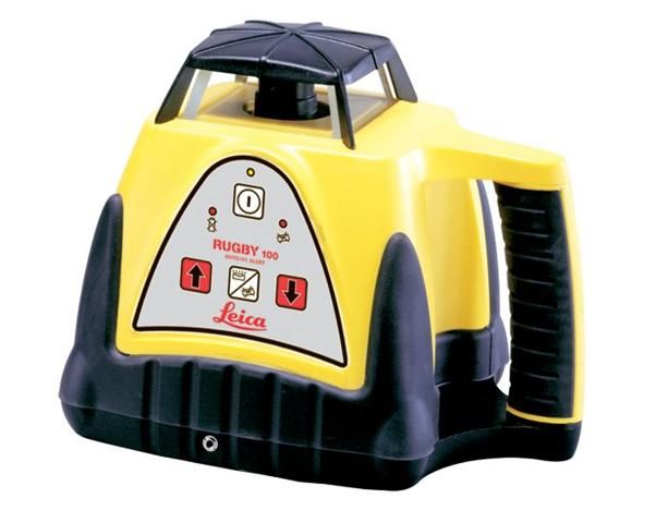

                  #35594
                    The laser line idea is ingenious, I hadn't thought of that. Do you use any particular type Kim?
                    #35597
                      Its a bit over the top but I use a rotary laser level like the one pictured, its a piece of kit that I used in my working days.

                        Colin,
                        I looked and I have two types, one from Black and Decker, single line, tripod mounting with spirit bubbles for all dimensions – solid build and good for the horizontal water line checking. I had an idea to use it for wall papering etc but still use the tried and tested plumbob.
                        The othe came from Maplins – type LS 305 – and has beams at right angles. Unit has spirit bubbles as well and can be used on any flat platform (I bolt it to a tripod as heoght adjustment is much easier.)
