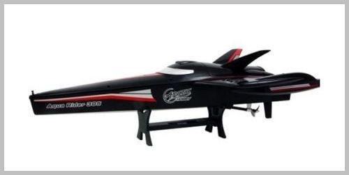

                      Thanks all. I tried her in the bath and she just gurgles (I was hoping it would be that easy). The receiver has 4 plugs on it channel 1 – channel 3 and a battery plug. The rudder will only work in channel 1 so I'm assuming the motor goes in 2 or 3 and I cant find a plug from the battery. The boat is a "ARCTIC Aqua Rider 305" the idea was to upgrade the innards slowly as my son loves the technical part of it all but alas we have fallen at the first hurdle. I have tried to attach some pictures but I cant seem to do it but I will keep trying. Thanks again Kyle

                        Down loaded picture of your boat from e. bay.
                        if thats where bought the boat , it quite a pricey bit of kit,,…
                        i have seen this boat before on my local pool ,…
                        about 4min run time , before the packed and went home….
                        I would stiill return it the seller .. and buy from a UK seller have look at Howes Models good ready go boats there , and at the right price again best of luck Larry..speed boat.jpg
