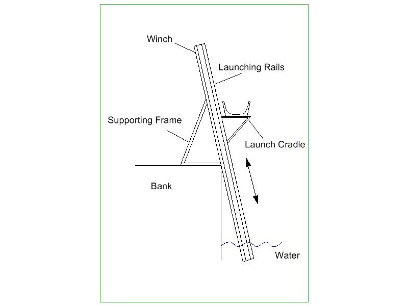

                      Dear All
                      One of Jimmys problems is the 1m drop from bank to water level, another problem (and one that I suffer from) is a difficulty in kneeling and rising from the kneeling position.
                      These problems effectively rule out a traditional cradle type of launching / recovery system due to overall length and weight.
                      In Jimmys case a cradle system would need to be 2m in height to permit working from the standing position. This length of cradle and moving position of mass would create a drastic changing in the centre of gravity when launching models which could catch Jimmy off guard and cause him to pitch forward into the water.
                      What is required is a free standing launcher / recovery system that can take the weight of the model and allows an operating cycle of 2m. i.e. the model can be placed on the launcher at chest height and the launcher carries the weight of the model down to the water.
                      To visualise my idea imagine a 2m length of ladder with a supporting frame so that it can free stand on the bank and then have a bogie / cradle that runs on the ladder and operated by a small hand winch to carry the boat down to the water. Then make the frame collapsible for ease of transport.
                      This design will allow the safe launching and recovery of large and heavy models with a collapsible system that will fit into the boot of a small car.

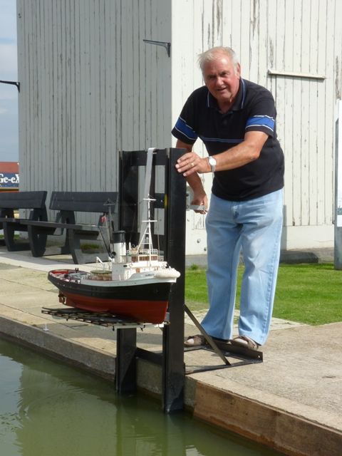

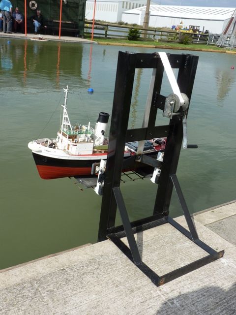

                          #43173
                          Gareth Jones
                            @garethjones79649
                            Paul,
                            What you describe is pretty well exactly what we have at Goole MBC except that ours is bolted to the pondside and not suitable for dismantling and fitting in a car boot. The uprights are made from heavy duty sliding door gear with the boat platform attached to the rollers on which the door would normally hang. It was the brainchild of Harold Sharp one of our club members, who is pictured below with one of his models.
                            Gareth
                            #43174
                              Gareth
                              They are very similar in operation but I didn't want the users to be stretching out over the water to load and unload their boats so I have angled my design backwards and the other obvious difference is that mine is collapsible.

                                Paul,
                                Although the photo may not be clear our hoist is angled backwards as your proposal, although maybe not as much. Normally people load their boat on to the platform over the top of the rails so the hoist is between them and the water. The overall height of the rails was lowered by about 6 inches after the photos were taken to make this easier.
                                Regards
