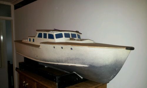

                              vivacity.jpg "Vivacity". My newly acquired model. 4' 6" long

                              #39747
                                Ken
                                Your strimmer engine is probably around 22cc and is easily large enough to power Vivacity, I use a heavy duty servo to operate the throttle and a standard servo for the rudder, being a petrol engine it doesn't need a speed controller.
                                Vibration isn't usually a problem however you can fit rubber engine mounts which are available from some model shops (or ebay)
                                The biggest problem is cooling the engine, you can either convert the present air cooled unit to water cooled or fit some computer cooling fans to push outside air into the hull to cool the engine.(with a suitable duct to vent the waste heat)
                                I hope this helps but if you need any further assistance just ask.
