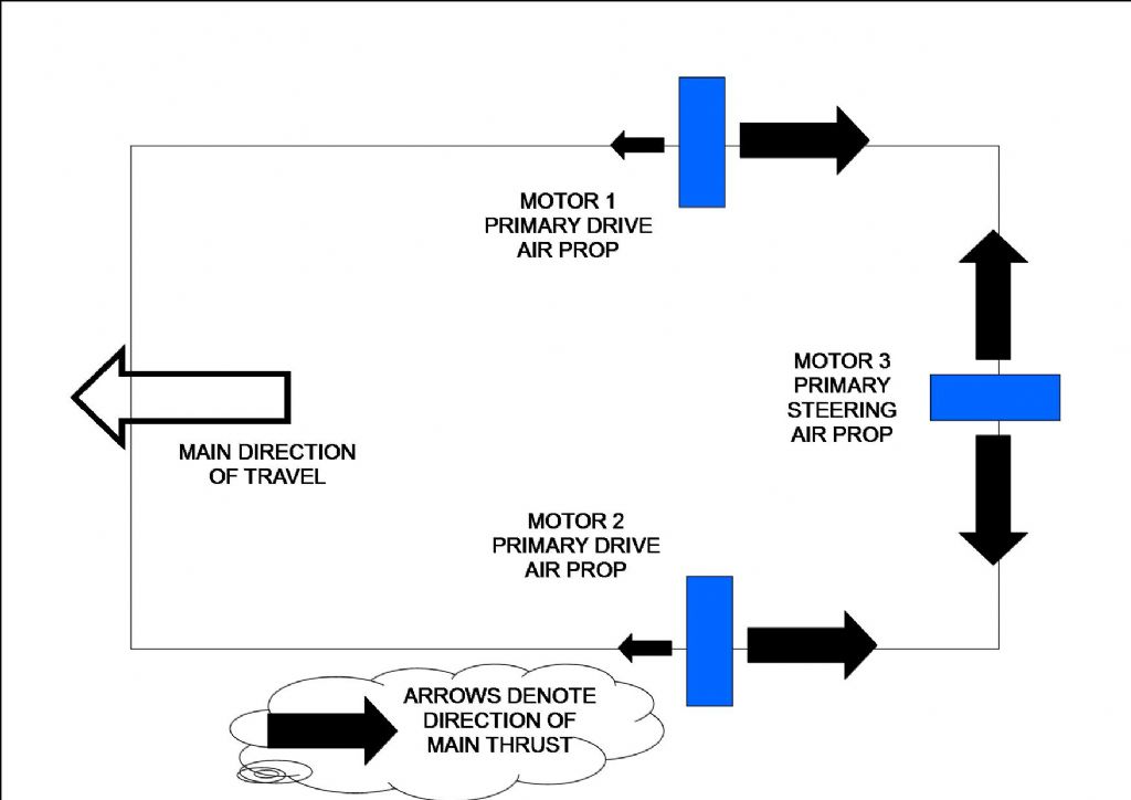

      Dear All
      Can anyone suggest a control system for this project?
      I envisage three brushless motors driving airscrew props for both forward and reverse functions.
      The motors must be lightweight and quick to respond to commands.
      Motors 1 & 2 are the main driving units and motor 3 is the primary steering unit.
      All motors must work in unison when turning as the project must be agile so I am looking for some kind of lightweight mixer or ESC combination that will work through a 2 channel 2.4 transmitter.
      The drawing gives a very basic visual idea of the requirements without getting bogged down in detail.
      All ideas and suggestions will be gratefully received
      #7133
        #77755
          This should do the job. Just connect the steering motor ESC in the place where the rudder servo would normally go.
          **LINK** The PCB is about the same size as the top joint of my thumb and the unit weighs less than 10g without its ABS case.
          You'll need to choose your own motors and suitable ESCs because you don't say just how big/small they need to be.
          #77756
            Thank you for such a fast reply, the unit looks ideal and should do the job nicely yes
