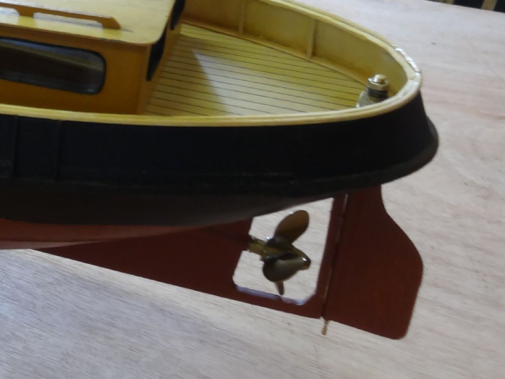

              As is stated on another Forum, the reason I enlarged the rudder on the Guardsman was that I use this model for steering scale regattas and on a lot of these courses, they have a lot of reverse sections in them, this is where you have to sometimes go astern and touch a buoy/go into a dock etc.  As has already been stated on this forum there are not many single screw vessels that like to go astern in a straight line.
              Here is a view of the extension that I made for the rudder to help my model go astern.

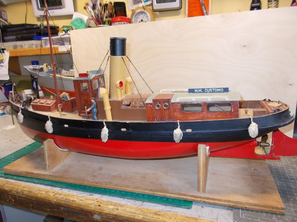

                    Hello Fred,
                    Some time ago, I built this model with a balsa hull. My rudder was a sheet of brass shim, cut to shape and folded over the brass rod. It was then epoxied together and clamped. Any tidying up of the edges was done with filler, then finished with the smooth file and emery cloth before painting.
                    The size was approx. 3mm over what the design shows. This was not really necessary as the handling is good whilst moving forward and what has already been said earlier is correct.
                    The problems I had with the rudder were not the shape, but the linkage. It took three attempts to get it right and they were due to me not removing enough balsa from the stern end bread and butter construction. This won't be a problem with a moulded hull.

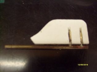

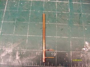

                            I was thinking of using some brass rod with some smaller rod going at right angles to the main rod, then cutting out the shape of the rudder in 1.5mm card which will have the brass rig sandwich in between.
                            Hope that makes sense.
                            Fred

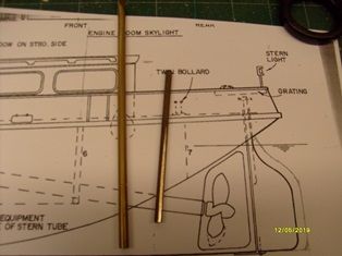

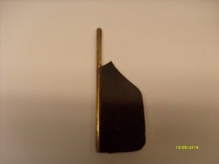

                                Thank you to Richard I am now able to post photos. This is how I went about making the rudder.s7300211.jpg 1.jpg
                                #96921
                                  Lovely job Fred, glad you got the pictures sorted out. You've got the internal strength sorted perfectly.

                                    Fred. Yes nice job, but….Why not just use brass sheet soldered to the shaft?
                                    #96933
                                    Fred Ellis 1
                                      @fredellis1
                                      Hi One and All
                                      Yes all sorted now thanks to you Richard, looking at the photos I think I could have moved the top one up a bit?
                                      Hi Ashley I just did not have any to hand, and it would have been around trip of three hours to Sussex Models, as I had some brass rod and tubing in the scrap bin along with some card, I used that instead so saving me three hours.
                                      Fred
