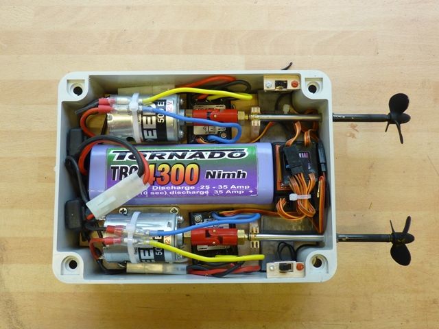

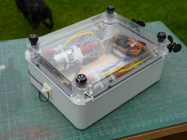

                    Here is the information you requested. Firstly the power unit water tight box with the lid off.
                    Here it is with the lid on.

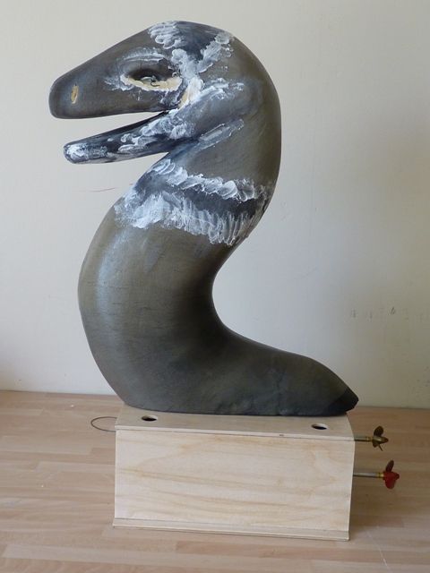

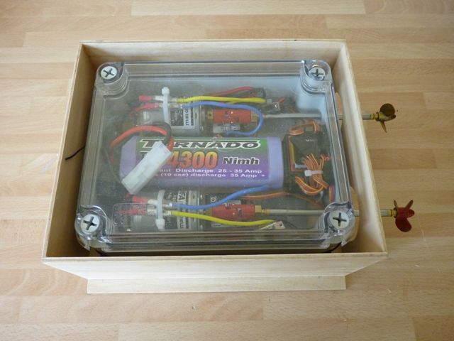

                    Here inside the base unit below the head.

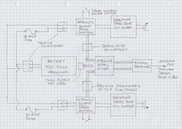

                    Finally the wiring diagram. Not quite up to Dave Milbourn's neatness standard but it should be understandable.
