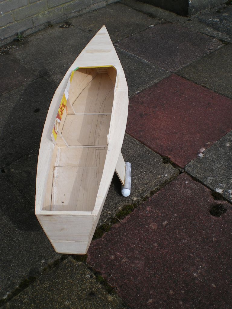

              #39873
              Who Boot
                @whoboot

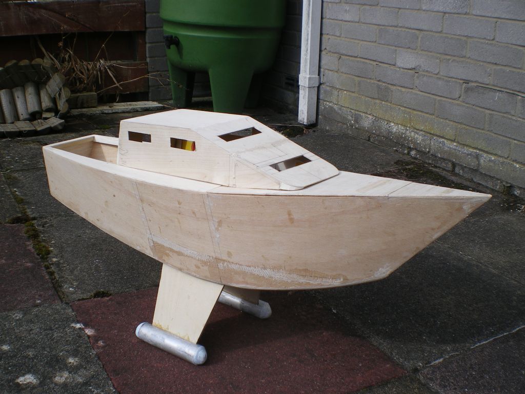

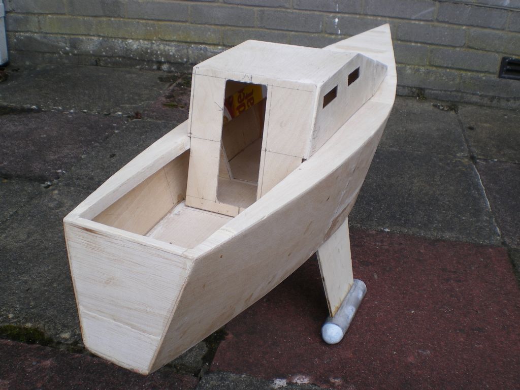

                imgp2290.jpgimgp2287.jpgimgp2286.jpgHere are some photos of how my build has gone so far. My Goblin measurs 33 inches in length, 9 inches in width, and stands 12 inches from the ground. Haydn.
                #39896
                Andy C
                  @andyc56856
                  Hi Haydn
                  Looking good so far. Nice idea about the twin fins, but sorry I cannot tell you much about how they will perform. Nice extension of the cabin too and looks like you have cut the windows out. I painted mine on, as I did not even think to make proper windows. Wonder if I can still do that, might work.
                  For the sails I used an old umbrella and cut the shape of the sail from that. Still used the same method of attaching to the mast, using tape, but I might even try to use Wonderweb as this would be a nicer look.
                  Good luck and keep us all posted.

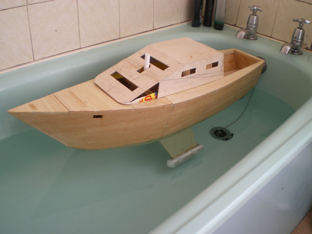

                  #40174
                  Who Boot
                    @whoboot
                    Cabin fittedClose up of mast support tubeGoblin in the dry bathHi Wraith Leader

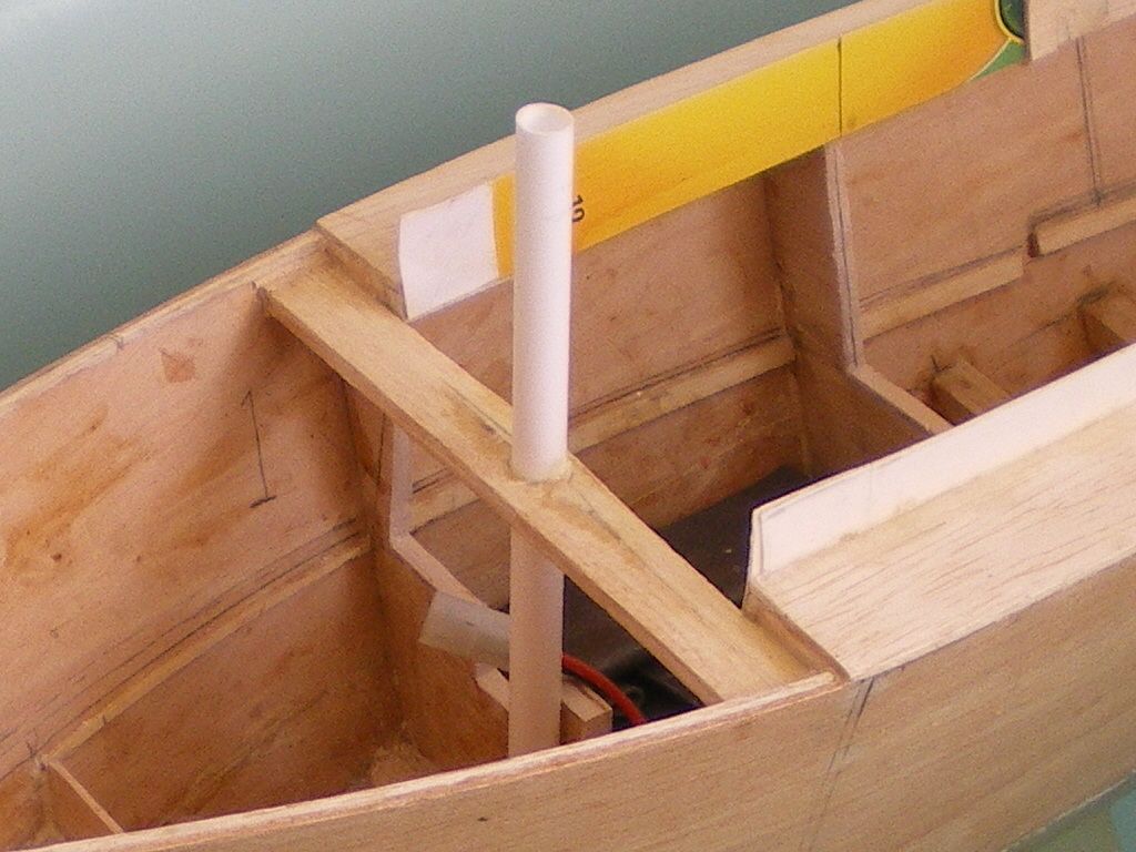

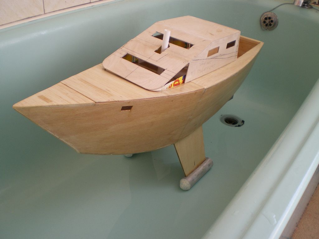

                    Hi have painted sanding sealer on the hull to water proof it and given the boat a bath test. It is not completed but I thought a bath test now would give me an indication of how well balanced she is, as well as testing her for waterproofness. I was very pleased as she passed both these tests. She was floating a bit high in the water but this was good as it leaves ample room for the weight of more fittings and equipment to be installed. Here are photos of the mast support plastic tube, and the bath test. When the water receded down the plug hole the fins acted as a stand when she stood on the dry.

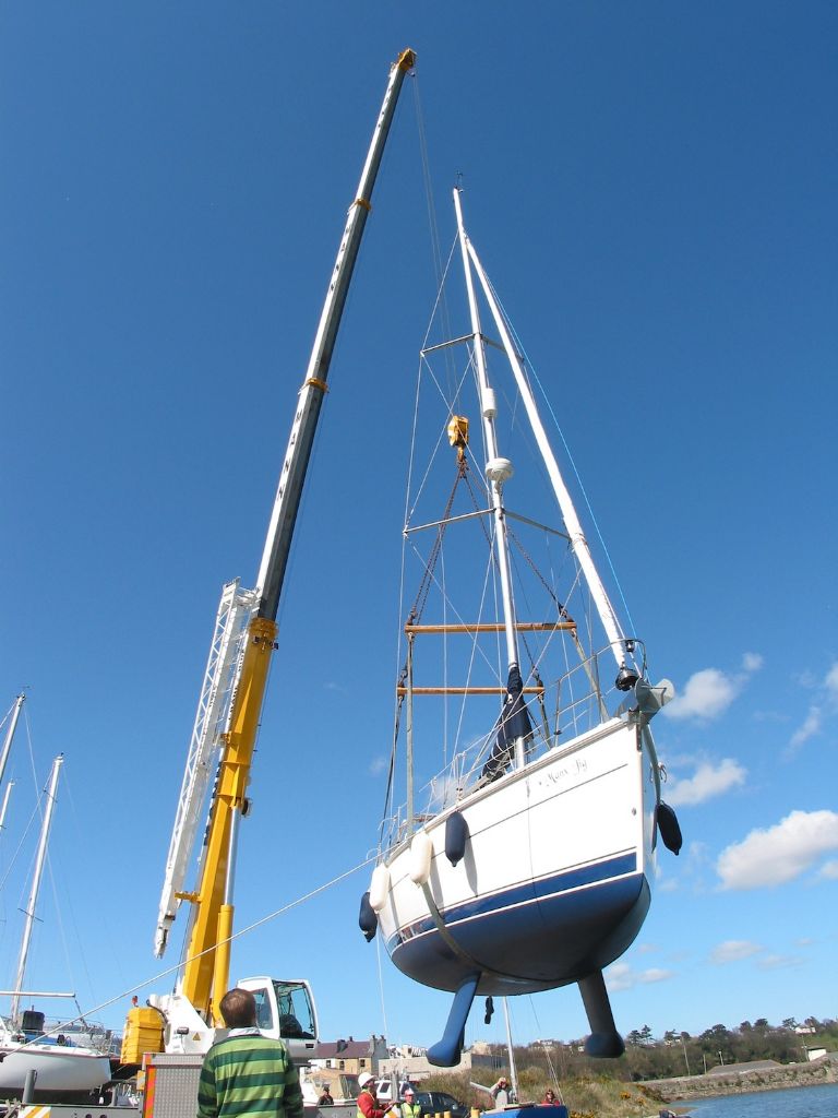

                      just thought I'd say looking good, don't know how she'll sail but be nice to find out. Just for information, the yacht pictured below (from below) is a local boat which is currently in Greece, having been sailed all over the Med etc. Twin keeled yachts sail very well in deeper waters, but as you say, can take the bottom very well so are not dependent on a nice bit of harbour wall for support.
                      This yacht is about 45 foot long. Happy sailing, Kimmo.

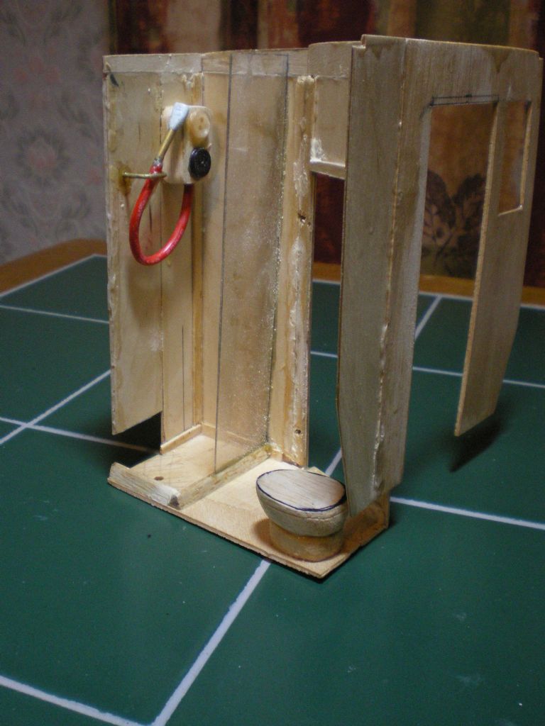

                        Bathroom suite in GoblinKitchen furniture to put in Goblin

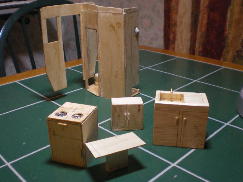

                                I enclose photos of Goblin's kitchen furniture and bathroom suite, before painting.

                                    Above, I enclose photos of Goblin's bathroom suite and kitchen fittings.
