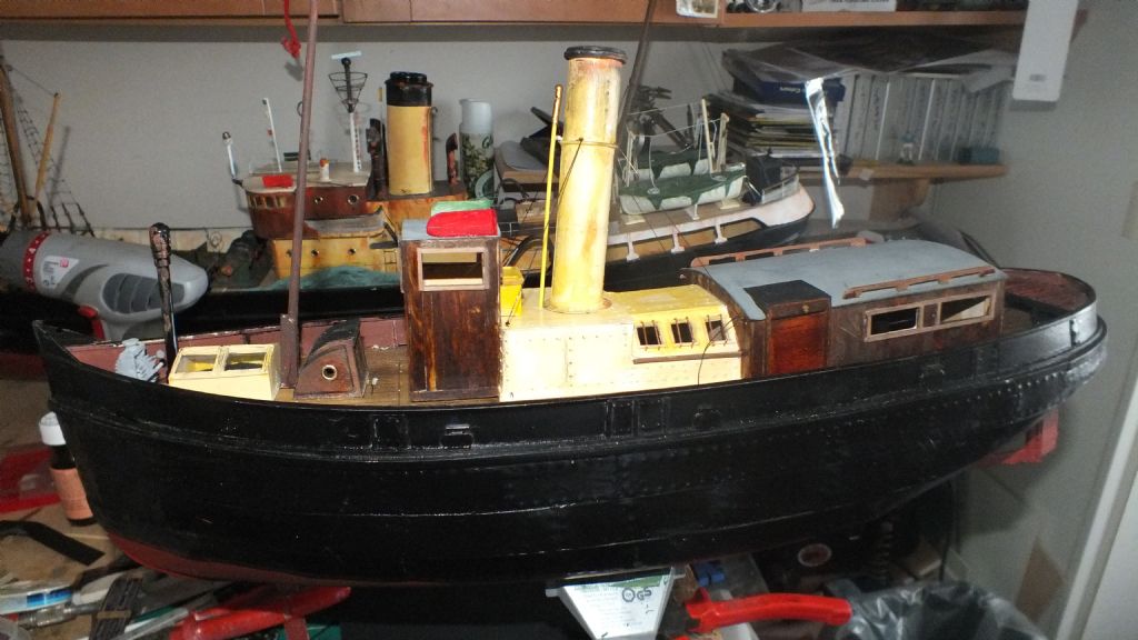

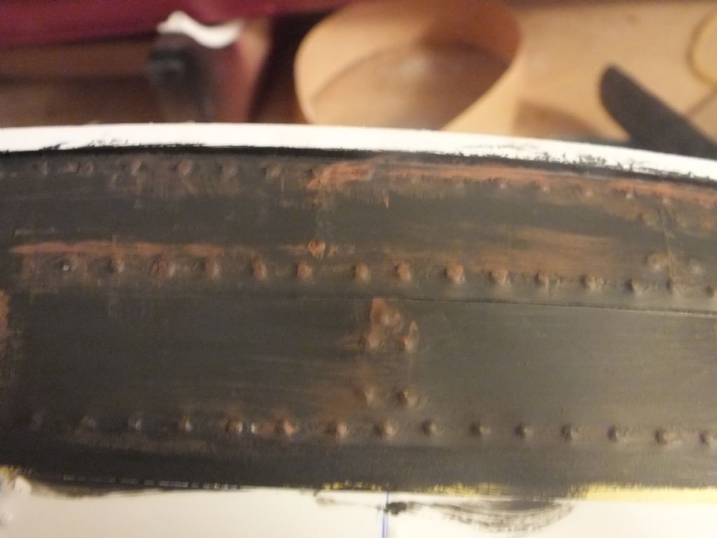

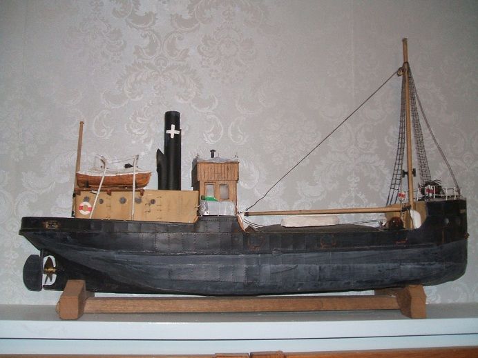

                      boiler & boats 006a.jpgBuilders 2" insulason used for these models work OK 001 (3).jpg
                      Edited By geoffrey yarham on 11/01/2013 22:55:42
                      #38673
                      hammer
                        @hammer
                        The photos above show the constrution method I use & a completed model. I use 2" insulating foam board with silver card on each side.
                        First step remove silver from one side, then make the board the thickness of the spaceing between frame centres. Either adding extra layers or sanding down. Mark out half frames on the remaining silverside one each hand, cut out with a saw, making sure the cut is square. Next cut the profile of the boat from 5mm ply, mark the frame positions both sides. Cut out the middle in one piece, leaving the stem ,keel & stern post, clamp back in position ( one clamp each end at deck level).Start with the largest frame on silver side. Glue to keel and just a spot at the top on the removable middle. Repeat on both sides forward & aft, always with the silver on the largest side of each station. It is then simple to sand the blocks down to the silver. ( I use thixothropic 5 mniute wood glue). I have covered the exterior with car body filler, paper and plates cut from drinks cans, all with good resaults. When the outside is strong enough the interior can be removed ( the clamps removed when the blocks reach them. Geoff

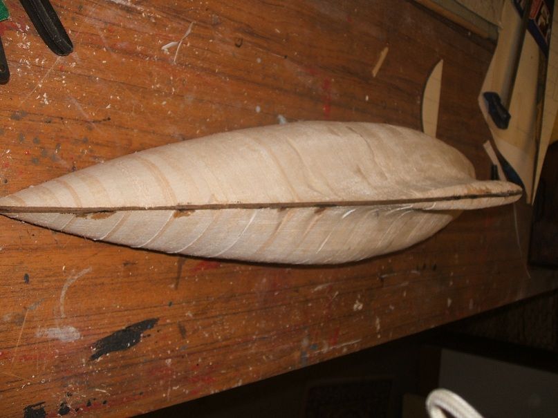

                                        hi thats how l have made my hull for the yacht l have started the foam is so much easer to work with but you realy must use a dust mask and get your self an old hoover as the dust will stick to every thing including you this pic shows mine earlyer on after sanding l gave it two coats of grp tissue with polyester resin keel went on later foam on formers

                                          Thats very nice I hope you found it quick and easy.. Geoff
