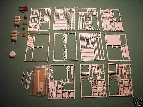

      I am actually in possession of the building kit of the danisch patrol boat Flyvefisken. Unfortunately I’m not in possession of the building manual and instructions. Can somebody help me out ????

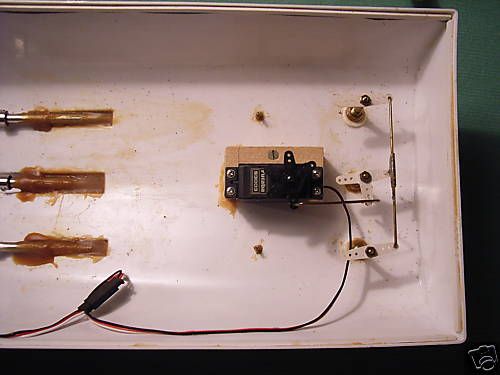

        i can copy these..  there will be no charge, but i think you need to alter things a little to allow enough access to motors and rudders, i think if you follow the plans these are pretty much sealed in – not a good idea

          http://www.modelboats.co.uk/wp-content/uploads/sites/5/images/member_albums/4334/c07e_12.jpg
          http://www.modelboats.co.uk/wp-content/uploads/sites/5/images/member_albums/4334/c398_12.jpg
          http://www.modelboats.co.uk/wp-content/uploads/sites/5/images/member_albums/4334/cda6_12.jpg
          http://www.modelboats.co.uk/wp-content/uploads/sites/5/images/member_albums/4334/c21c_12.jpg
          Thank you very much, For the engines and rudder I did not have any problem, to see photo. It is especially for all that relates to the appearance, the plastics. Excuse me for my English, I am French. Here my co-ordinates:

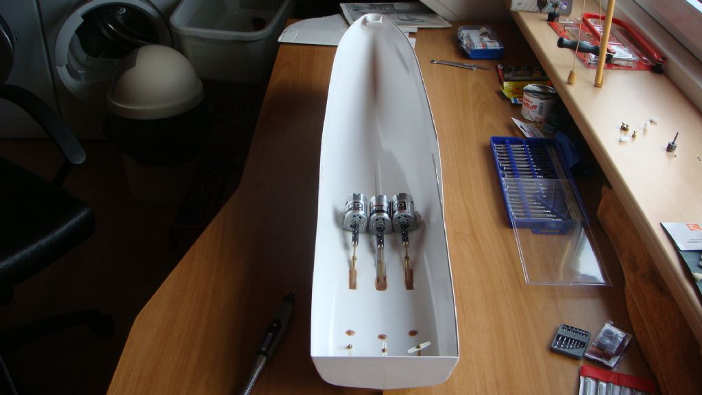

                        I started building the Flyvefisken a week ago. I bought the model quite some years ago and now i finally have some time to work on it. I also included some pictures.

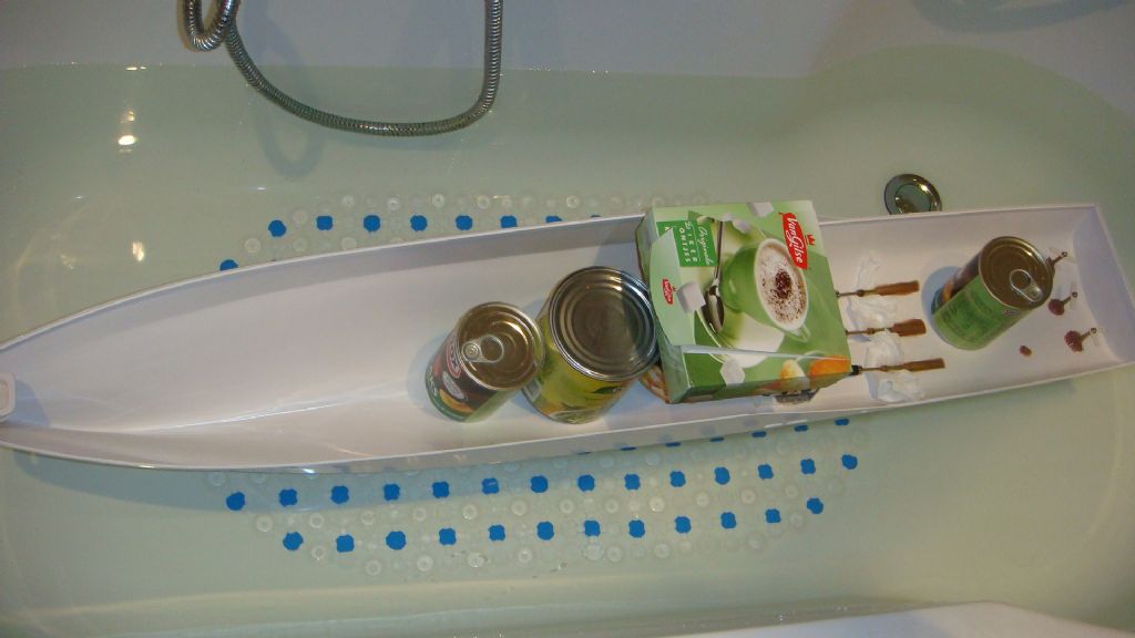

                          Hi all,
                          and one more of the floating test. The weight it can carry is between 3,5 and 4 kilograms

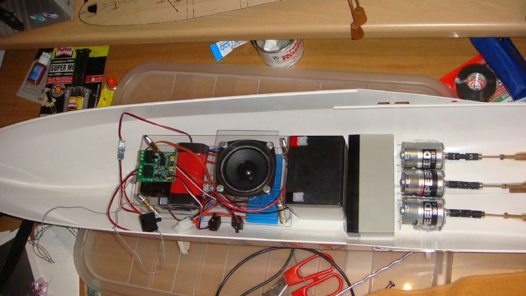

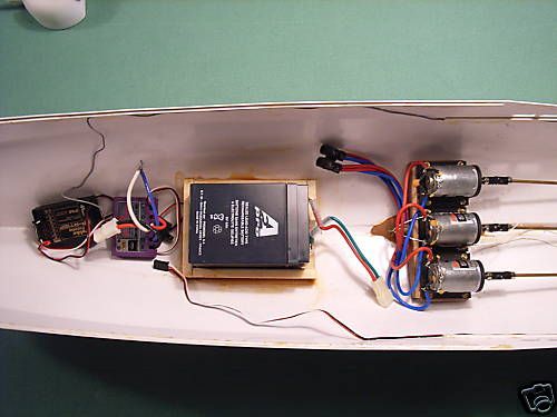

                            Update: electronics

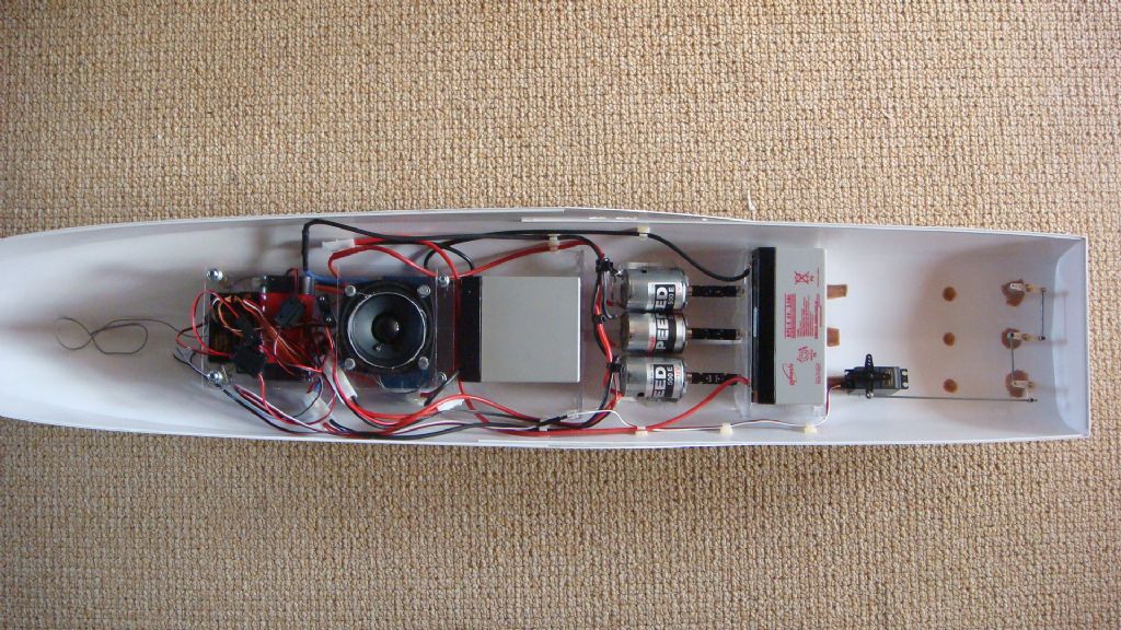

                                    The speaker is mounted high because all of the electronics have to fit in an area of 25 * 10 * 20 cm  (l * w * h). When the boat is ready i will be able to service the electronics because the whole container can be lifted out of the boat. For more detailed pictures of the electronics module see my album.

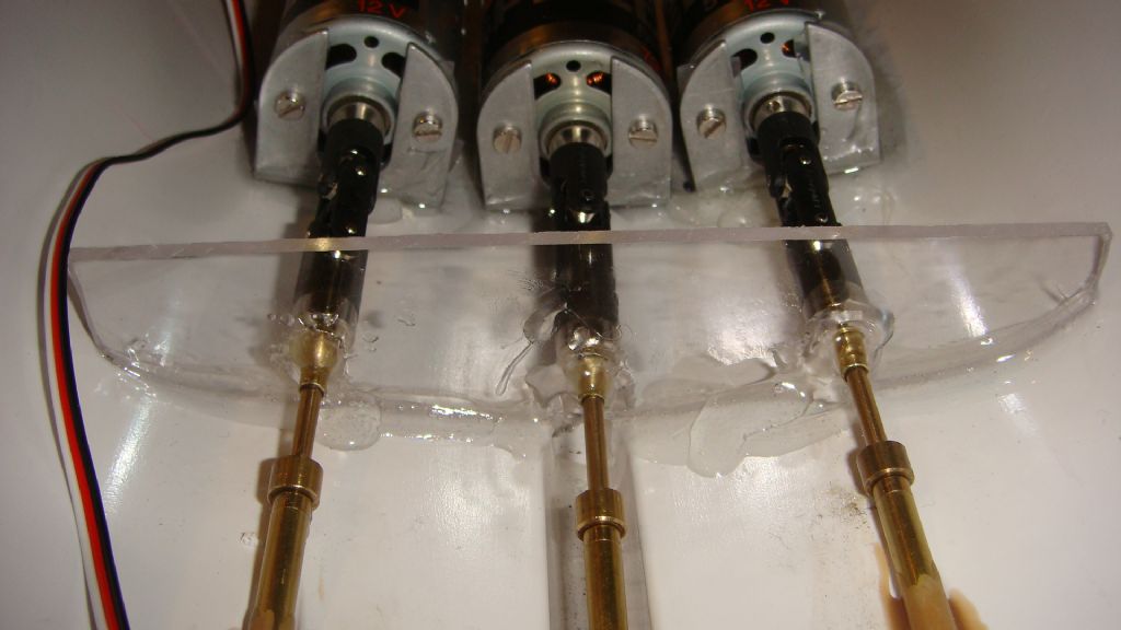

                                    I tested the engines today and had a lot of vibrations (to much). I solved this by adding extra support for the shafts (see picture). Everything is running smooth now. I alsi installed the rudder and the steering is functional. Seems like all the electronics and mechanical parts are functioning fine. I will test the boat in a nearby lake tomorrow.
                                    regards John

                                      Oops, forgot to post picture.

                                              The speaker is for the Robbe Navy sound module. Now the boat can make different sounds like: destroyer siren, engine sounds, ship bell etc. There is no room for a spare battery. There are three batteries on board. A 6V-3Ah battery for the middle engine, a 12V-5Ah for the two outer engines and the sound module and a reciever battery (The red one in the electrinics module).
                                              I tested the boat today and i am very pleased with the performance but I lost two of the three props . I forgot to fasten them enough. I learned that the weight distribution wasn´t optimal so i changed the lay/out of the ship (see picture)

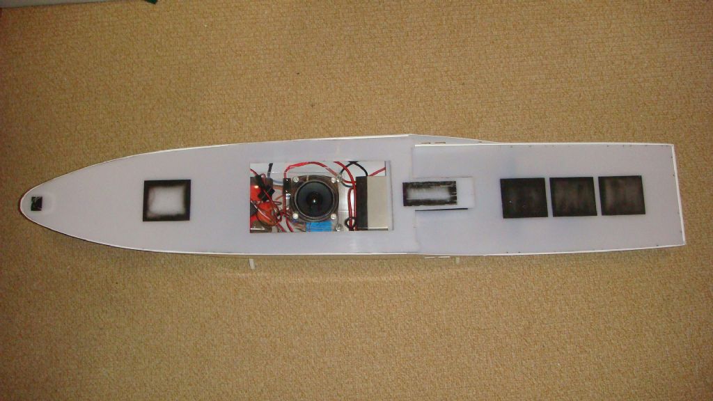

                                                Although i really should be working on adding small details to the hull and electronics module i decided to fabricate the deck (The picture shows a dry fit of the work in progress). The kit included wooded decks but they are of the wrong size. Also i will heavily modify the rear deck in order to be able to service the rear battery and rudders when needed after th edeck is installed.
