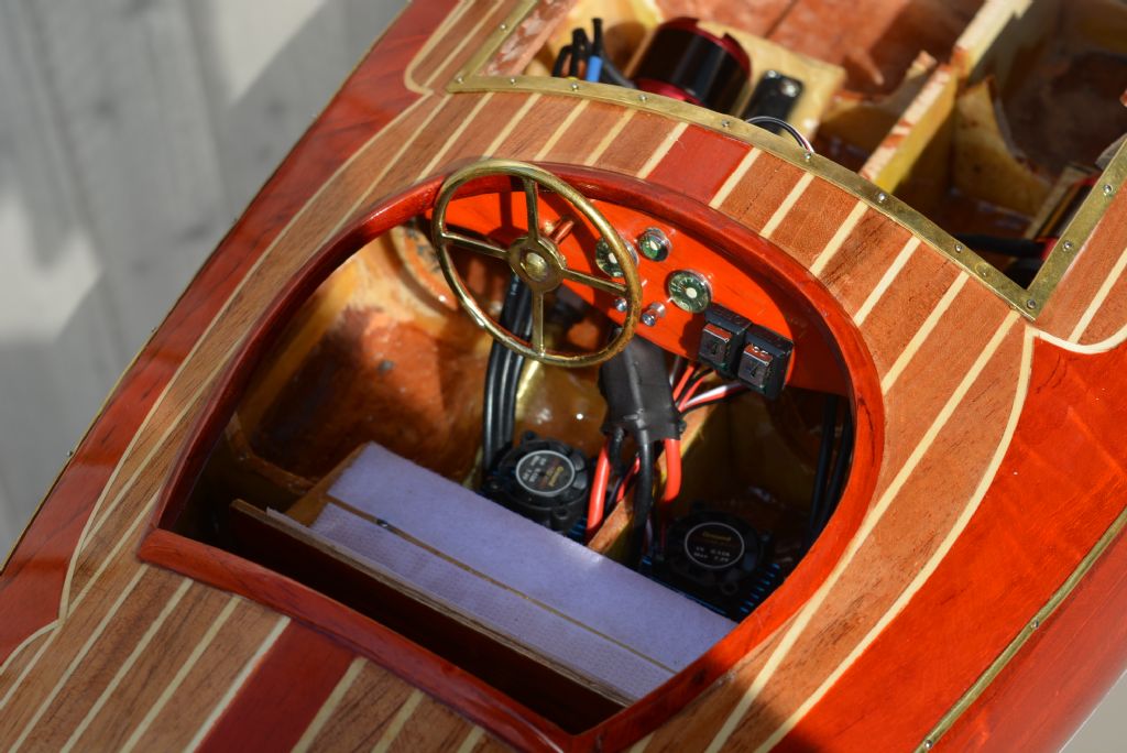

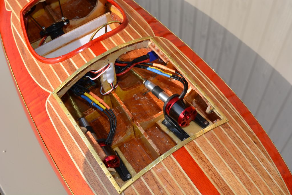

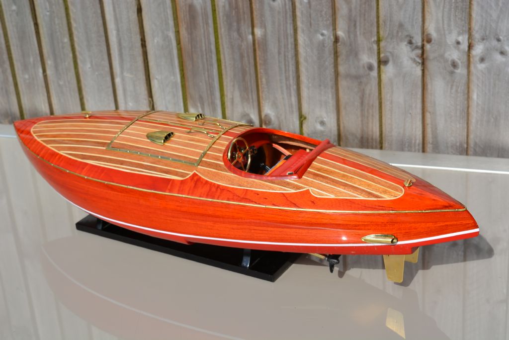

      dsc_0286.jpgdsc_0279.jpgdsc_0278.jpgBruce Crandaall designed the FLYER in 1935. It was a C class 15 foot racing hydroplane. The model I purchased is made by the Vietnam company Gia Nhien aand is capable of having RC installed. Nick Brraghn fromHertfordshire England installed the running gear and Radio Control systems. 193speedboat.jpg

              Nick ouyfitted my boat with these components
              2 Leopard Outrunner 1520kv motors
              2 Leopard 60amp ESC and Y lead to pair them.
              Standard 2.4ghz radio set
              11.1v LiPo 5500ma battery
              Rudder and linkage
              Hi torque metal gear servo
              Propshaft, X40 prop, Powerflex, Mount and Mount plate
              2 internally mounted exhaust fabs
              This should result in a top speedof 28MPH. The bot has an open cockpit so I rejected the option of using larger props to obtain a top speed of 40MPH
