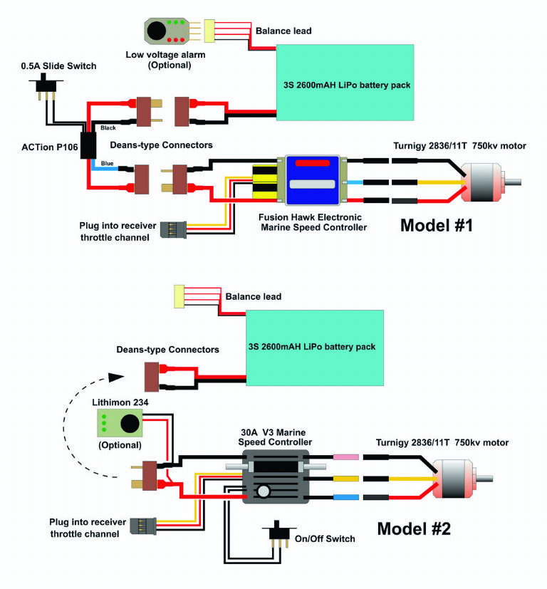

        In the 2017 Winter Special Issue of Model Boats the wiring digram for the two versions of the model constructed by Dave Milbourn unfortunately failed to resize during the production process.
        The article does describe the wiring comprehensively but the full diagram can be seen below.
