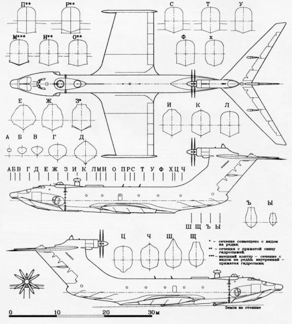

              Hi Paul
              An internet search came up with the drawings shown below. Now to get them enlarged.
              Regards
              Jeremy

                Weight is the key issue here. I built mine as a box section as you need a certain amount of buoyancy, and also a flat bottom gives you the most lift .
                I am not sure you could get the model to skim as it is supposed to without some design changes, and there is an incredible trim change when applying power, due to the leverage of the high motor.
                i did consider at one stage putting a ducted fan unit in the nose, so it would blow under the wings and assist separation, but the practicalities of stopping the nose just sucking up water are too great!
                Using an 11.1V LiPo it is ridiculously fast and leaves the water in the blink of an eye whereupon you lose control…
                Notice the wings are at the bottom of the fuselage…this would create an amazing suction on a model …hmmm..on the other hand , with a LiPo…..?
                The wings need to float properly or else the model will just tip over..high c of g..the drawing has them very thin. I set mine upwards as if they were level there is the chance upon deceleration they will dig in and all of a sudden you have a submarine.

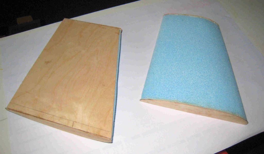

                                                    #32711
                                                    Jeremy
                                                      @jeremy15845
                                                      Wings made from blue foam with a 1mm ply underside and ribs at either end. You arrived at the optimum location for the wings by trial and error. May I ask where you finally landed up in terms of distance (mm) from the bottom of the hull to the underside of the wing at the leading and trailing edges. My model may be slightly heavier, water rudder, larger servo and a 5mm wider body. However, with the wider body, the waterline may turn out to be much the same as yours.
                                                      Jeremy
