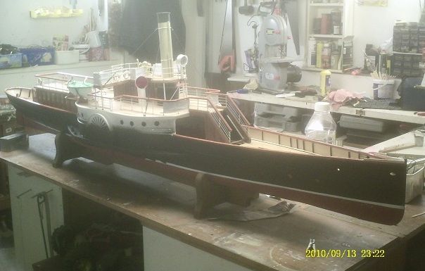

          The present state of play.
          #30344
          hammer
            @hammer

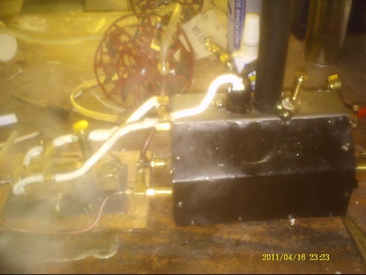

            model completed. Now running in the steam plant.

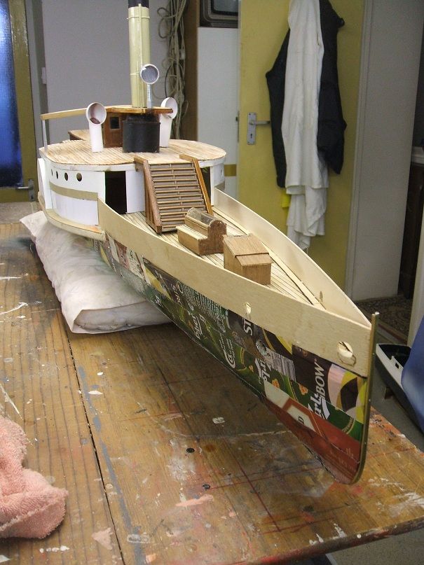

                Bob, sorry for the delay in replying, always busy. Scale 73.75 ins scale 10mm = 1ft. Scratch from own plans. Own design and built boiler & engine. Plank on frame 1/8 balsa, impregnated with resin, then covered aluminium plates (cider can). As I said thread on paddelducks.co.uk under forum, construction, Duke of Devonshire. video on youtube of engine running.
