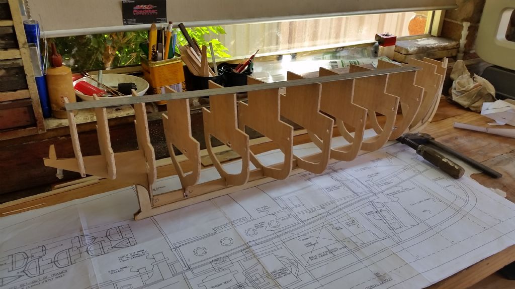

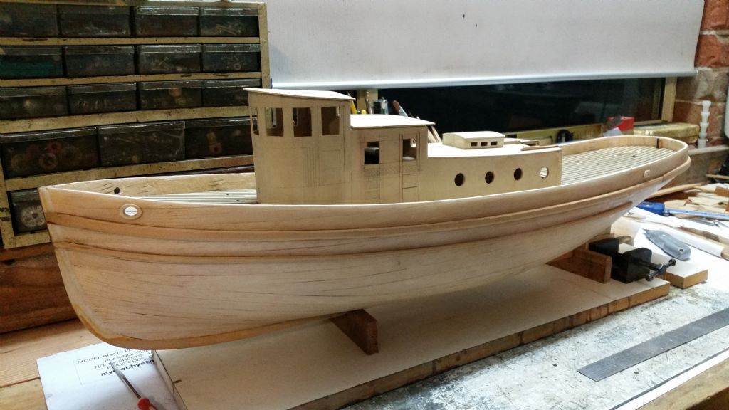

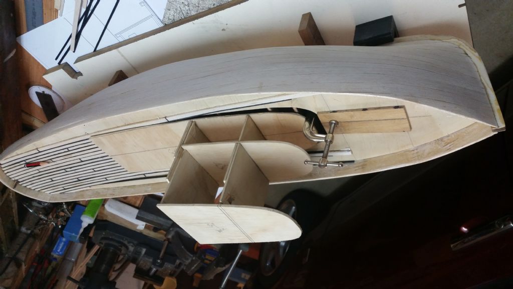

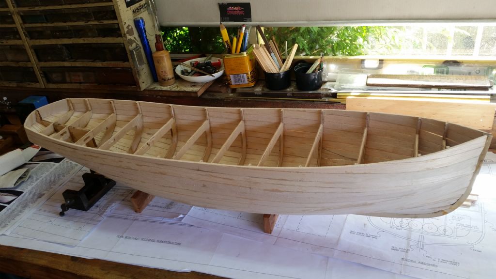

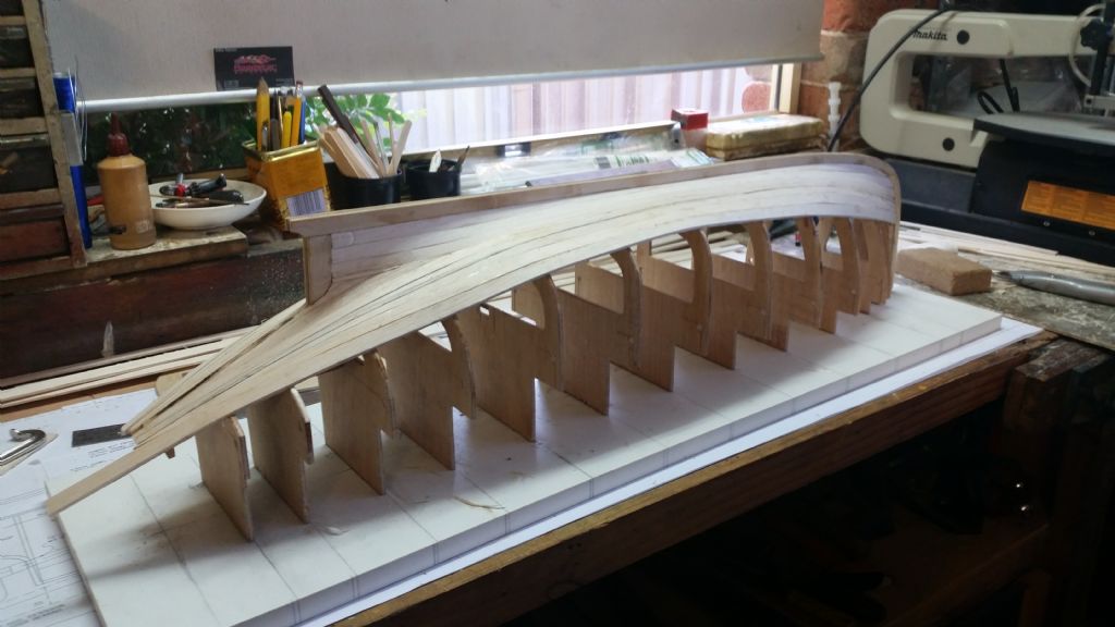

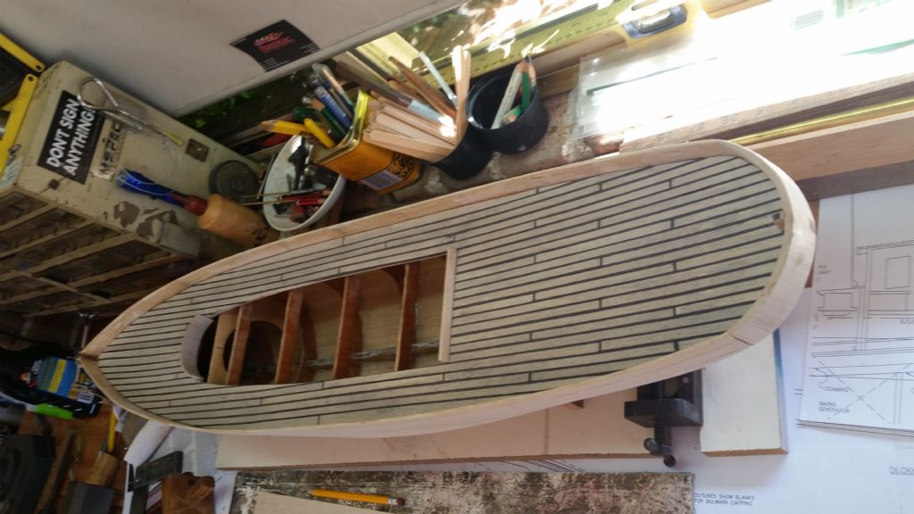

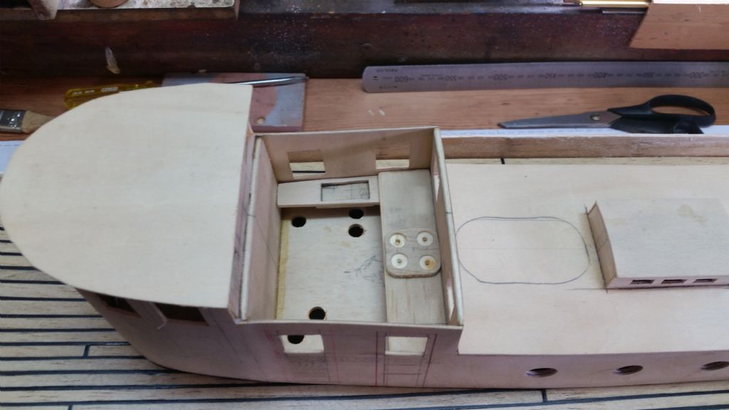

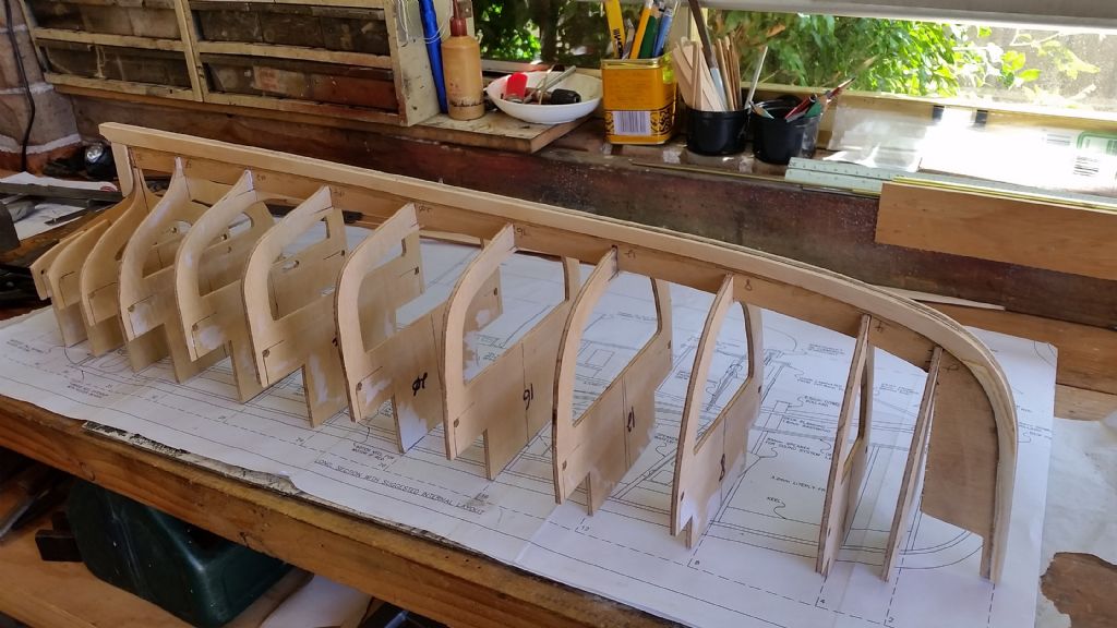

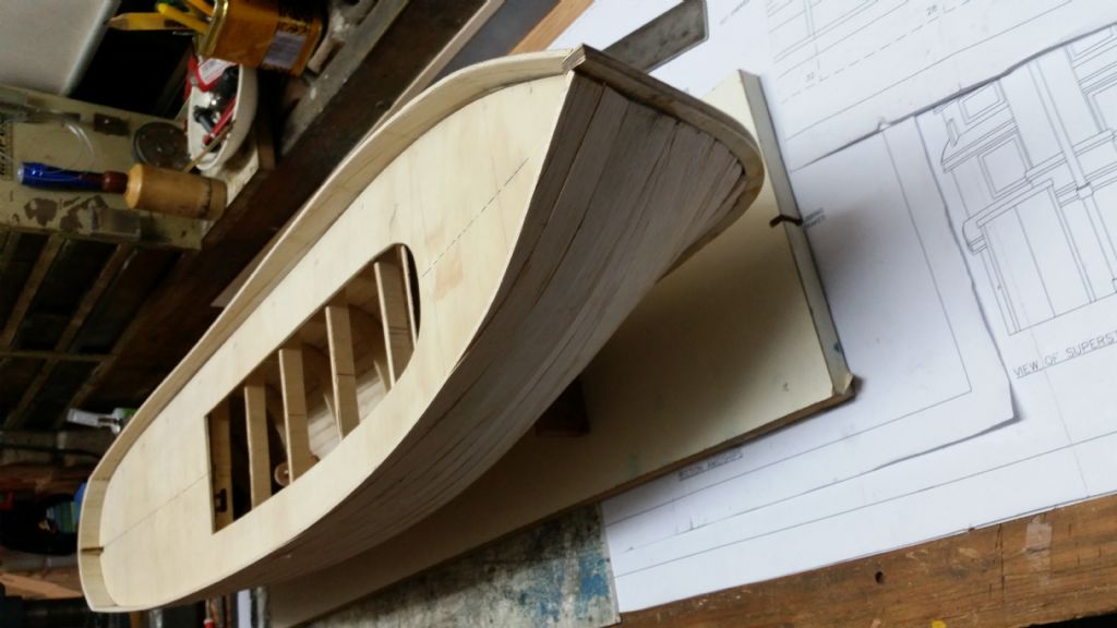

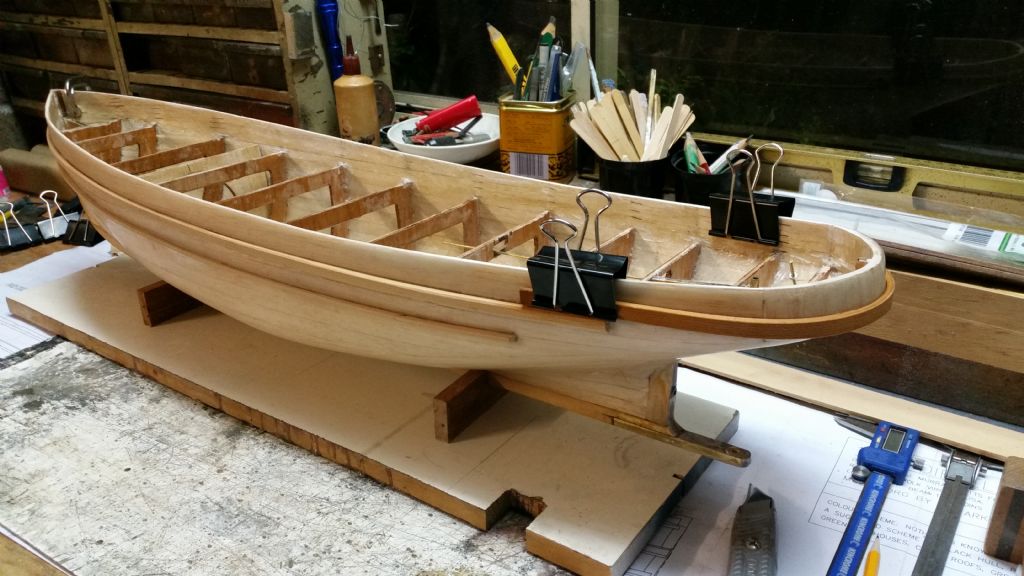

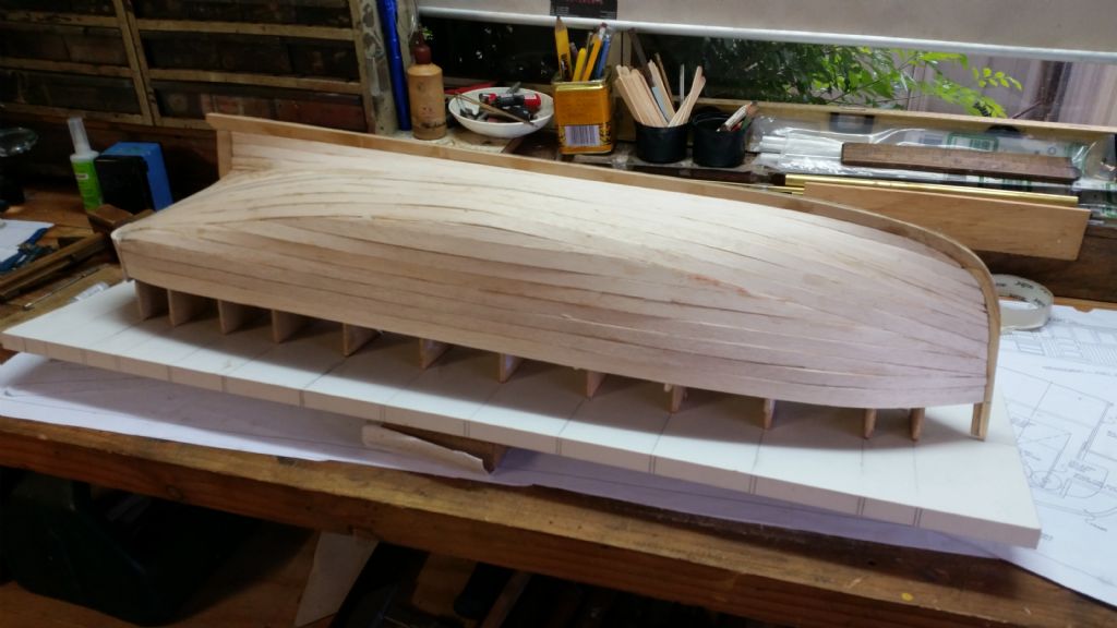

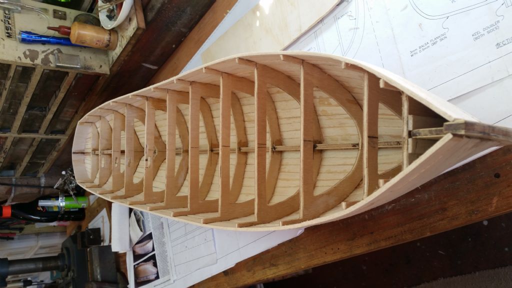

      20160116_183037.jpg2016-06-08 18.29.02.jpg20160605_170603.jpg20160604_174953.jpg20160417_174726.jpg20160404_181752.jpg20160328_194324.jpg20160328_194323.jpg20160328_194322.jpg20160326_153737.jpg20160326_153635.jpg20160320_181313.jpg20160307_180442.jpg20160227_144804.jpg20160227_144416 - copy.jpgHi guys thought it about time I added some eye candy to the forum in the form of some progressive build pics of my CRAIG scratch build. The plans are very basic and leave quite a bit to the builder especially things like the cabin and engine room. There are no patterns on the template so if you are contemplating a CRAIG build be prepared to hone your navel architect skills.
      Enough said enjoy the pics, upside down as some are not sure why that is and I cannot adjust them so you will. Oh yeah a tip I am using western redwood cedar for all the trim and bull walks which if I had my tie over I think I would use something else like mahogany.
      One last thing I purchased an absolutely beautiful 1900 rpm 12v motor that I am running on 7.2v.
