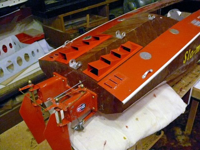

Hello Adrian
I was involved in high speed motor boats some time ago and had the same requirement
It appears that handed props for high speed are not available………Just LH only
LH props will not unscrew themselves, going forward and may be a safety issue?
Here`s my setup…….
Both props are LH and was not a problem
Prop Shop will supply cast bronze and brass high speed props for your boat to any requirement……and they are beautiful stuff too.
see below
neil
