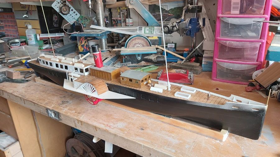

      I have a new project.
      Zapped into action by remembering my old paddle steamer from years ago, I've decided to make another one. A bit more detailed this time and sadly electric powered not steam and very loosely based on this (below, Greyhound based at Blackpool) but with a more Clydeside Scottish feel to it

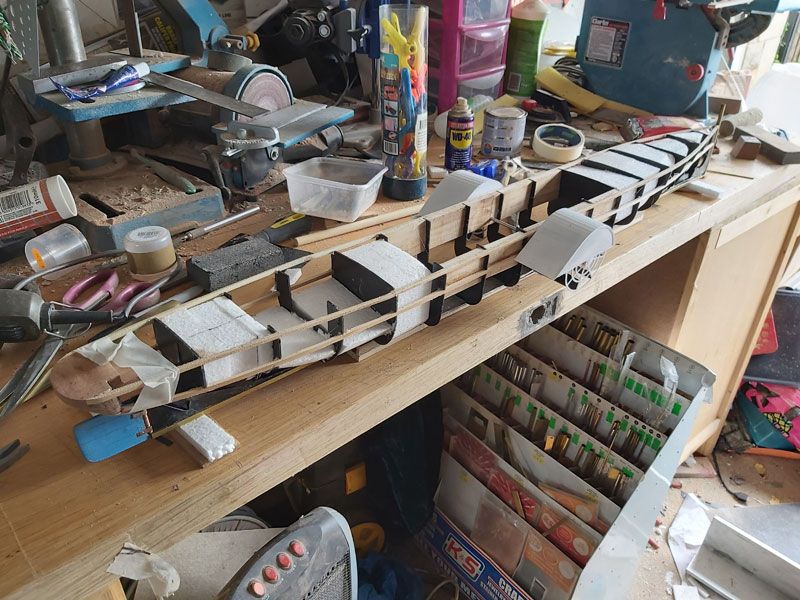

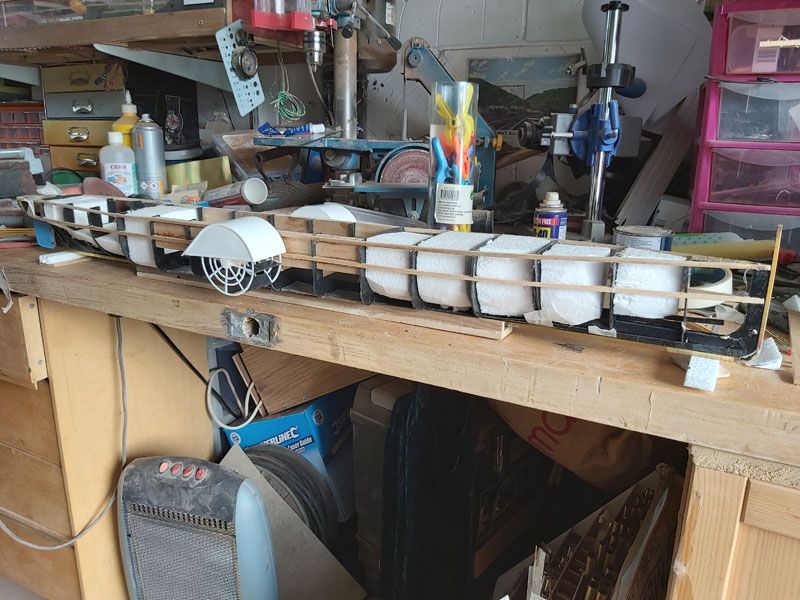

      This is progress so far:
      It's a shade under 1 metre long with a beam of 9" (I love mixing measurements. I'm old, it's allowed) and I'm currently really enjoying cladding the hull with 120x 3mm styrene strips (don't ask). It's taking forever….
      Question:
      I was thinking of using a Tamiya 72003 motor/gearbox unit in it. Has anyone got any thoughts on this? If so I'd love to hear them.

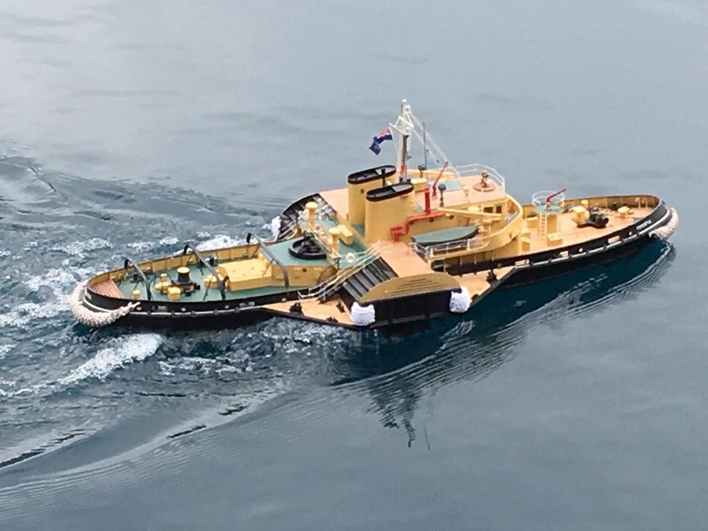

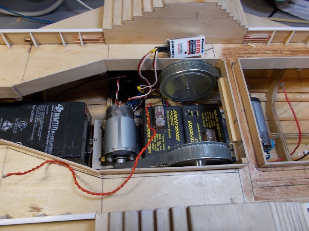

                58384380_2201674793259590_3698850844909764608_n.jpgHi there
                I built the Forceful tug a while ago and I used MFA como drill toothbelts and pulleys for the drive at roughly 50-1,
                Also 2 x Johnson 550 fan cooled motors (the thirsty ones) to drive it. As has been mentioned on 6 volt, it looked the correct scale speed for the tug, but, it had no pulling power whatsoever – therefore in great wisdom I increased the voltage to 12 volts in the model – this time I turned the tug into a 'kenwood chef' food mixer – the paddles looked spectacular thrashing the water about . But, didn't seem to improve the performance all that much – so- I tried putting NiCads in 7.2 and as it turns out 2 x 7.2 4300 Ni-MH batteries is equivalent (or thereabouts) to 6 volt 7 amp batteries of the Gel Cel type. So I loaded the model with 4 Ni-MH batteries to keep the weight right and it improved the performance greatly.001.jpg

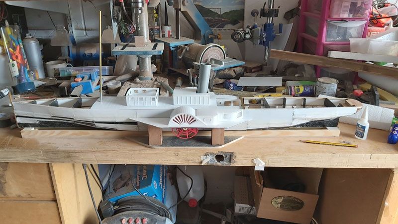

                            Back from sunny Spain to sunny Britain. Who'd have guessed it?
                            Anyway. More materials arrived so I've been mostly this past couple of days in the garage playing with my boat and the silhouette cutter. This is progress so far:
                            I'm still toying with the 2 motor/2 gearbox idea but I can't get my head around what control I'd need. Can anyone point me in the right direction please?

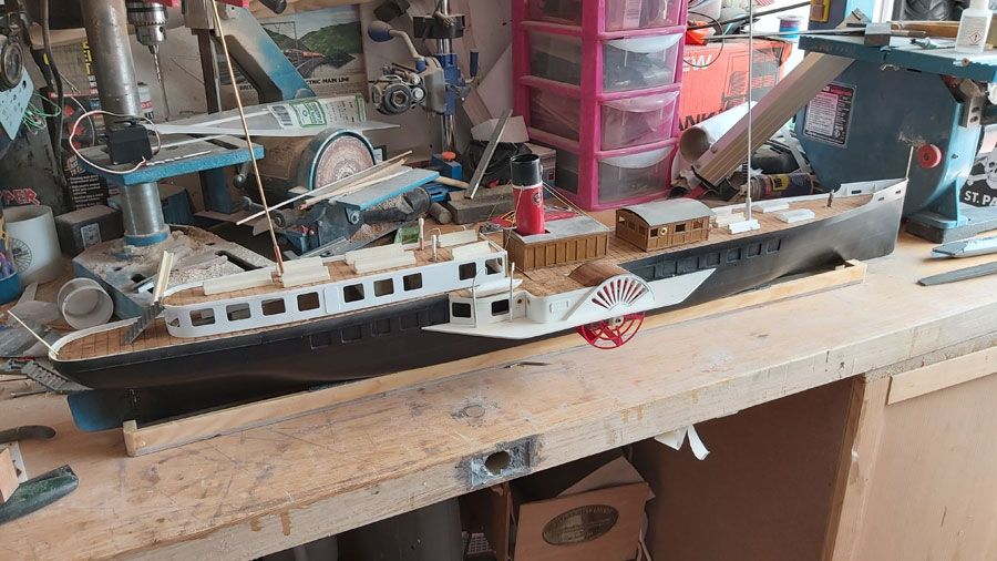

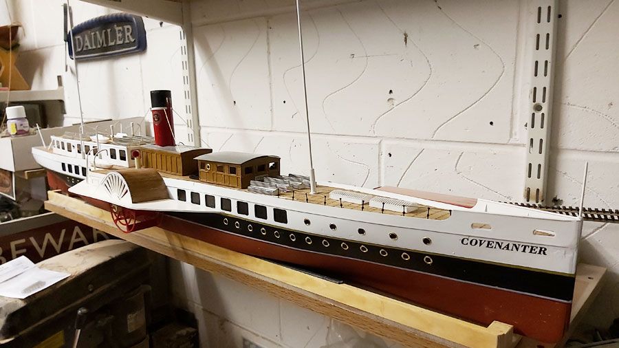

                                  Slowly but surely it's getting there..
                                  I'm now trying to decide the best way to make railings that isn't going to cost an arm and a leg.

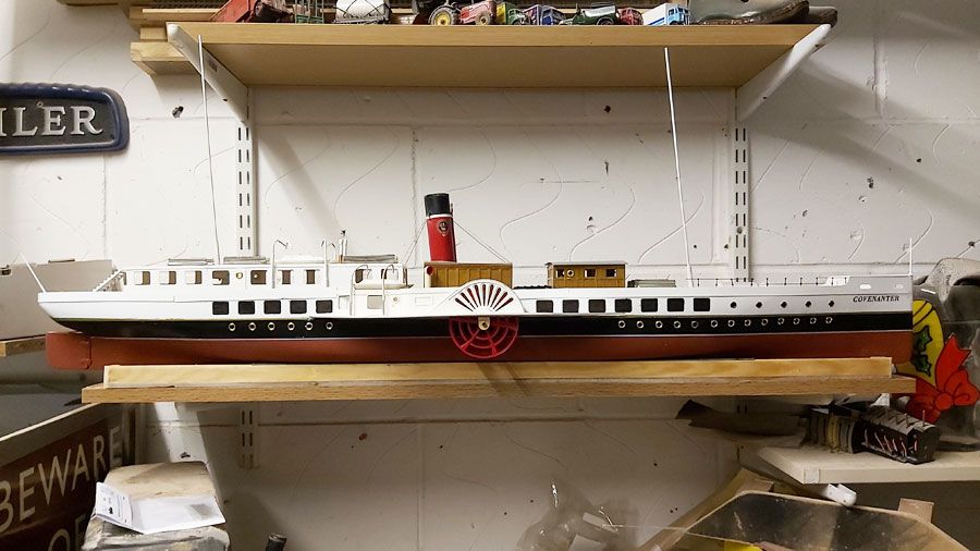

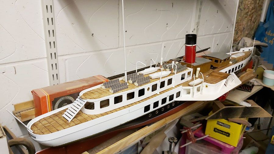

                                      I've decided that PS Covenanter will be a 'sitting on a shelf looking pretty' kind of model. I'm not going to even attempt to sail her because quite frankly, I don't trust my construction method to be watertight and I'd hate for all this work to just…. sink.
                                      So. Pictures of the almost completed paddler.
