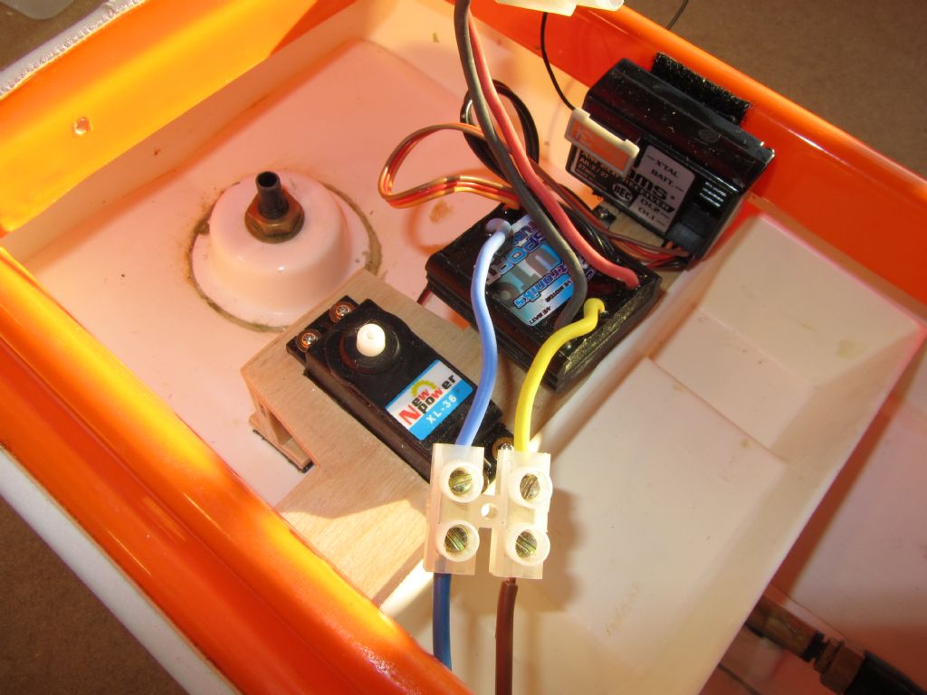

              I think the connections are Ok as I had to make a new mount for the servo and ESC as the original installation wasn't very good and the mount became dislodged after a coming together and I had to disconnect and reconnect the wiring including using a new connecter.
              To be honest the whole build wasn't brilliant and the prop shaft and motor alignment might be suspect. Good to know that it should only get warm so I have something to aim for. Performance is good, even over race distance. I'll probably redo the whole installation as I want to try moving the battery forward a bit – I can't use full throttle for long as it starts to porpoise.

                    As mentioned Chris for your motor to get hot would indicate to me that there is something wrong. You obviously already suspect alignment and I think that is probably one of the biggest culprits.
                    My Club 500 is frequently accused of being non standard as it appears to be quicker than most however I assure people that it is made straight from the box with standard parts. The difference is the care and attention with which it was put together. I assembled the motor and shaft using a solid coupling as supplied by the manufacturer but assembled the drive train vertically to ensure the best possible alignment. The motor was packed with sealant on it's base when in a vertical attitude to ensure there was no way in which it could all set anything other than in a perfect line. I am convinced this is why it performs so well.
                    As regards the bouncing, according to the instructions, the battery tray should be fixed using velcro so you have the ability to move the battery backwards and forwards depending on the conditions. I didn't bother and simply went for a neutral position and glued it. I don't like the idea that in a shunt the battery could come adrift. However if you are bouncing too much it sounds like the battery needs to move forward slightly. If your tray is fixed then you are going to have to live with it.

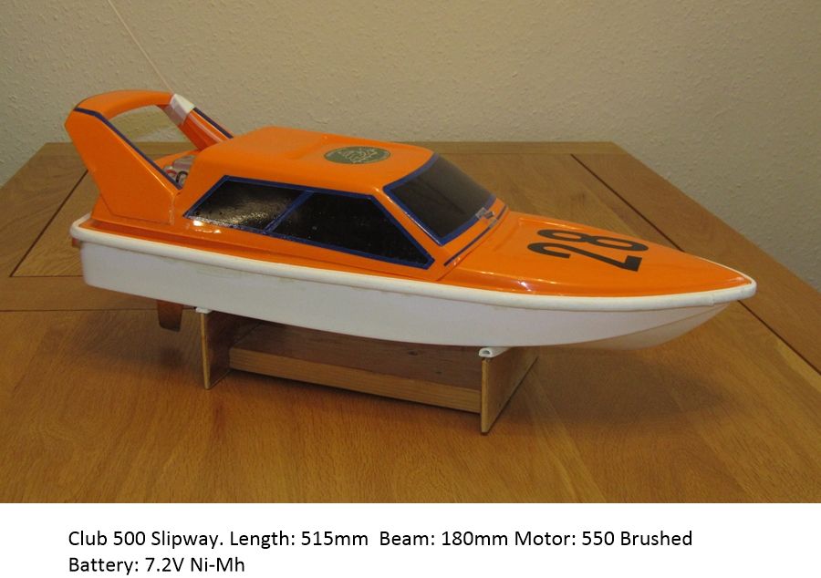

                          Thanks Richard. I bought mine off a fellow club member, who bought it off someone else, so that I could get used to a fastish power boat and participate in the friendly club racing. It's been ideal for that and I've since bought faster race boats for use whilst I'm building my Faireys, not that I will be racing those! As well as my DF65 yachts.
                          The battery tray has been glued in but I can probably get it out, though at the moment my servo etc. mount is Velcroed to it. I've been thinking about building my own though to make a better all round job of it.
                          What did you use for attaching the hull and superstructure together?
                          Thanks, Chris
