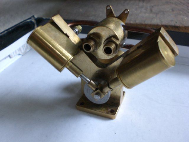

              In case it may help you or other readers to recognise the engine, here is a picture:
              As you will see from this picture, the gland seals on the cylinders are not adjustable.  It also appears that, as you suggest, the end covers of the cylinders are pressed in.  I would still appeciate it if anyone familiar with this specific engine could confirm that they are pressed in rather than being screwed.

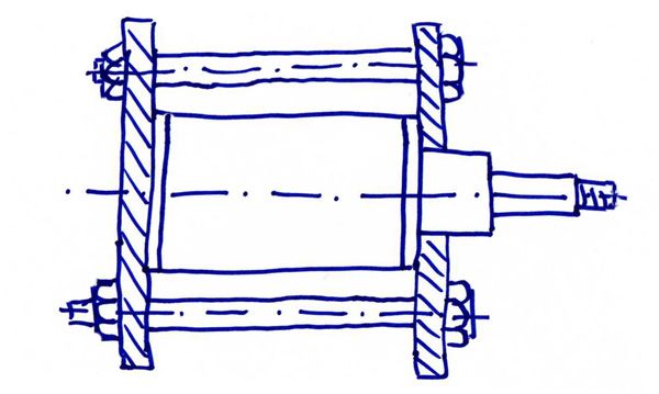

                                                    This in my suggestion……………….A plate at each end, held together with 6BA tie rods
