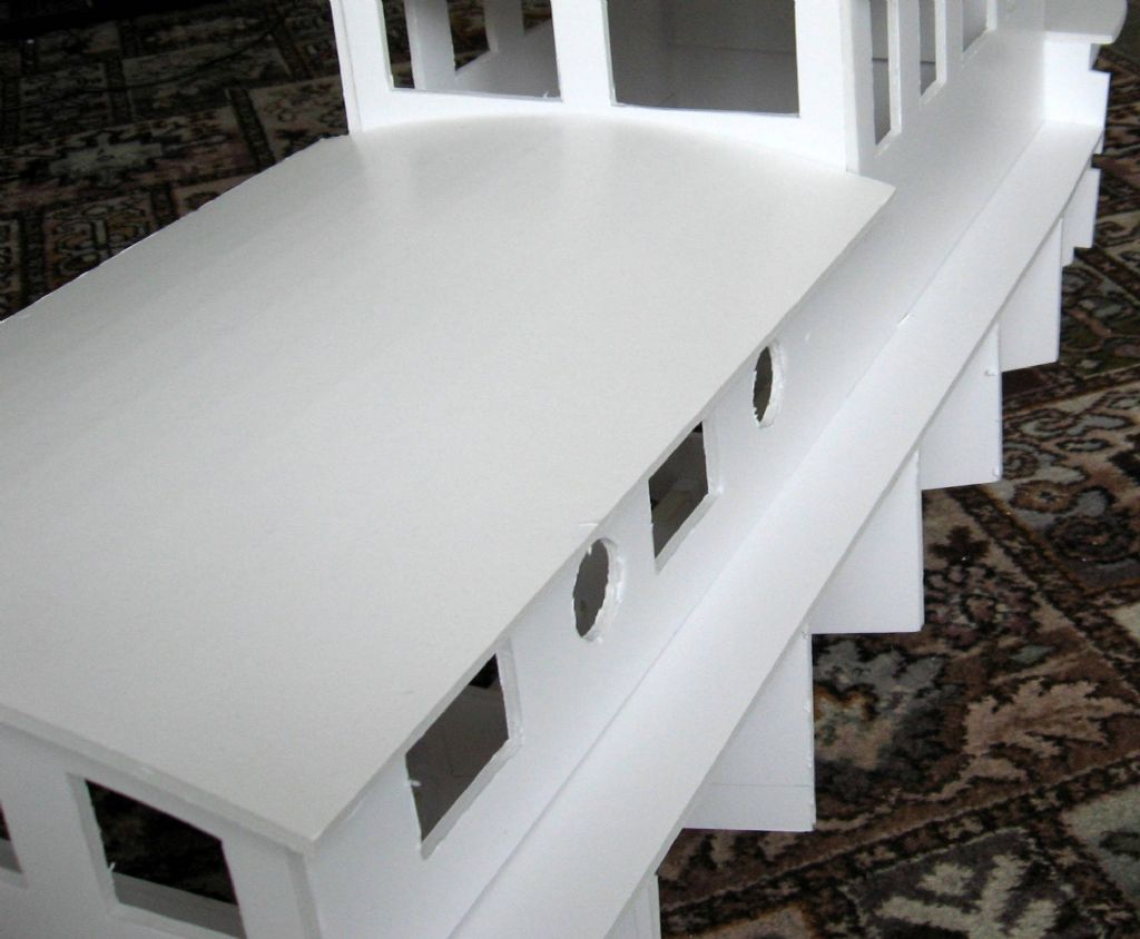

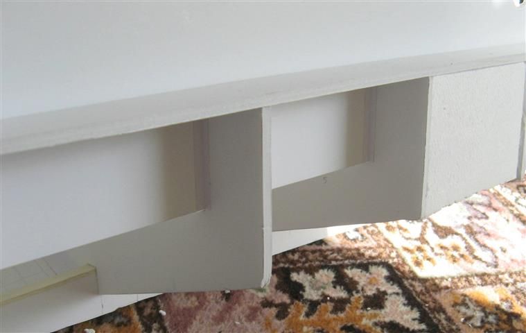

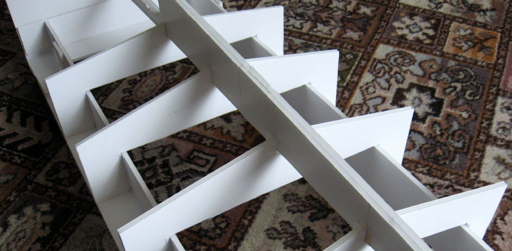

        After recent discussions regarding building with craft foamboard I decided to build a 5ft River cruiser to test out the construction theory of laminating foamboard sections together for increased strength.
        I designed the river cruiser a couple of years ago but never got around to building a full size version.
        View of frame showing laminated keel
        View of frame from below rear cabin
        View of rear cabin roof

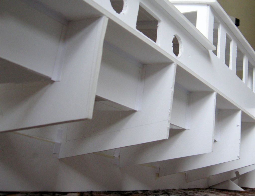

                Adhesives are UHU / 151 solvent for the reinforcing card at the joints and waterproof PVA for the laminations. Only cutting tool is a Stanley knife with fresh (sharp blades).
                The foamboard joints are reinforced with 300gsm card because the solvent glues melt the boards foam core.
                Cutting and building is fast and the boards can be curved by slicing shallow easing cuts into one side.

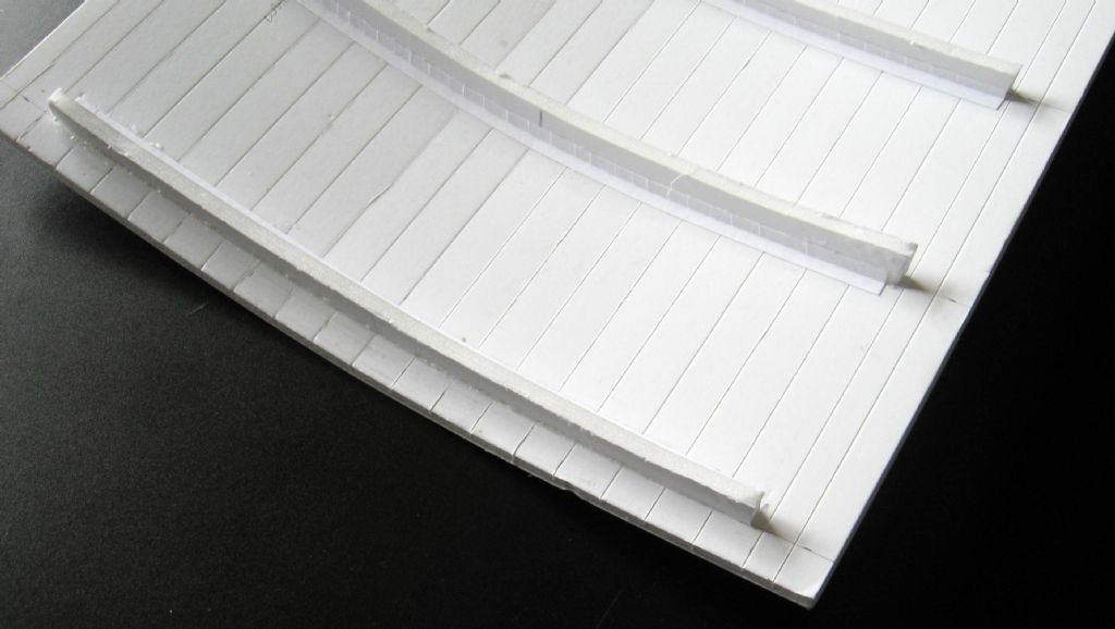

                Easing cuts on the inside of a cabin roof, note the card reinforcing angles connecting the ribs to the roof.

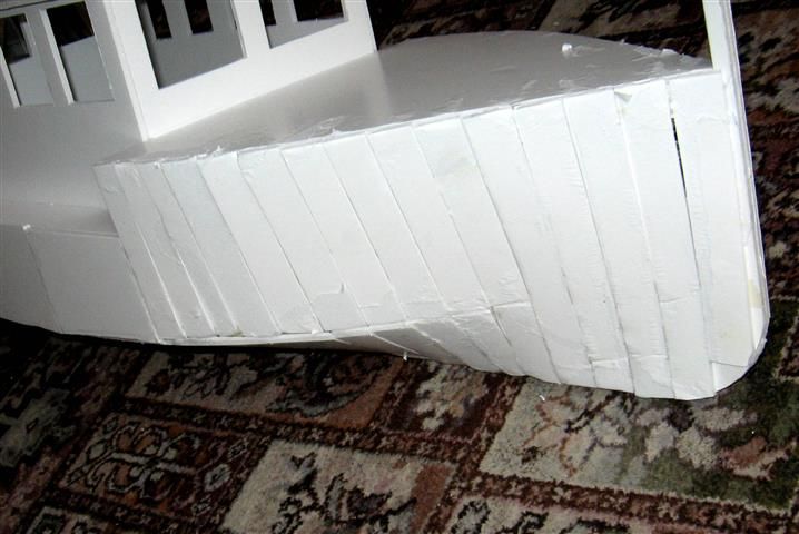

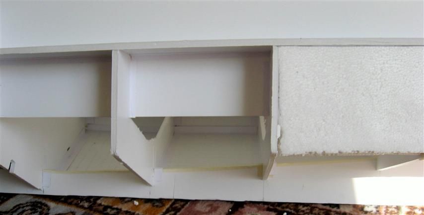

                          I have started to fix the skin onto the frames and whilst the straight bits are easy the curves at the bow have been a problem.
                          I started fitting narrow vertical boards in order to overcome the problem of getting the rigid foamboard around the double curves but after some experimentation I found that by scoring a 3mm deep diamond pattern in the rear of the 5mm boards they would become far more workable and enable a certain degree of flexibility when doing the compound curves.
                          I will post some photos when I get the camera back.

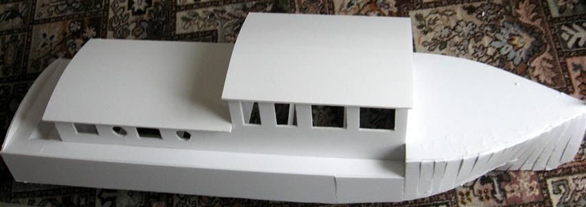

                          #39880
                            You can see where I started to fit the boards before I discovered the diamond scoring technique.
                            To be honest I was starting to worry about getting these almost rigid planks to follow the simple curves of the bow and even though this side hasn't turned out as well as it could have the experience has been invaluable (a bit of filler will sort this bit out)
                            The other side should go on a lot neater.
                            Total weight so far is just under 2lbs
