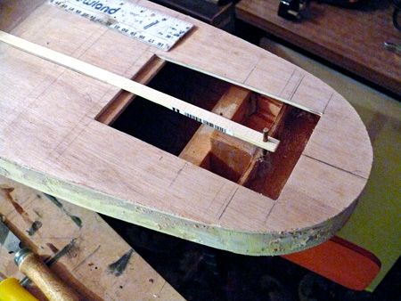

I needed to hold the rudder post exactly in position……with plenty of access around it……..to apply P38 filler……
So I drilled a hole in a strip of wood and weighted it down at the other end.
