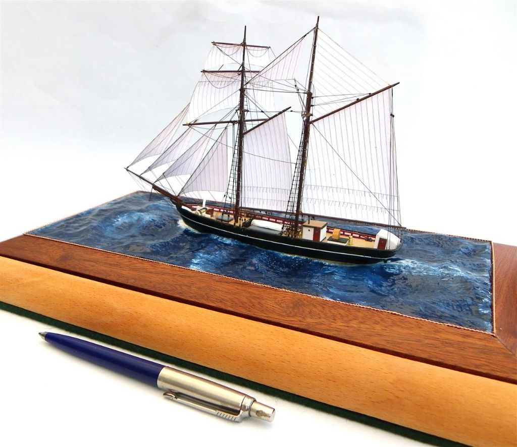

      small schooner in sea.jpgA Utube slideshow – **LINK**

          I am intrigued how you make the sea so realistic and what do you use for the rigging?

            Thanks. The sea can be made from Plasticine that has been shaped by rolling a large ballbearing over it, but the sea above was made from heat-formed polystyrene foam covered in crepe paper stuck on with wood glue to give it a better painting surface. The masts and spars are all brass and copper tube and rod. The rigging is fine copper wire. The methods are described in the article "Bellmore, Miniature Sailing Ship Modelling," that was published in two parts in Model Boats in December 2018 (Vol 68, No. 817) and Januray 2019 (Vol. 69 No. 818).

              A beautiful model Bob. It always amazes me how much atmosphere your models can create being so small yet you really feel like you are there with it.
