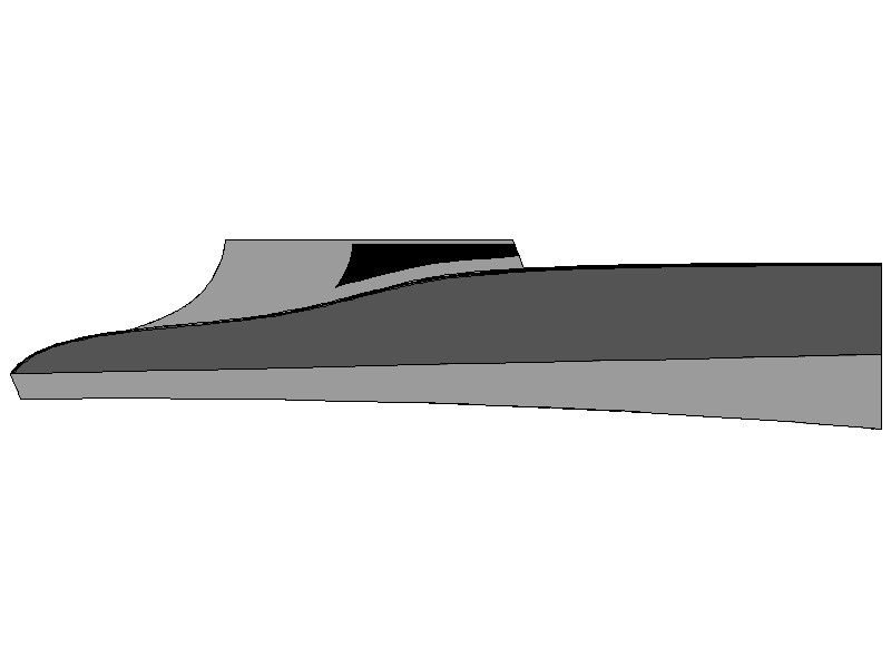

  • #43815
      This is Brutus and it will be the next fully new design coming off the production line and it is planned to be the Autumn project.
      At the moment its a concept of a 4ft model speedboat based on the seaaxe design of hull.
      #6898
        #43820
          Hmm..is this drawing upside down?? cool Ashley
          #43826
            Nope. The bow is on the right and it is vertical. The idea is to cut through the waves rather than try to ride over them – hence the radical shape.
            #43838
              Brutus has a knife bow and as Dave says it is designed to slice through the water rather than skim over them.

                #43851
                  Ah I see……But would you build it?
                  #44262
                  Amy jane September
                    @amyjaneseptember49770
                    Watching with interest….smiley
                    #44265
                      Hi Amy
                      At the moment its just an idea that is kicking around in my mind and it only exists as a few sketches but I have to admit that I am looking forward to building it.

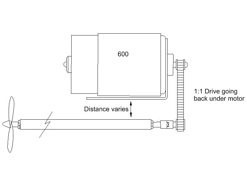

                      #45333
                        Dear All
                        Has anyone ever come across an engine mount / drive combo like this?
                        I would rather buy than build such a gearbox but can't locate a suitable unit, I need two to suit a pair of 600 size motors
                        #45334
                          Paul,
                          You don't need a gearbox. A toothed belt drive from the likes of SHG Models will do the job perfectly well.
                          #45335
                            I`ve seen drives like this somewhere…..Was it Hobbies or Hobby`s?
                            Don`t think you`ll need the flexible drive coupling, old chap!
                            #45336
                              Thanks Colin I will have a look
                              Bob I hadn't thought about Hobbies and will have a look, unfortunately it looks as though I will need the flex coupling as I am fighting for space in this one.
                              #45339
                                I can't find anything like this on the Hobbies website. MFA used to do a belt reduction drive for 540-sized motors but it's been discontinued for a while now. Graupner also do a geared one but again it's a reduction type. Like Colin says I reckon your best bet would be a belt drive with identical pulleys. MFA carry a large range of pulleys and belts.
                                (Unless you actually do gear down the motor speed and use larger props…..)
                                Edited By Dave Milbourn on 02/12/2013 11:00:28

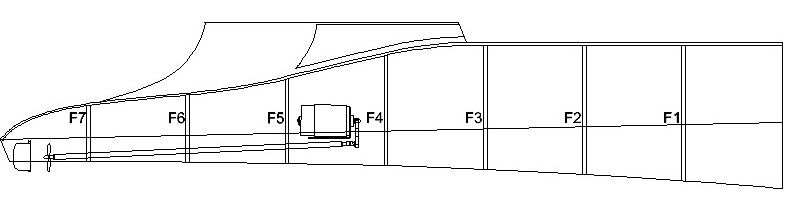

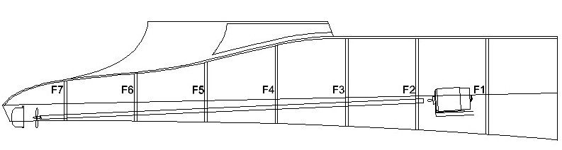

                                  For those interested in why I need such an odd drive.
                                  In designing the Brutus I have given myself a problem……I don't have sufficient space within the hull to get the twin 600s where I want to position them.
                                  I do not like steeply angled propshafts so it is important that the shaft angle doesn't exceed 3deg
                                  From a weight distribution point of view the first image shows the ideal location however the hull is simply to narrow at this point to accommodate the motors.
                                  On a conventional hull the simple solution would be move the motors toward the stern to a location between F3 and F4 where the hull is wide enough to accommodate the motors.
                                  The problem with the Brutus design is its bow shaped keel which, if the motors were moved backward they are also forced upward and so increases the shaft angle beyond 3deg.
                                  A solution might be to turn the motors around so that the drive is pointing forward and position them over their respective shafts. The second image shows how this might be achieved, with the motors in this position the batteries would be placed in the adjacent bay.(F3/F4)
                                  #45343
                                    The shaft angle on some modern power boats is over ten degrees (to accommodate gearboxes) and there's no lack of power there. Just a thought………….
                                    #45346
                                      Hi Dave
                                      Its just me I don't like steep shafts
                                      The steep shafts change the propellers angle of attack which equals less efficiency with the resulting increase in prop size to compensate. To me its a compromise that doesn't need to be made especially when, with a little thought, the shaft angle can be kept shallow.
                                      #45347
                                        Add to the futuristic design by having some alternative engineering.
                                        Have one motor under and one over (at a steep diagonal, anyway) like the Lightning fighter. , the top motor can drive its shaft by a 1:1 belt, this motor could face rearwards while the othr one faces forrard.
                                        In fact, be really bold and indeed have the motors one on top.. the bottom could drive the shaft direct, and the other shaft could run under the bottom motor and be driven by a 1:1 belt, the belt being behind the bottom motor.
                                        These motors could be mounted on a vertical bracket. I dont know how long the shafts are but this might give a very small outwards angle to the shafts rather than being parralell, but it would be only a very small angle.

                                            Amazing proposition and if I were building a long thin racer then stacking the motors would make sense but with Brutus there is no need.
                                            The only time that I have used flexishafts is in conjunction with IC engines and always thought that they robbed power from electric motors through friction
                                            Edited By Paul T on 02/12/2013 18:27:27

                                              #45354
                                                Posted by Andy Stoneman on 02/12/2013 19:39:28:
                                                Paul, I can see where your coming from regarding propshaft angle, If it is too steep when driving it will force the boats bow down and you wouldnt want that.
                                                Andy
                                                Andy
                                                You might think so BUT, just as an example, the shafts on the real Fairey Huntsman 31 are at 15 degrees to the waterline and yet the craft needs transom-mounted trim tabs to keep the bow down under full power. Fairey powerboats are among the best sea-keeping types ever designed.
                                                I really think you are making things difficult for yourself here. I don't believe that the relatively shallow inclination which the shafts will need in Brutus (in order to accommodate the motors comfortably) would have any noticeable effect on its performance. Aesthetically it would be difficult to see from the outside anyway, given that the props are only of the order of 30-35mm in diameter and therefore the "tilt" from top to bottom would be very small. My final argument for the defence is that the power loss in a belt or gear drive would likely be a lot more than that attributable to an angled thrust-line using direct drive.
                                                I rest my case, m'lud.
                                                #45355
                                                  Whilst I agree that the Fairey boats represented a excellent benchmark in hydrodynamic design I do feel that the position of the engines and choice of power train were a compromise arrived at to suit the technology of the period.
                                                  If current technology were applied to the designs then I suspect that the layouts would be different, for example on the Huntress the motors might be in the stern and power transmitted via Z legs or jet drive. In this particular craft repositioning the engines to the stern and using a Z drive would not only correct the propellers angle of attack but move the centre of gravity toward the stern thus reducing or negating the need for trim tabs
                                                  We can argue the merits and failings of the Fairey designs backwards and forwards all day and I am quite looking forward to my learned friends rebuttal.
                                                  On a serious note you might have a valid point on power loss when employing belt drives and I will try to find some relevant data on the subject
                                                  Edited By Paul T on 03/12/2013 14:13:23

                                                      Yes, and when you think about it in terms of Newtons third law it becomes blindingly obvious, as the propshaft angle increases then more energy is required not only to propel the boat forward [because the effective area of the blades is reduced] but also to overcome the push of the propeller trying to lift the stern of the boat Ipso Facto for an efficient propulsion system the propeller has to be positioned as close to the horizontal as possible.
                                                      In short any propeller shaft that isn't truly horizontal is always the result of compromises having to be made between form and function.
