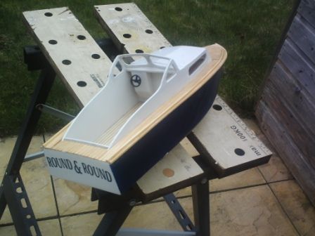

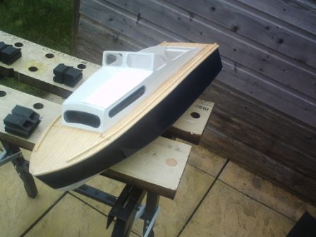

                  Thanks Gordon but the sea nymph is finished. I struck lucky with the 1200kv motor and it runs a treat. I found a you tube video of a sea nymph running this motor on a 3 cell lipo so I just copied this setup
                  here is my nymph
                  No reverse though but on this small model I dont think its needed

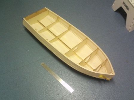

                    I will have a look for the convertion charts as it may be useful for my next project. I already have the hull planked up
