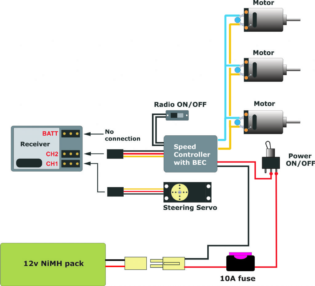

                                                Exactly like this:

                                                Malcolm Frary
                                                  @malcolmfrary95515
                                                  What Ashley and Dave said. Simple is good, especially on a first build.
                                                  The arrangement shown controls all three motors together, and in this case, as drawn, all three motors will turn the same way. If one of the motors needs to turn the other way, just reverse the connections to that motor. This is one of the few cases where fuses between ESC and motor makes sense – the fuses act as a handy test point as well as allowing for a misbehaving motor to not affect the other two.
                                                  If you feel the need to have independent control of the motors, then you will need three ESCs, and a rather different wiring diagram because there are many possible different arrangements. But probably it is best to keep it simple for now.
                                                  #62769
                                                    DM> Thank you, nice clear diagram, of the sort you do so well.
                                                    Malcolm. Thank you also, the reversing of the motors will probably have to be taken into account as I would imagine the props are left and right handed.​
                                                    An easy way of fitting fuses is to simply crimp in a pair of 1/4" or whatever the metric is female blade connectors and fit car type flat blade fuses into one of the motor wires. Again, not fancy, but cheap and easy. 3 or 5A fuses will be more than sufficient.
