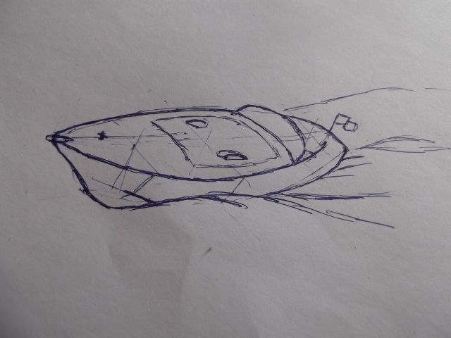

                other than being 5' long and 18-20" beam, that"s about as far as the design process has got. I'll carve a 1/4 size half model at some point, and build from that.

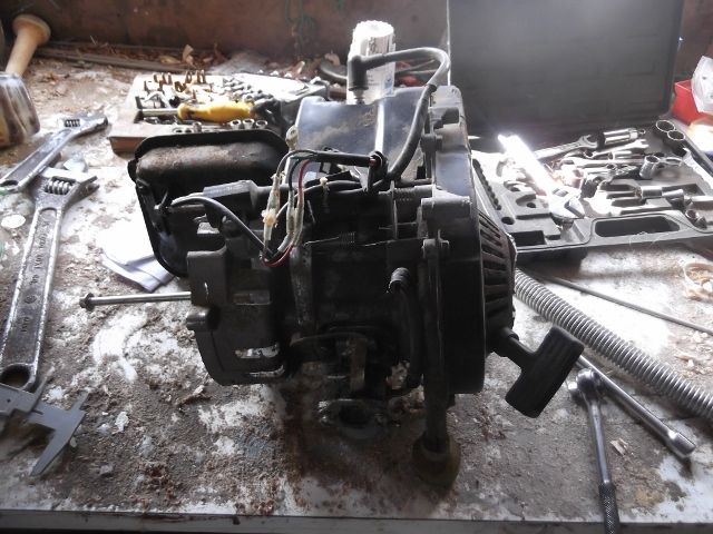

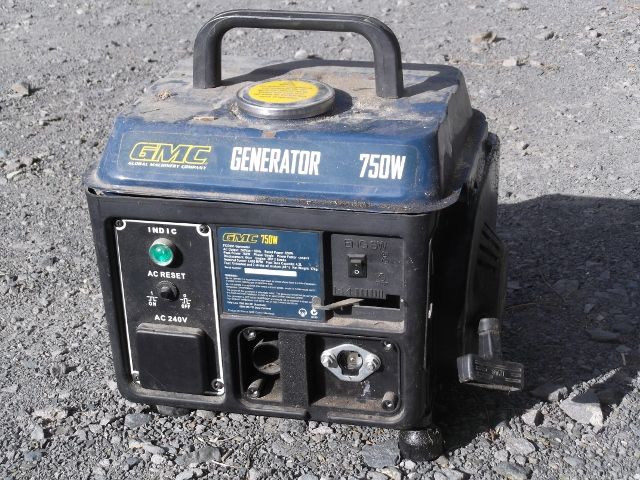

                This is the generator Lynn has cannibalised.
                A local hardware chain used to sell these for about NZ$100 each, brand new. Good little units, this one had 10 years of hard use before the alternator gave up. I bought one second hand for $40, which we use on the launch. (NZ$1 = 52p or near enough)

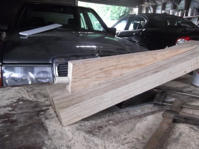

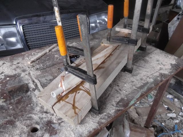

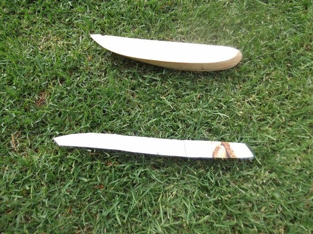

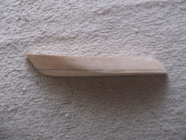

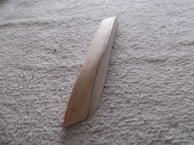

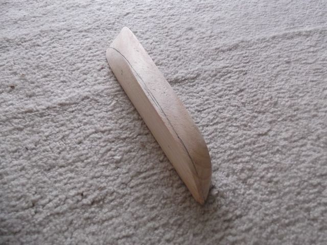

                              I spent a bit of time in the design office today, which for me means a block of wood, a sharp hatchet, chisel and rasp! Pretty happy with the design at this stage, but I will leave it kicking around for a couple of days, just to be sure.
                              The next stage will be to lift off patterns for the ply sides and bottom, (yes, it is do-able in sheet ply) and then put it to the saw for the sections.
                              Mean while, Lynn is setting up the engine, drive shaft etc, (and no doubt muttering about me making her life difficult!) and will email photos in due course. (boat building by corospondance, she lives about 40 miles away!)

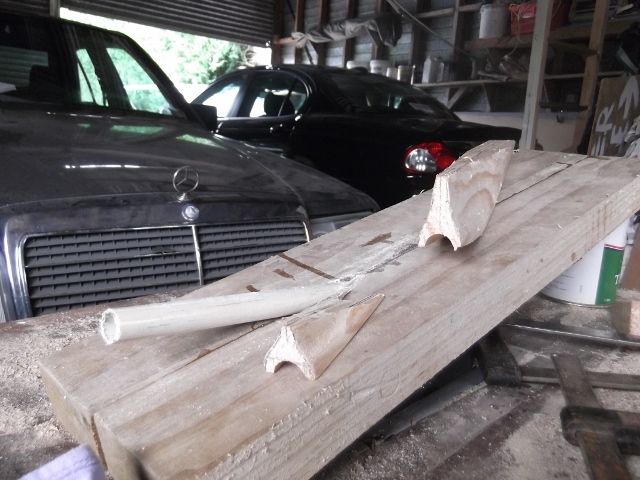

                                          Lynn has been hard at work and emailed through her first lot of photos. She decided that she would set the engine and shaft all up on a length of 8"x 2", which I could then shape to suit the hull.
                                          The muffler removed, the alternator housing cut down to lower the engine a bit, and a pattern made for the prop tube angle. (I'm still trying to convince her to join the forum and put her own posts up).
                                          Skeg cut out, and split. the bore was then chiseled in.
                                          The 8×2 was also split, and chiseled.
                                          The after end was carved to shape, the fore left unfinished, so the whole thing could be clamped in the vise, for the rest of the work.

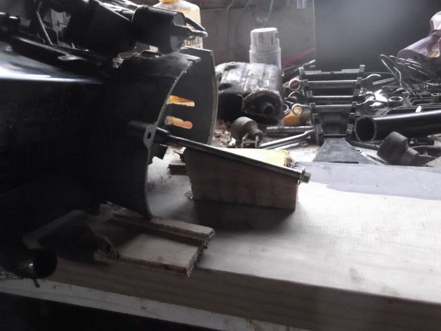

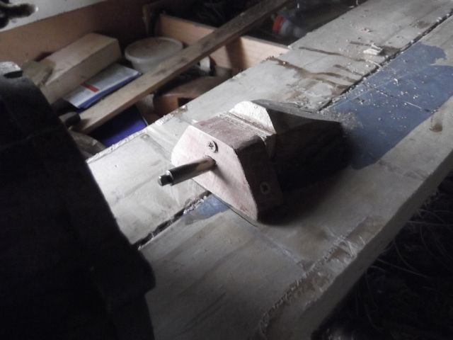

                                                The rural branch has been hard at work, the city branch less so.

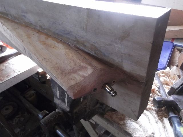

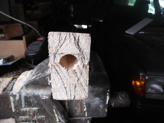

                                                A temporary shaft was centred and wedged (this shaft is mild steel, we're still waiting for a s/s one to come wandering along), and the lower bearing carved to shape and screwed in.The timber used is our native pohutukawa, a hard, tough timber with an interlocking grain. We regularly use this timber for fullsized yacht fittings, including block sheeves.
                                                The inboard end gets a similar treatment.
                                                The engine will then be lined up and Lynn will send me the location of the engine mounts. I will then cut the half model at the right place and send her a drawing of the frames which the engine mounts will be incorparated into. Once the engine is mounted, I'll take over the building. The remaining frames will be mounted on the 8×2, and any thing that is not pure boat carved away.
