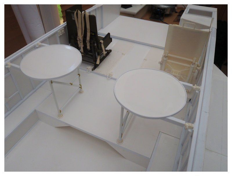

            This promises to be a very impressive build, Dave….Looking splendid
            Welcome back to the boat modelling world!
            The seats are very impressive!

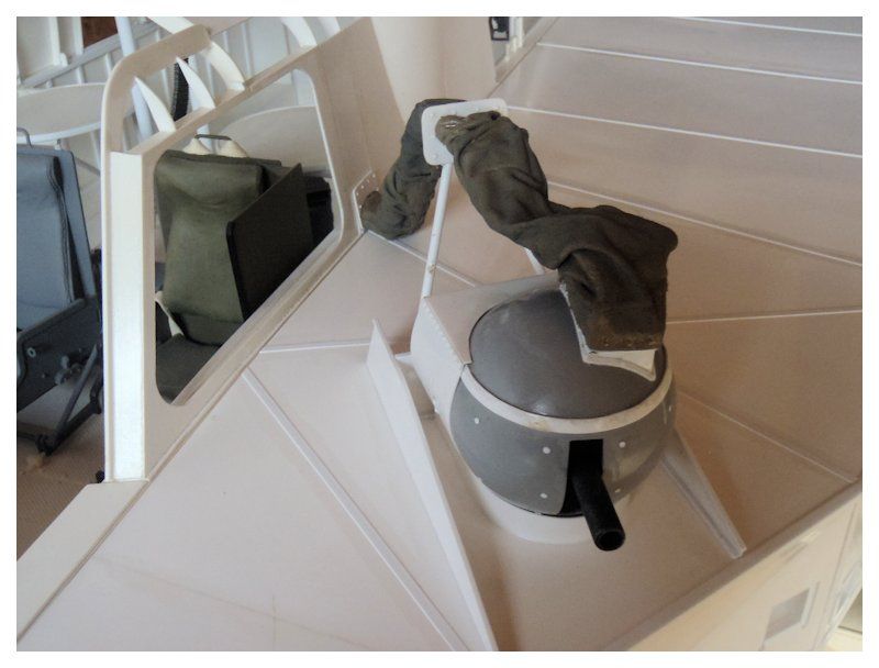

                  I have finished the fan section. I have also re profiled the tail module as when I had finished it from the plans it didn't look right to the pics I have.
                  As a break from large bits of white plastic I have made the ammo drum for the 40mm automatic grenade launcher.
                  Best regards
