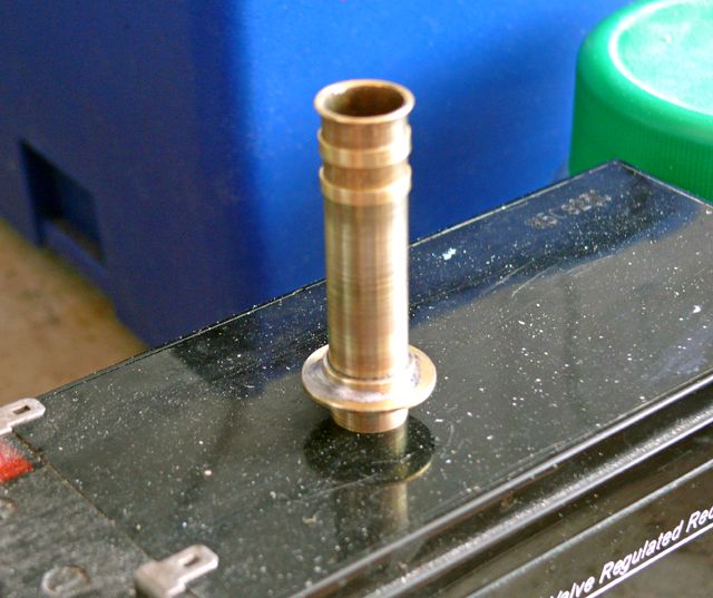

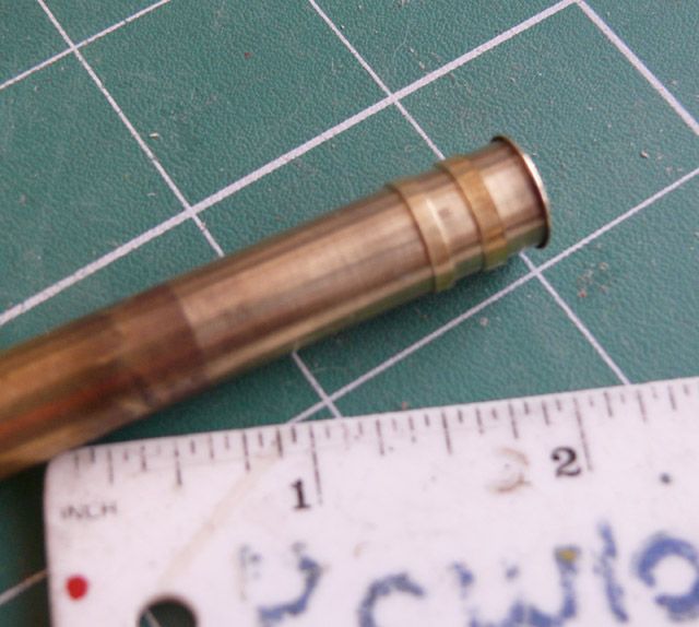

      Made this neat little chimney for my pal Duckies canal barge
      The nice feature is the chimney flare
      This was done in the lathe, with a length of flat steel bar, having a rounded and polished edge and oiled.
      The flat bar was rested on top of the lathe tool, for support and the edge of the steel bar was pushed against the tube end, forcing the brass tube to roll out.
      The process is called “Spinning”
      The brass tube was annealed first, to soften the brass

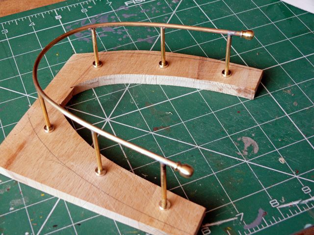

          He did me the soldering of the back rails of the boat and added some nice brass balls on the ends, what a clever chap, and you know the old saying ” A friend in need is a friend in deed”
          So once again Bob , Thank you.
          Perhaps he will put up the rails and balls picture for you , I’m forgotten how!

              Here are the rails Bob made for me earlier,mentioned in the earlier part of this thread
              Nice job hey , just ready to put on to the boat!

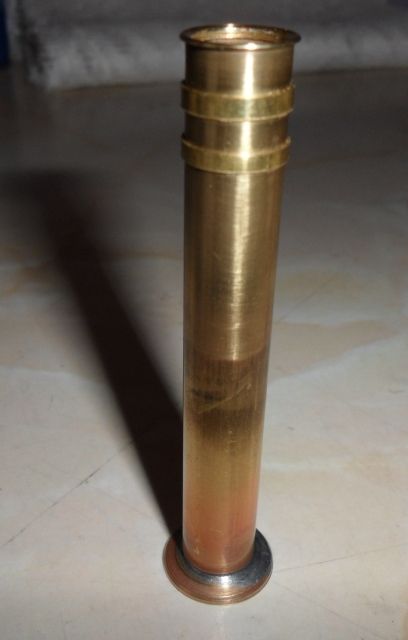

              Here is also a picture of the finished chimney Bob turned out yesterday
              He wasn’t satisfied with the earlier picture and added a flange on the bottom whilst I watched and learned

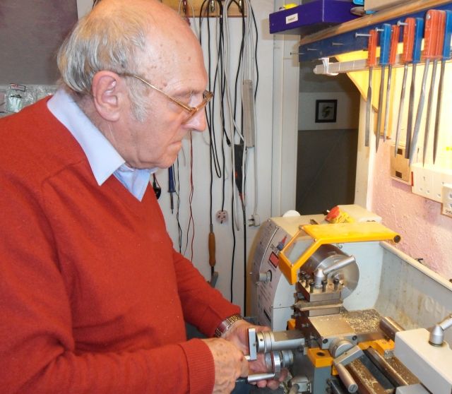

              And there’s the man himself at his lathe, so the chimney is ready for paint and then a smoke unit fitted

                Just another post to let you see the finished chimney

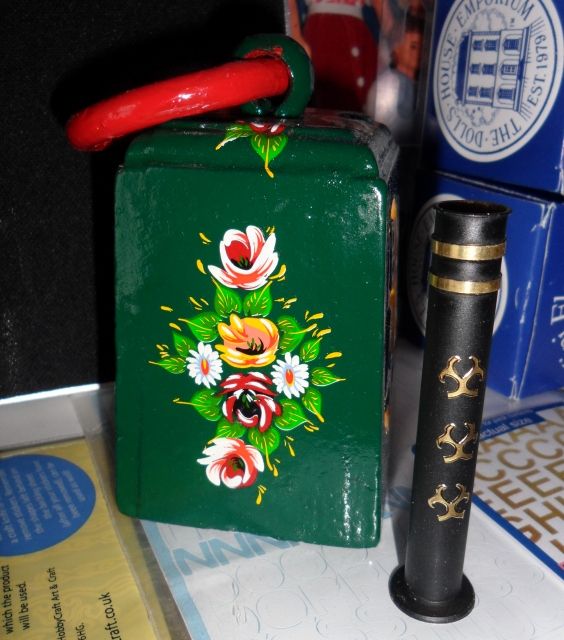

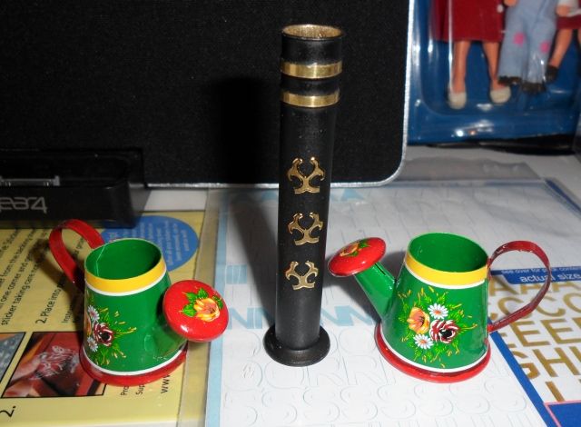

                Chimney with my themed mooring weight and another one! (can’t stop me now!)
                With my themed watering cans, they were bought at a florists shop, don’t usually go in them but just saw the watering cans in a floral display outside.
                What a great addition the chimney is to my build, thanks again Bob!.

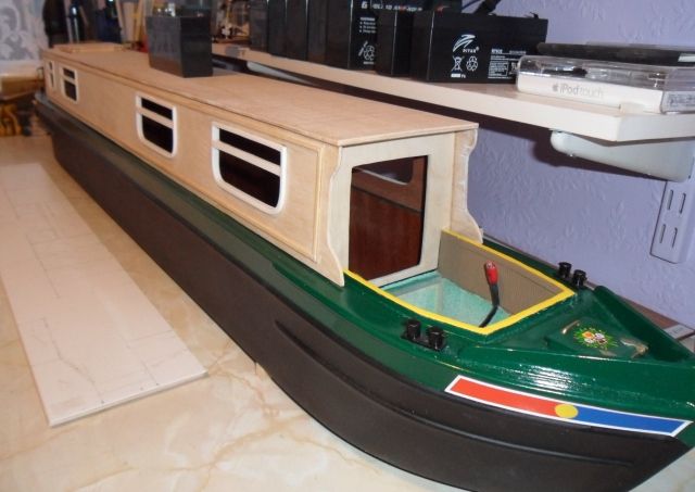

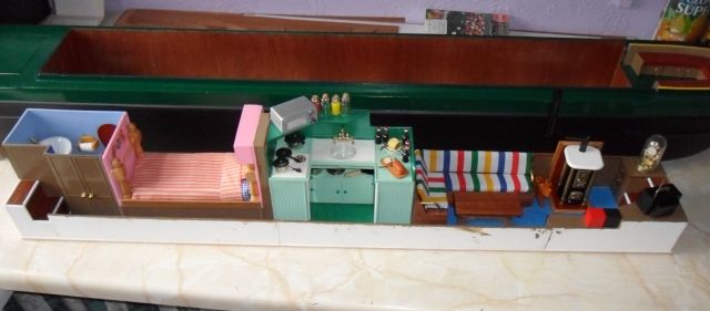

                    You asked for it!! Bet you will be sorry now.

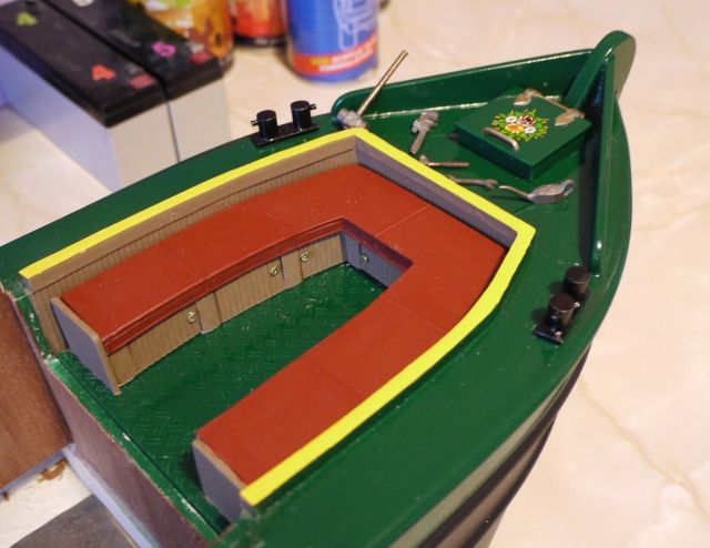

                    Seating at the front, remov-abell, battery underneath
                    Vinyl sheeting used.

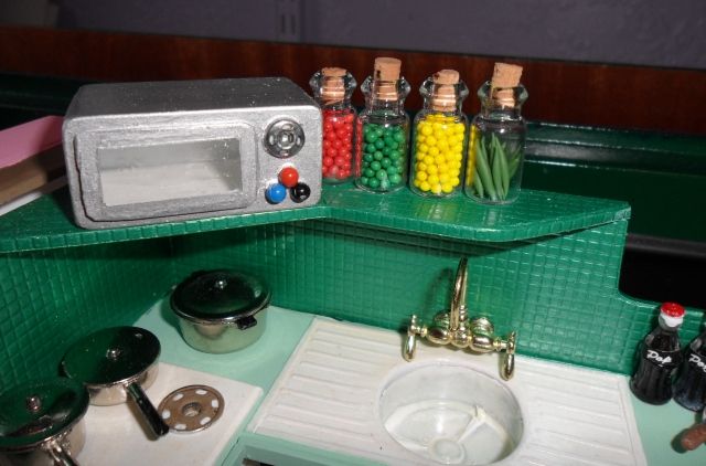

                    Added some accessories to the kitchen, kitchen scratchbuilt though
                    cassette to go in the boat

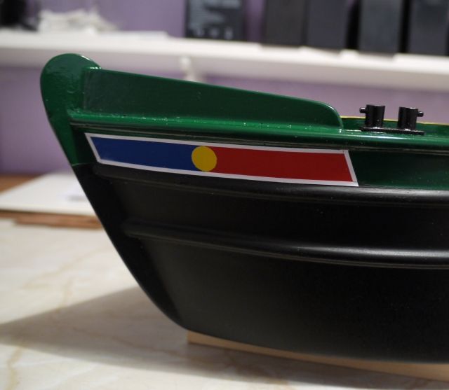

                    Front art work
                    Front view, starting the top paint work soon

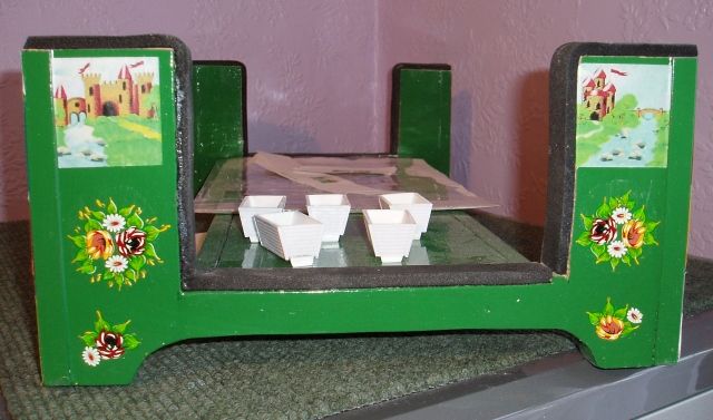

                    Stand art work, castles from pictures on the net, flowers transfers.
                    And thats a short trip round the boat as it stands it the moment, Bob

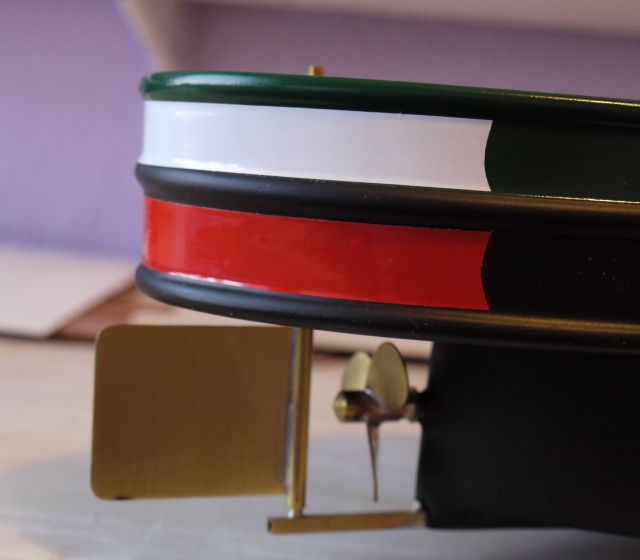

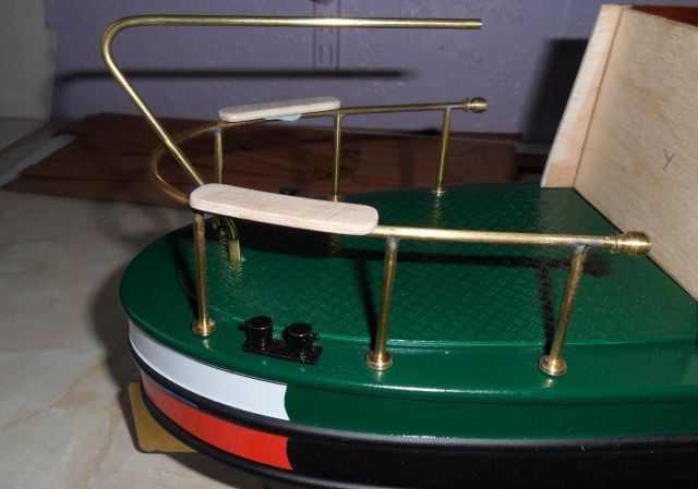

                              Here you go Bob, the stern end complete with tiller.
                              Bob’s rails and fancy bits on the ends (Balls)
                              Only putting small seats on each side not all the way round, as I don’t want to hide the workmanship on the rails.

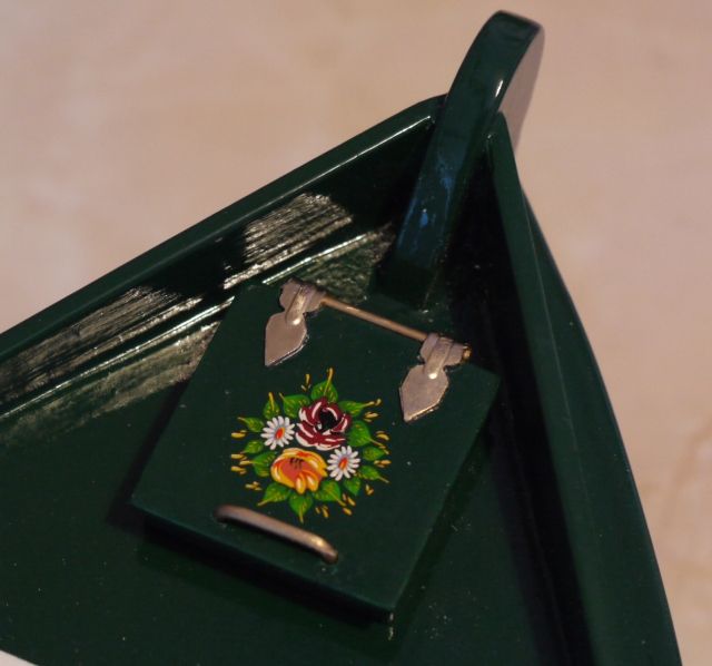

                              Front gas locker, hinges made from single brass picture hooks, see I can do a bit of metal work !.

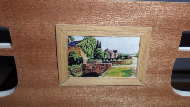

                                        I’ve got some pictures to put on the walls when the superstructure is finished, you might like this one, its a copy of an oil painting and I’ve got the OK to use it off the painter, can you guess its Bob !, thats the other string to his bow!

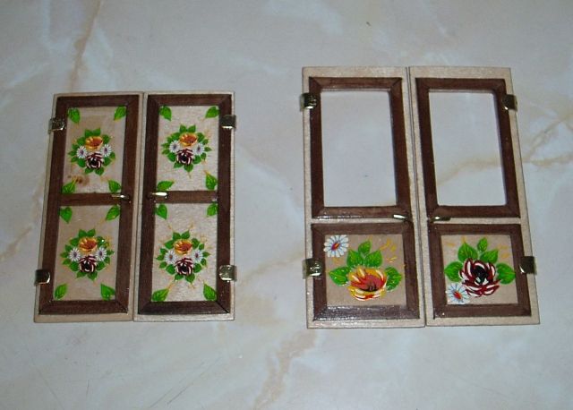

                                        The doors of the boat are as follows

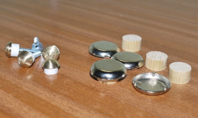

                                        I’ve come up with two idea’s for the roof vents
                                        On the right they are furniture sliders with wooden dowel and the smaller ones on the left are brass mirror screws with plastic dowel collars underneath, will decide when the roofs on and tried them with the flower planters between.

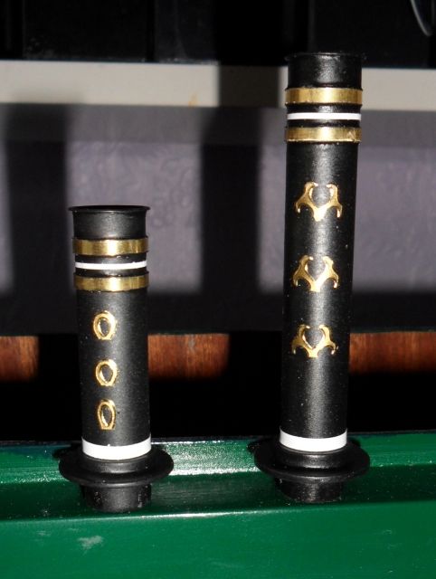

                                              On Saturday got an e-mail of Bob to say that the smaller chimney he had made was ready to be collected, can’t complain about that service can you, 24hrs and already to pick up.
                                              Bob said bring the large chimney round as he thought it would be better with the lower collar slightly raised so it could be set into the roof and make it firmer so it couldn’t be knocked off so easily.
                                              As this one clearly shows.
                                              So here are both chimneys, finished and painted, had to re-paint the bigger one of course as soldering the flange on higher meant the paint had to be removed on that one, still no big deal and certainly worth it to get such a pair of beauties
